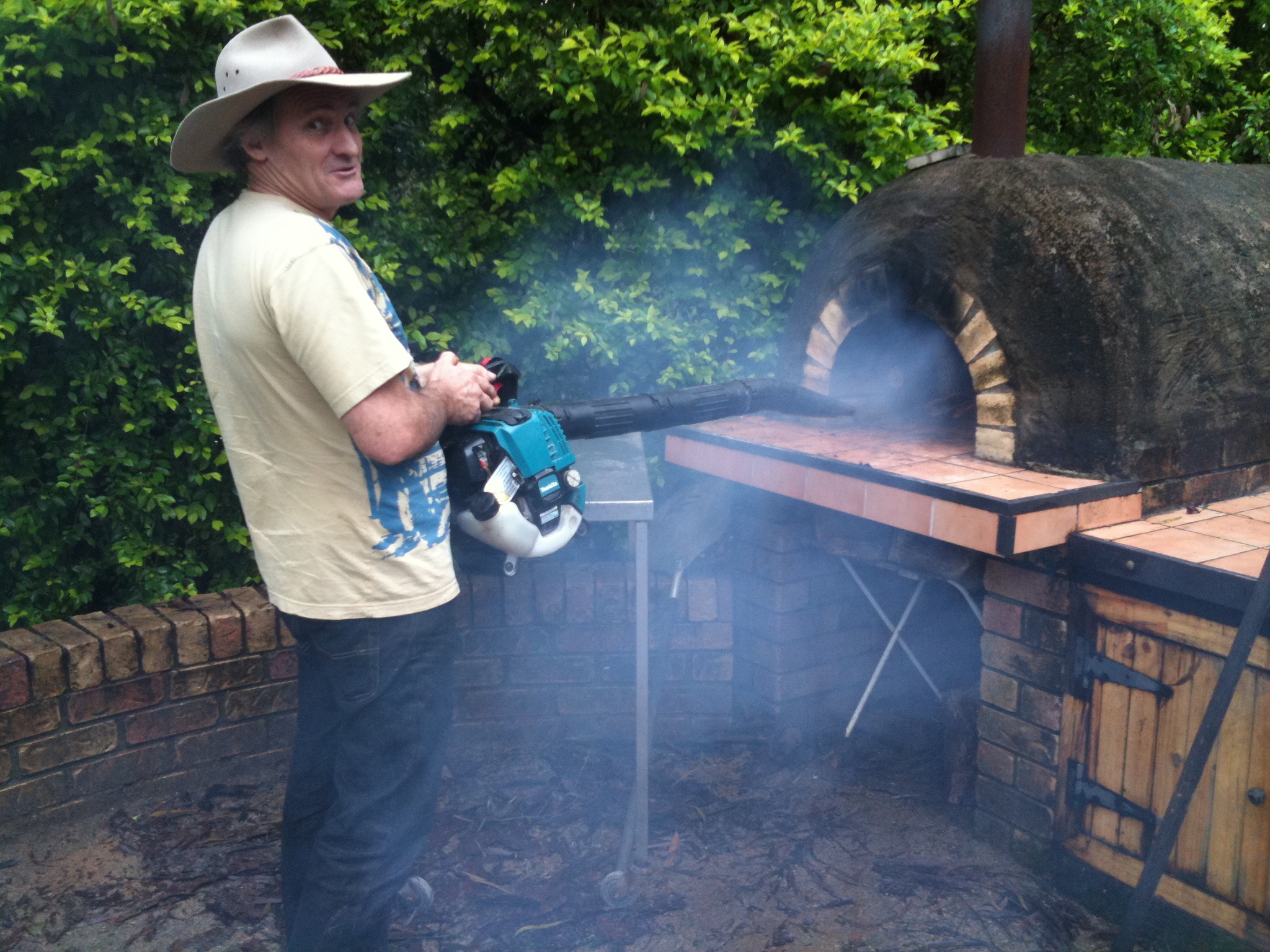

              Went to a mates place tue he inherited a wfo, barrel type, when he brought his house. It was raining all day....wet oven .....wet wood...and in 6 hours and we had to get this oven pumping out pizzas. a bit uncoventionable but what the heck it worked.

                    i started the oven over new year weekend with a big propane torch now that was neat and started fast also saw that blower in the oven too now i going to give that a go too.
                    now about the inherited wfo, would'nt that be easy and all you have to do is fire it up and join the forum ,ha!
                    is he going to do anything else to it or is the wfo complete?

                      Gordon my mate got the oven with the house, its a barrel oven rather than a dome built with firebrick and as far as I can tell has insulation on the roof only. Strange thing is that the chimney is located in the oven itself losses great amount of heat up that. I talked him in to putting a tile on the chimney from flash up and his wood consumption and time to cook has gone down. The problem now is that he needs a chimney external to the oven as you always end up with a face full of smoke, the problem with thsat is if you place something else in the front it is a long way to the back of the oven being a long barrel not a dome. I feel so lucky I built a forno dome oven ...I tell you... ya follow the instruction you cant go wrong the things are tried and tested
