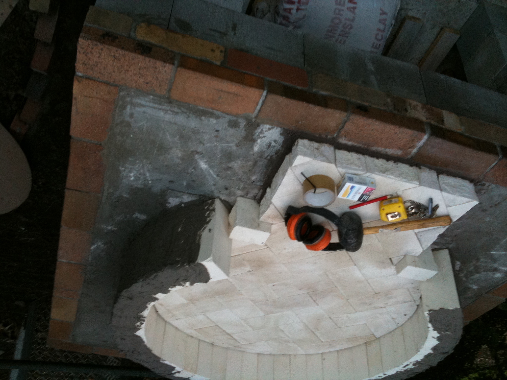

                          Gudday lancer
                          Sometimes you have to look and think at things a bit different
                          You don't have to build the hearth inside the dome
                          You build the hearth first get it to shape ... Then build the dome outside the h earth. Use some cardboard on the outer edge of the hearth to get you 5mm gap, stops dropped mortar from filling it up, burns out later. That gap will fill in with ash.
                          I know I built with a soldier course course the 8 in part of the brick up.
                          But Lay the brick floor on the 3 in side up.
                          Then start your dome with the bricks laid on the 4 in side up so you have no mortar gap at floor level to take out with your peel.
