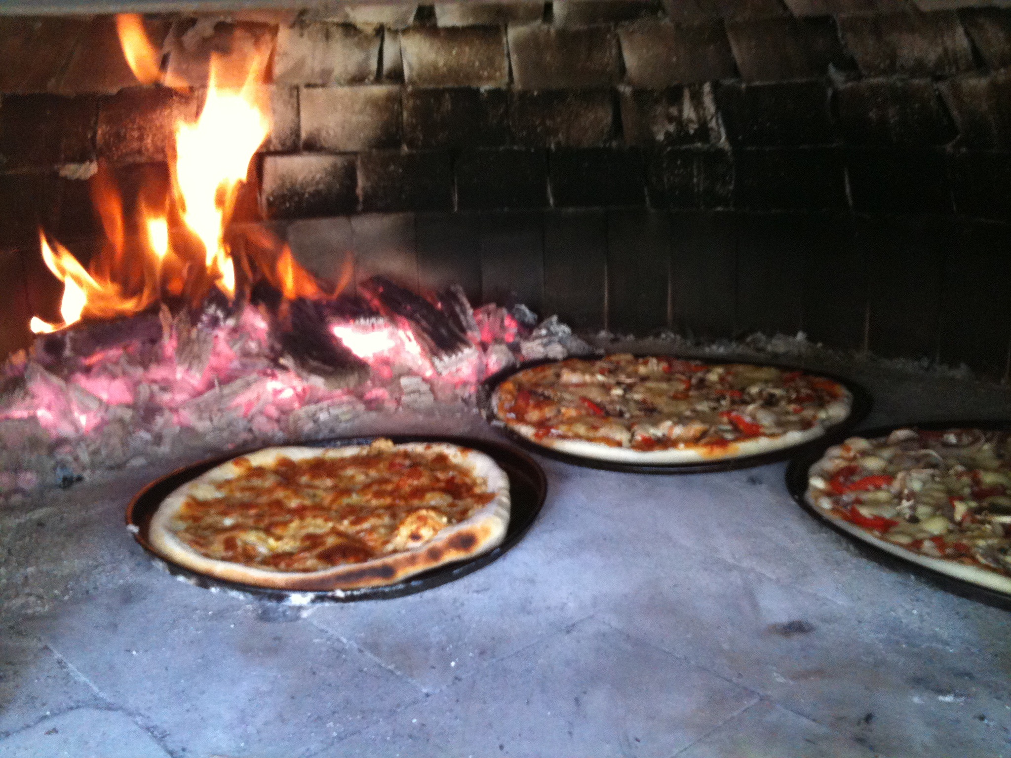

                              I read you thoughts on building another smaller oven to cook pizza for a family business , not a bad idea. From what I've found most commercial WFO for pizza seem to be 40 ins. Need more ... Build a secound oven. And 40 ins its possible to do the 3 pizza thing, ( I do it badly) stick to low dome!
                              Sorry this is a very old pic( and the pizza is on trays! ) but you get the picture.
                              What people would your market be? A tourist market would be a lot different from that of the local. But what the heck!cater for both!

                                You guys are killin me with the glorious pizza pics mate! Yes the dome is lower than planned with no soldier course at all (You have a soldier course in your pic) and brick floor raised 2" into the oven. If the cheese doesn't toast the oven will be big nuf to climb in, chip out the floor, pour a few inches of insulation and lay the floor again. So, its wait and see how the monster cooks and enjoy some glorious pizzas in the process. We'll post some pizza pics too!
                                Once the oven build is done we'll figure the scale of the onion, but I've begun realizing that it won't be too much of a monster. Won't be this big certainly although the chimney will come out taller than this pointy bit they have here.
