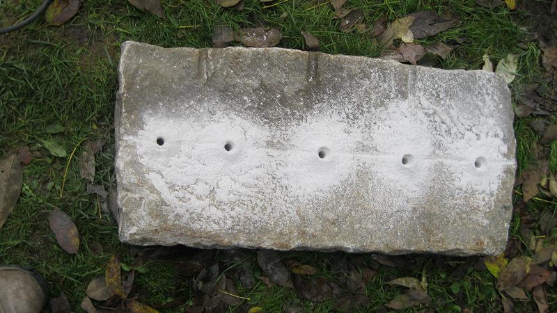

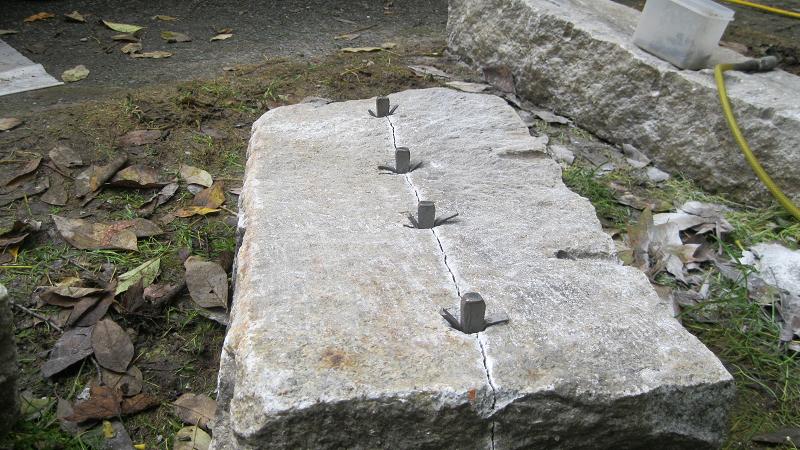

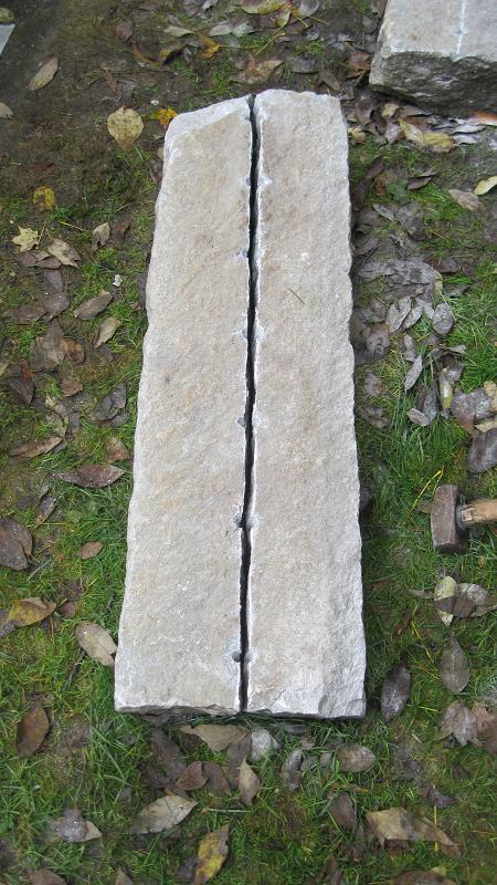

        Re: Lancer's Philippine Build, Close to Australia Anyhoo...
        Drill a series of holes, insert some dry sticks, add water, wait.
        The sticks will expand and crack the rocks.
        If the limestone is very dense this technique won't really work well....but not a bad suggestion, very early technique.
        Lancer, I don't know if you can get Feathers and Wedges where you are, but you can make your own if need be....3/4" ( 19 mm?) re-bar or round steel stock for the wedges and steel shims (or round stock cut in half ) for the feathers will work. Here is a sequence using F/W splitting some granite I used for chimney cap supports....

        F/W work on the same principle as the method Brickie described, but the shear forces are much,much greater. I split stone with them regularly and describe how on my blog...pm me if you want the link. It is still employed by stone quarries around the world..and it's a blast to do too.
