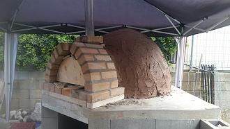

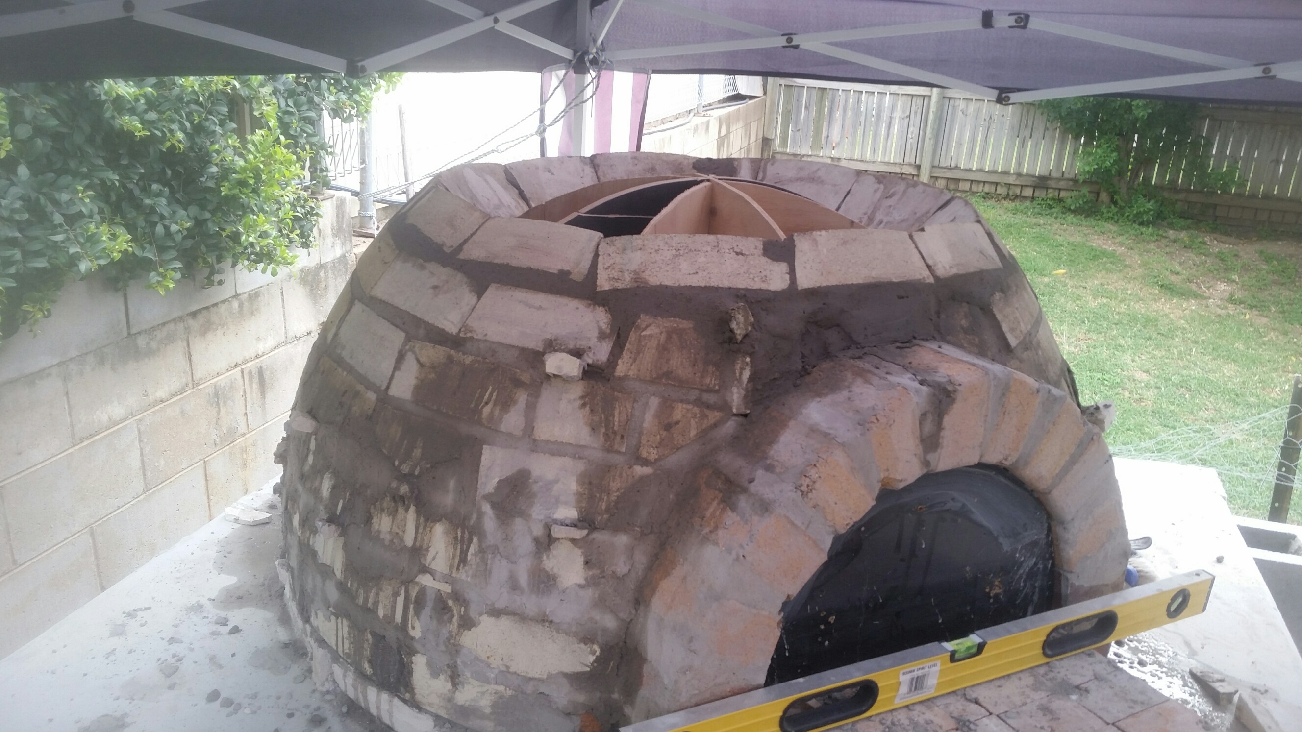

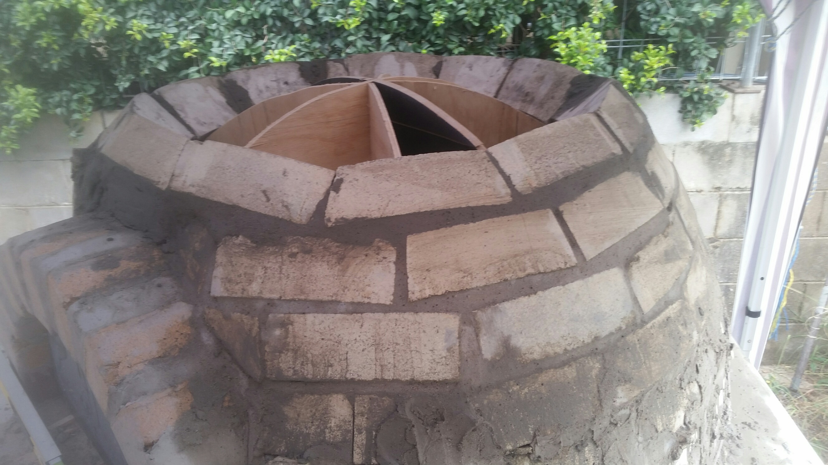

    Arch cleared. Bit nervous about laying the bricks now...but going ok Click image for larger version
ID:	397131Click image for larger version
    • #32
      You will find it easier if you cut the bricks in half now the angles are getting tighter.
ID:	397237Click image for larger version

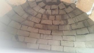

ID:	397238 2 courses and keystone to go. Thanks for the suggestion david, the half bricks were easier. Getting there...hopefully finish the dome tuesday and Wednesday

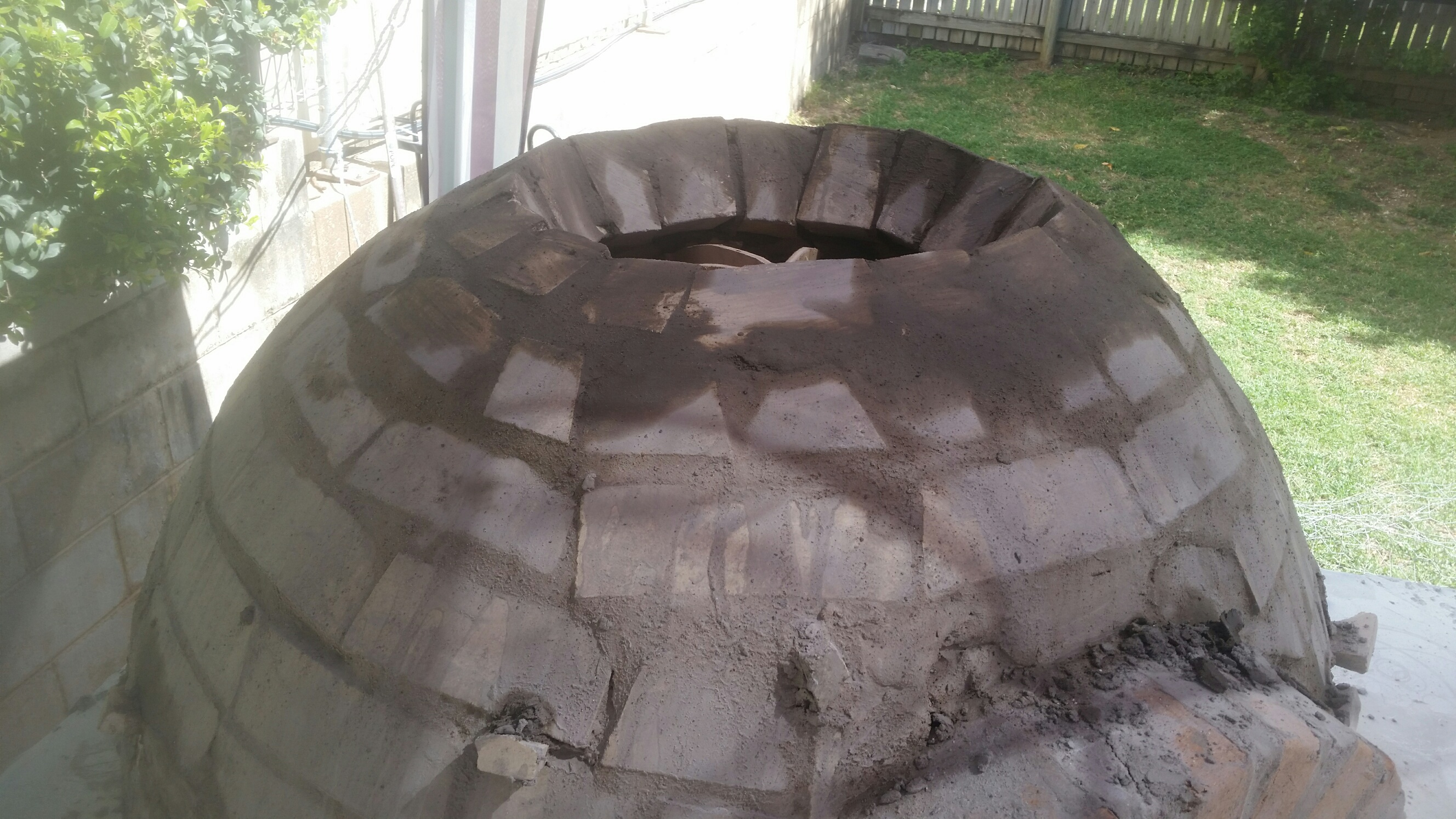

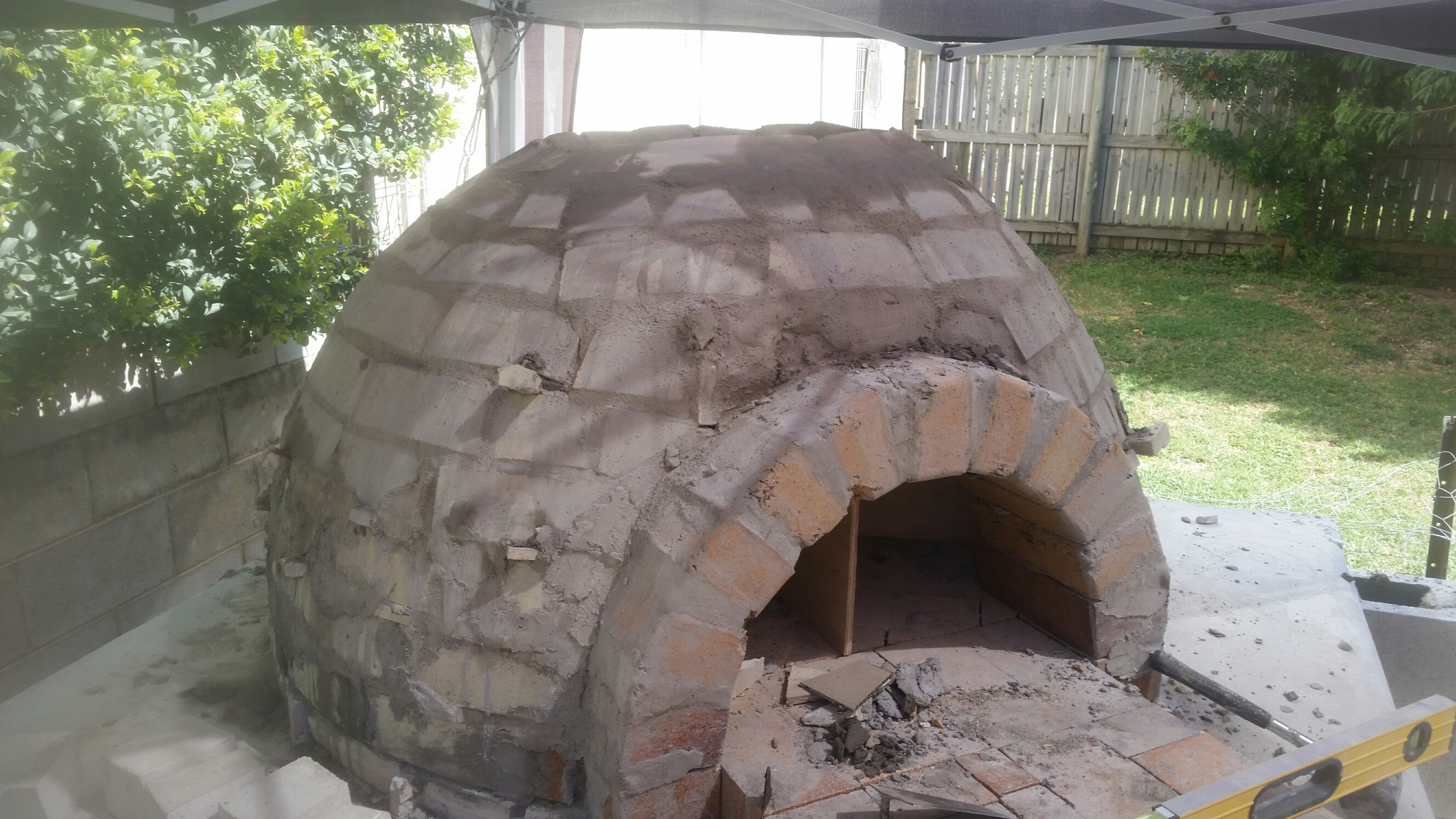

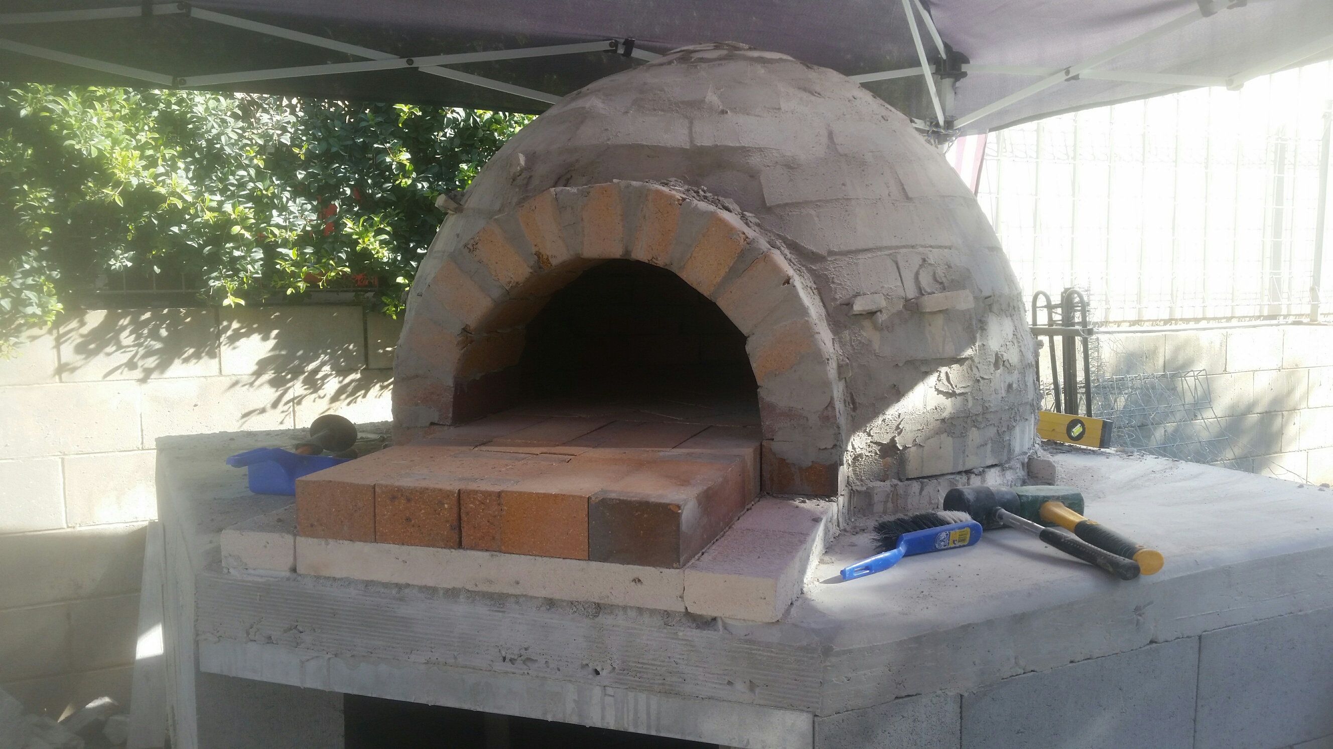

        • #34

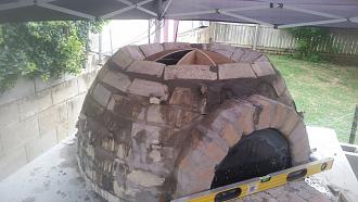

          Dome complete,although not perfect, it is still standing. Click image for larger version
ID:	397453Click image for larger version
ID:	397454Click image for larger version
          • #35
            Its a nice feeling to close the dome

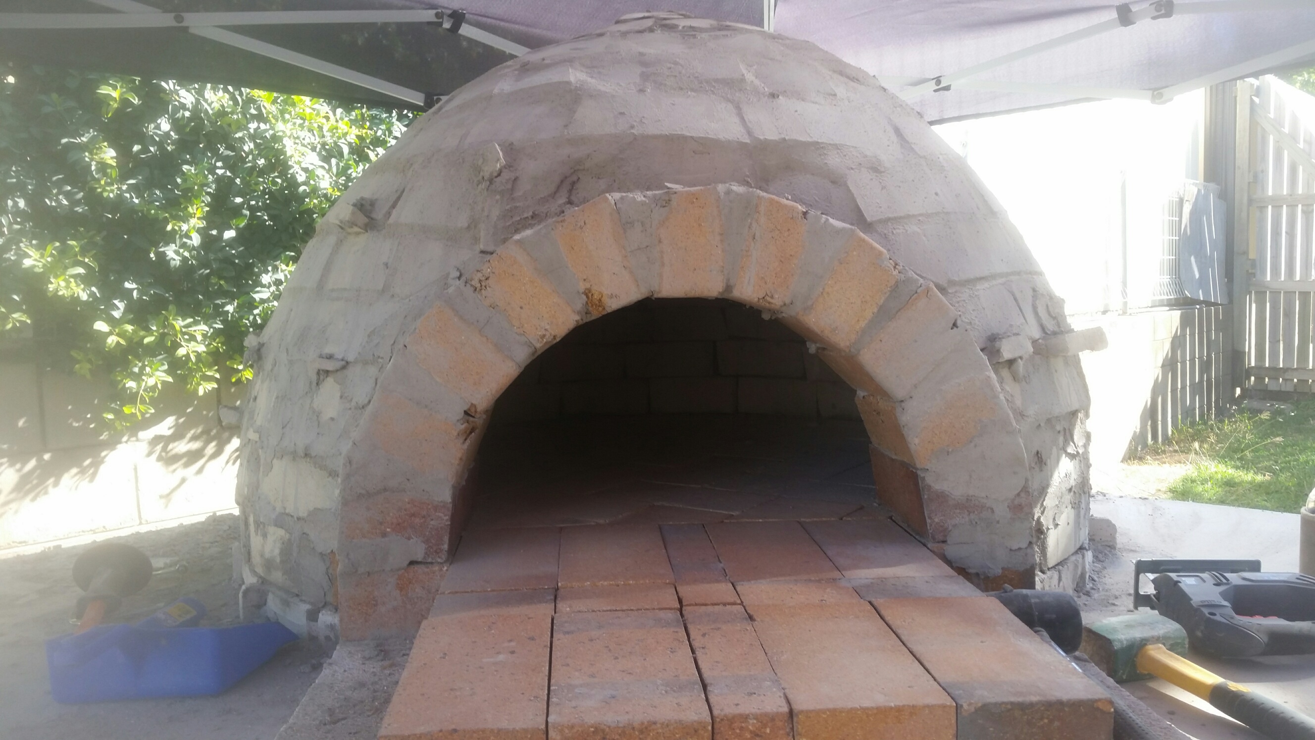

              I am hoping to start the outer arch in the next few days, do the bricks need to be fire bricks? Or can I just go for something I like the look of? Any help would be appreciated. And you're right steady, closing the dome is a great feeling
              • #37
                hi
                i used fire bricks through the landing and my decorative arch i used whatever make the front look nice . In my case same bricks as the house.
                I dont see any reason though that you could not use normal bricks through the landing.
                Cheers Colin
                Oven 1 Completed
                Oven 1 and surrounds
                • #38
                  Gday
                  firebricks are not waterresistant at all and will absorb water at a great rate. House bricks are by nature water resistant and are in my opinion better suited for use in the entrance /chimney for this Reason.

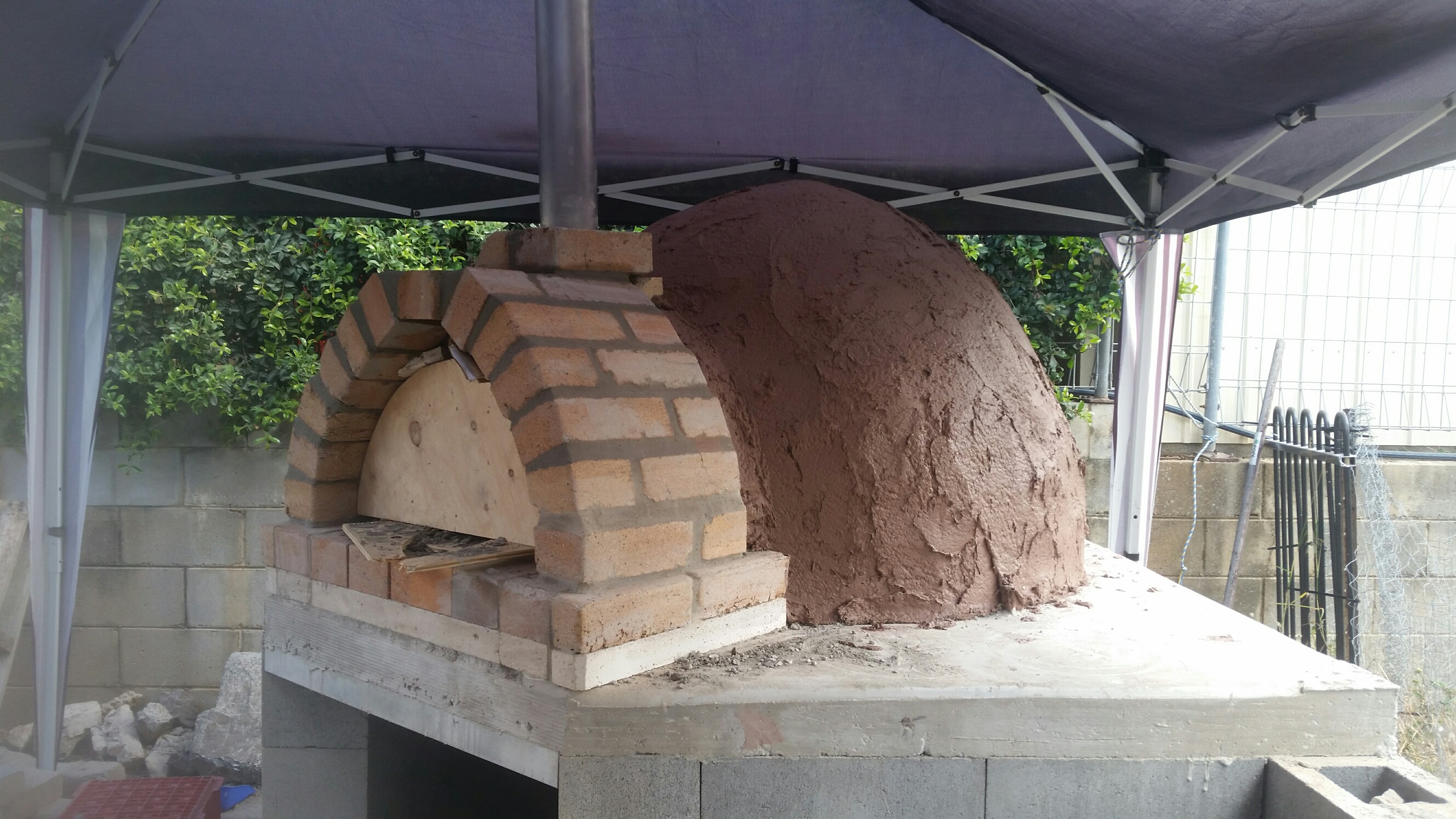

                    Well I'm pretty close, bit of curing and a coat of render to go. Thanks for advice, much appreciated Click image for larger version

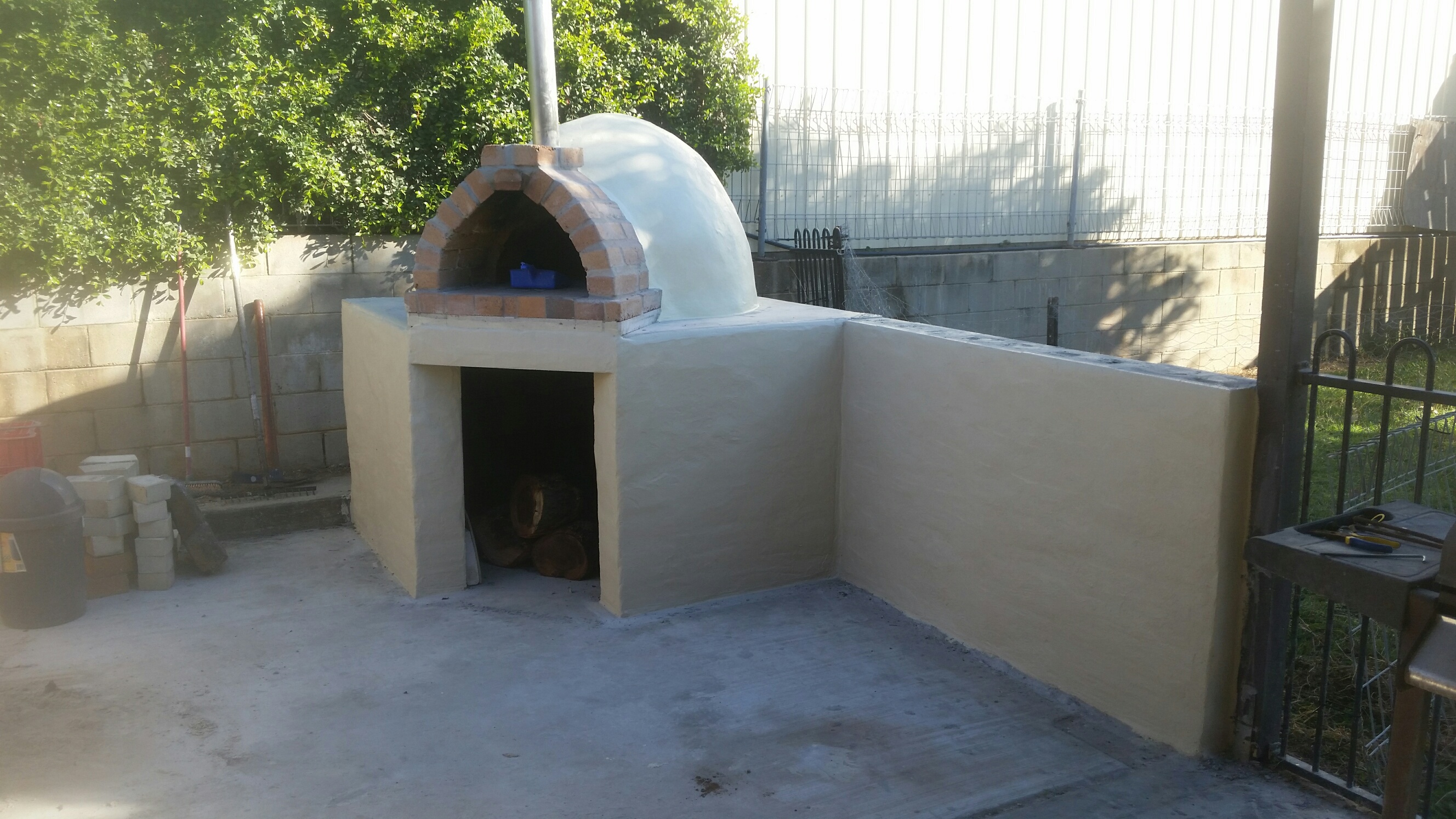

                      rendered and painted...going to do some tiling to pretty it up but pretty much finished Click image for larger version
