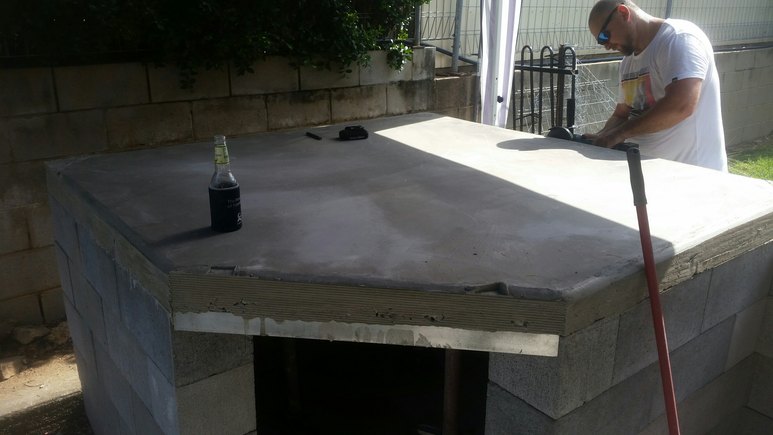

          #19
          I've got the foundation done. Up to framing for the slab....I,'m not sure where to start on this

              #21
              slab done....now to start some brick work....

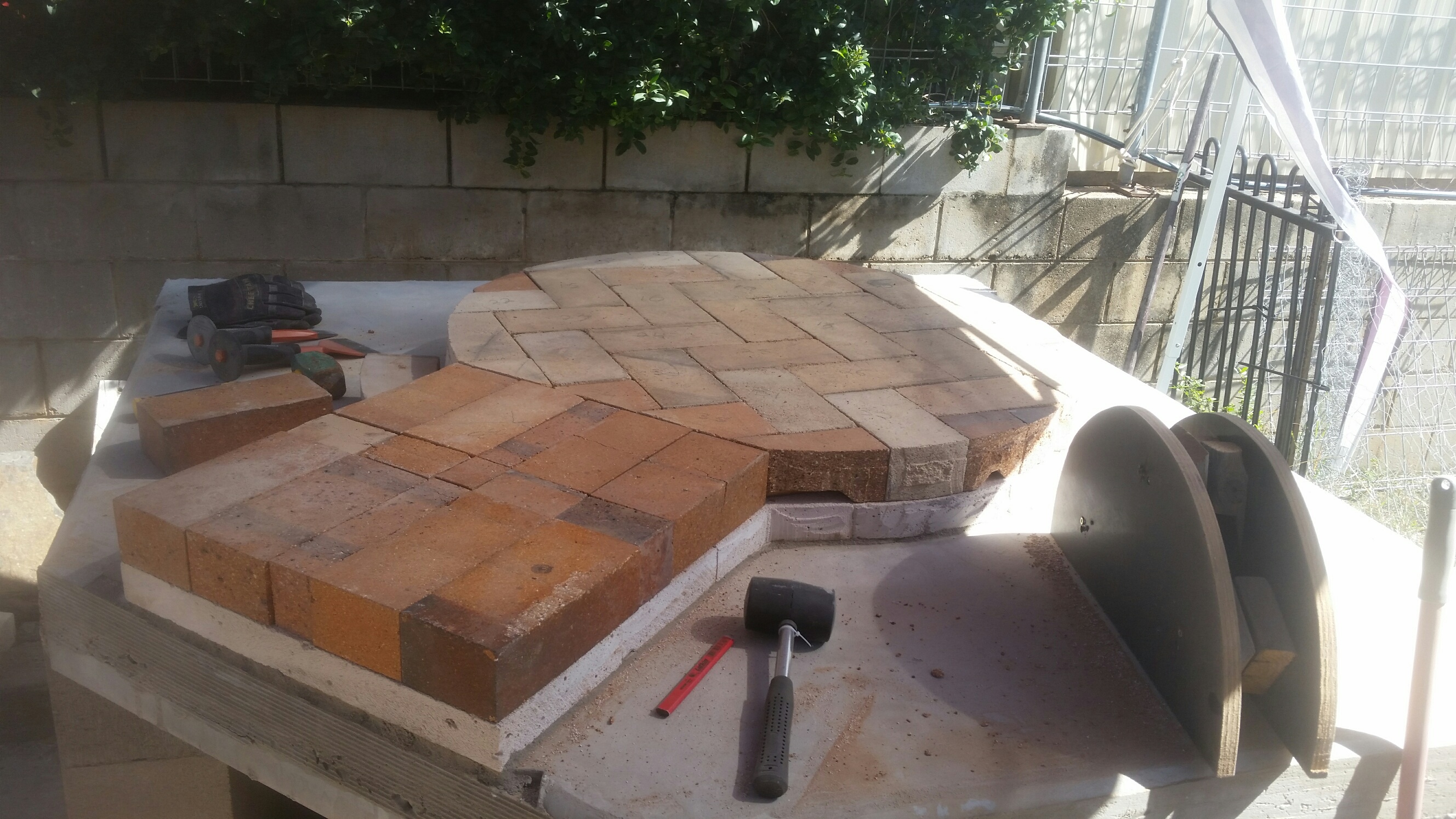

                      #25

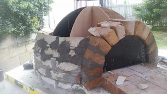

                      So I've made a start...first time I've layed (laid?) A brick. It shows. All the brick cutting is done with a grinder...and that shows too...but I'm hoping it won't fall down. Any suggestions /criticism would be appreciated Click image for larger version

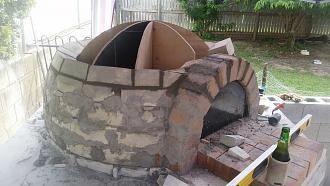

                        A few pics on the progress Click image for larger version

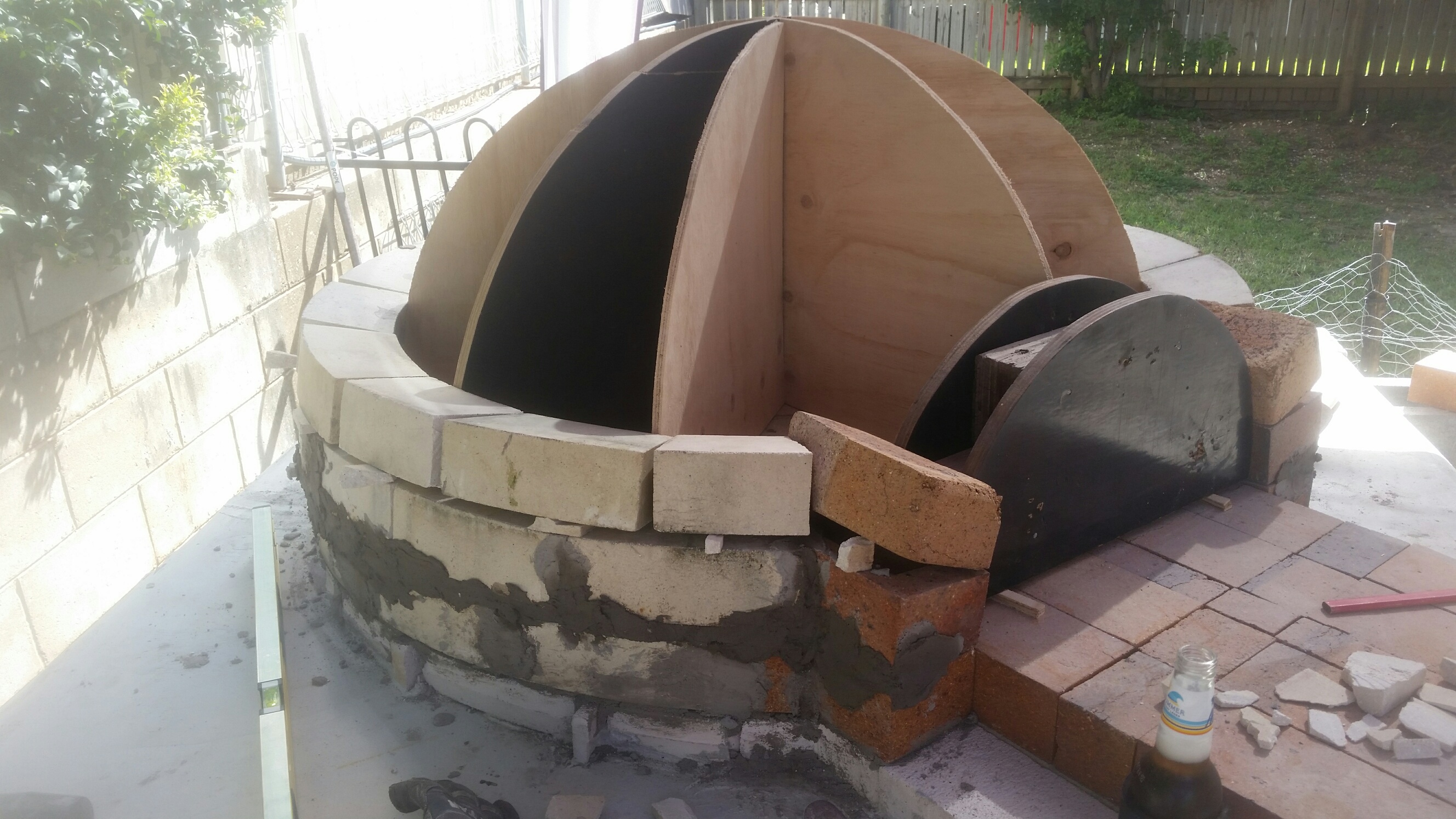

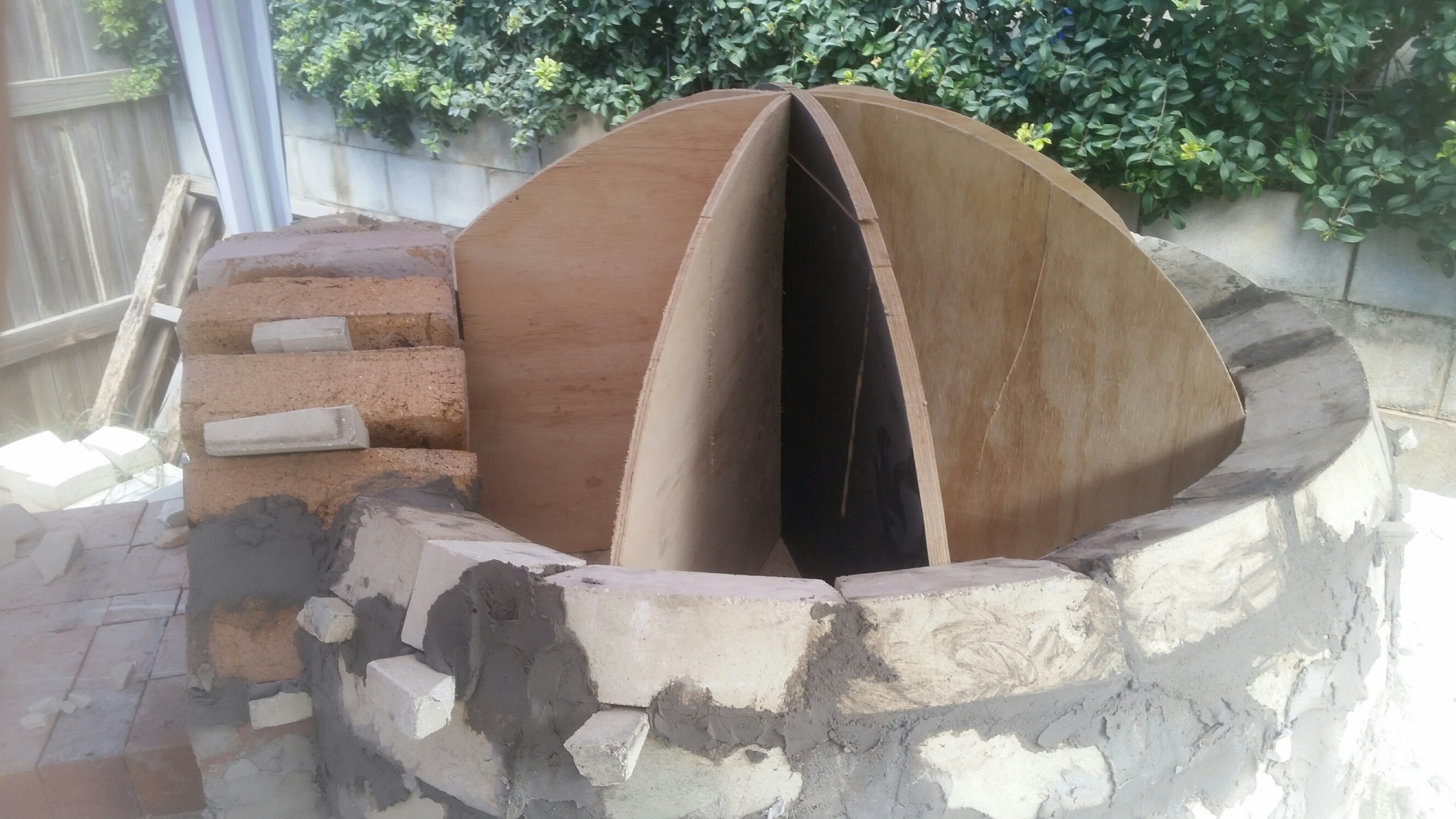

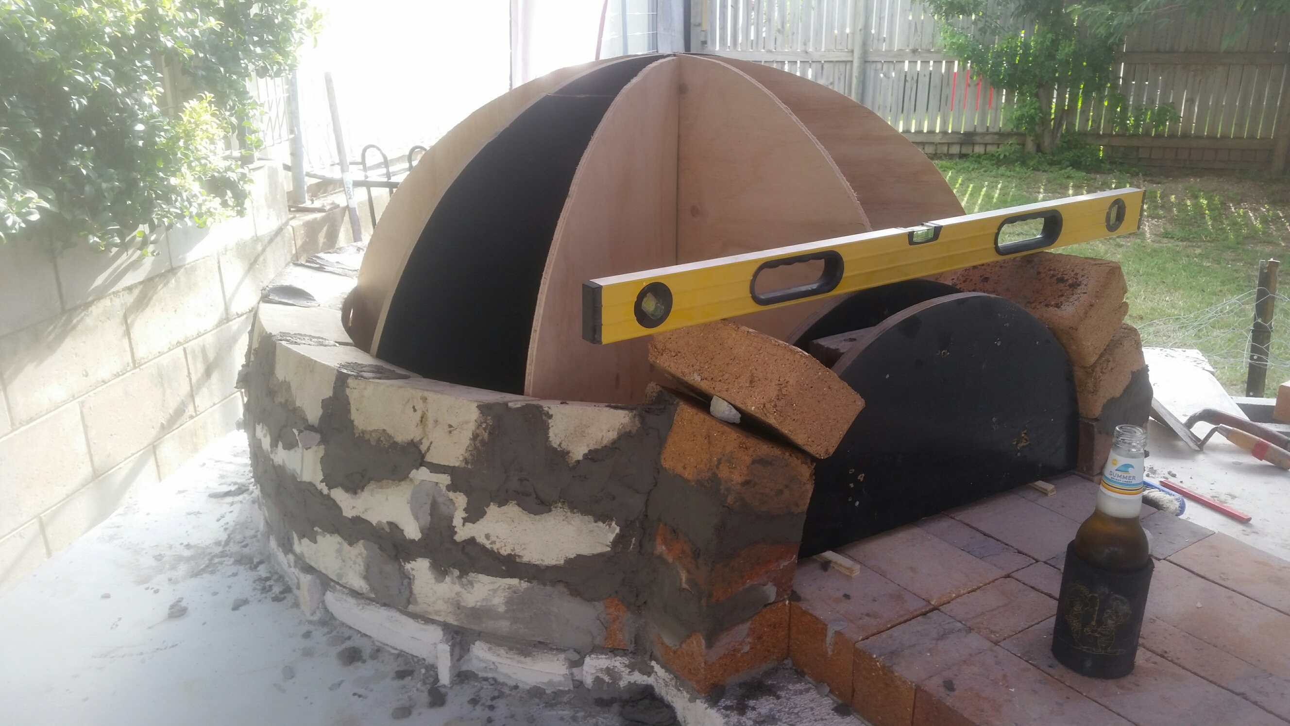

                          #27
ID:	396866Click image for larger version
ID:	396867Click image for larger version
ID:	396868 having a little trouble putting pics up...but this is where I'm at

                            I'm excited to see you use those curved bricks! I think you are on the right track pb, and it looks good too.

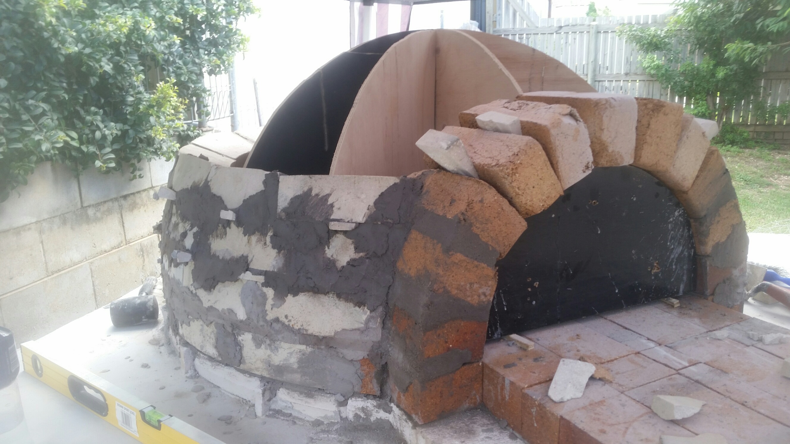

                              #29

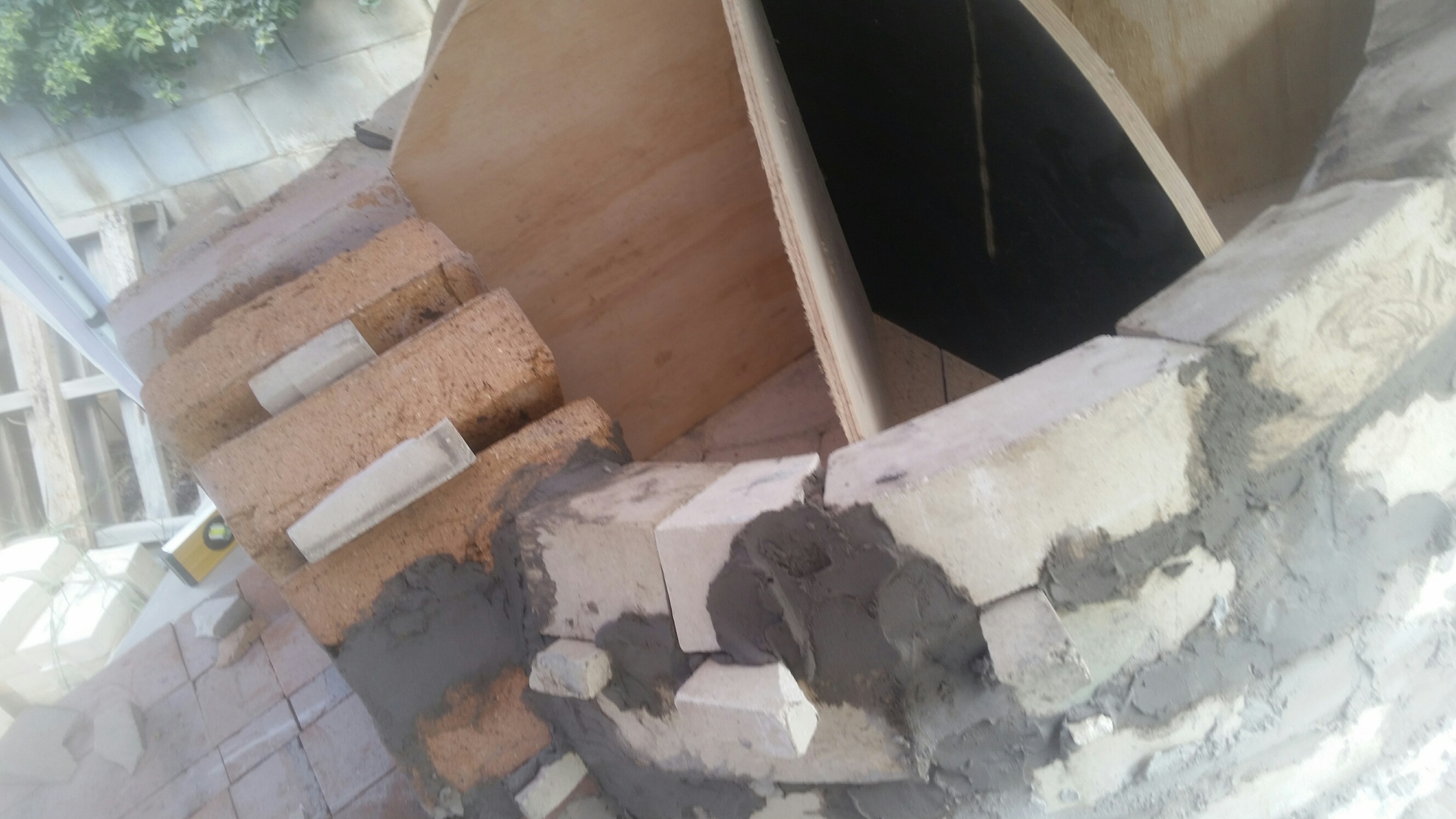

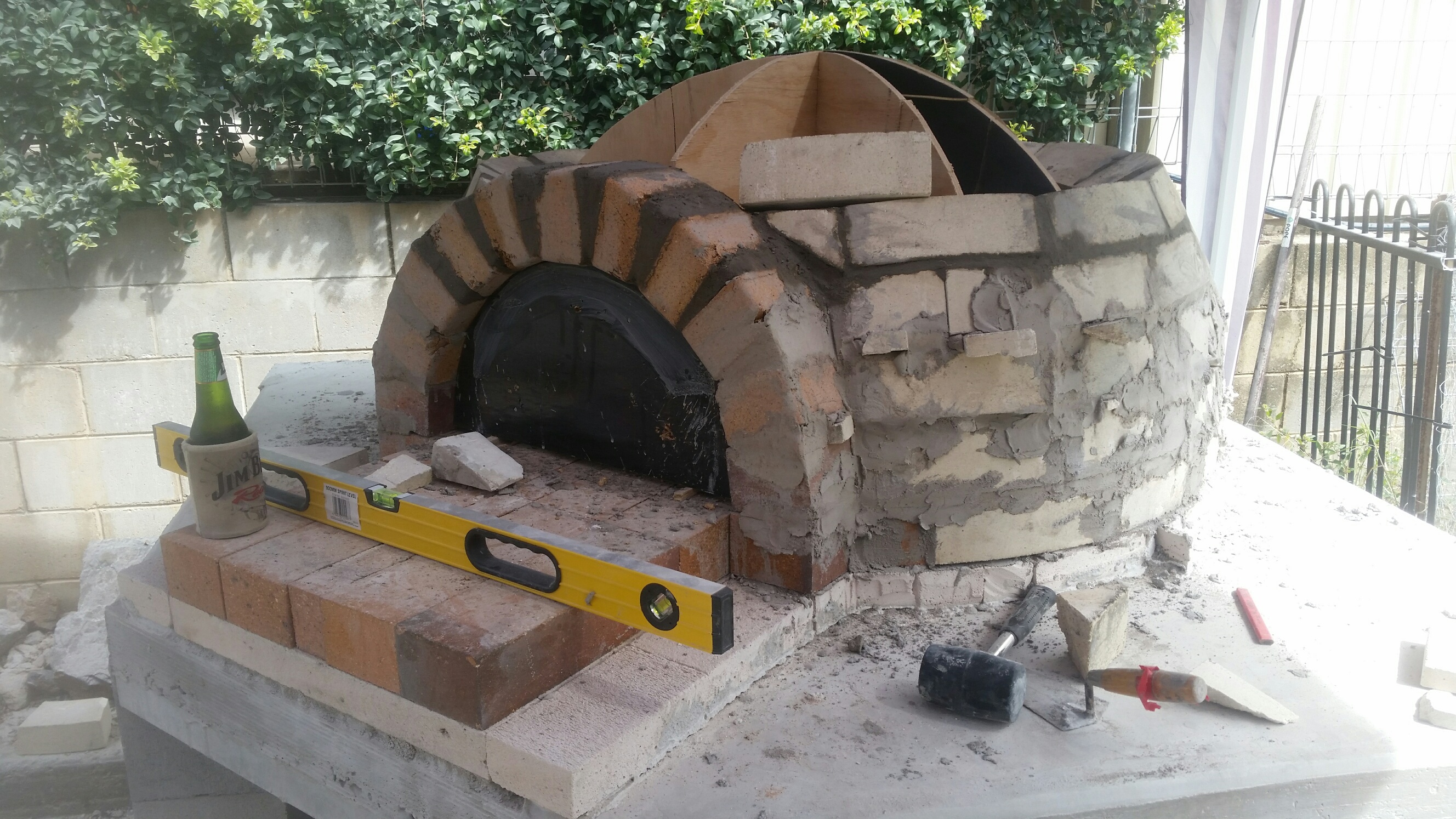

ID:	396912 next course should clear the arch Click image for larger version

                                looking good
