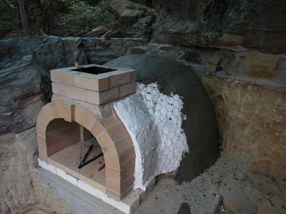

      That weekend it was wet on Saturday. I had planned to wrap the insulation that day but didn't want to get it wet. So it was at that point that I decided I should put a coat of render over the oven. I wasn't going to as I am going to enclose it, but in the meantime the blanket would get wet when it rained and those nasty fibers from the blanket would be floating around.
      Thankfully it was fine on Sunday and I made an early start, wrapped the blanket and applied 2 coats of render. This needed to be done in a day because we had friends and family coming from near and far all over the following Easter weekend, and I wouldn?t get a chance to do anything during the week.
      With the blanket and render on the oven looks huge. There really is not a lot of room to work around most of the oven which made applying 2 coats in a day a physically demanding job. It would have helped if I was a left-handed contortionist. Below is the first coat finished.
      And here it is completed. It came out looking ok considering I was not that worried about the finish as it will be enclosed. While I was applying the render my wife was mixing it. She was also cleaning up all the tools and brick off cuts and dust. We also put a temporary bench beside the oven.
