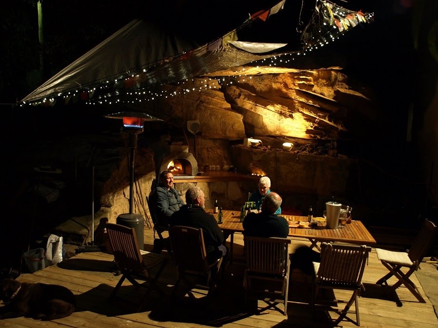

                          It's been quite a while since I have worked on the pizza oven. It gets a lot of use but I have had a lot on my plate lately. Anyway, I decided to get things moving and get the area finished, so this should be the first of several updates.
                          The first serious project was to put something over the dirt floor. As all materials have to be carried by hand I decided to build a timber deck on the ground. Also, there is enough rock, so paving would have been too much. Because we live in the bush and have termites the best option was to build with H4 treated pine.
                          I spent 4 or 5 weekends back on the jackhammer levelling the area. A lot of it is on solid rock so it was hard going (as usual). I built a bit of fall into the entire area so that water will run away. When I built the rock stairs (about 5 years ago) I built some fall into them too.
                          The structure is 4x2 H4 treated pine sitting on the ground with 6x2 boards used for the decking. The top edges of the boards were chamfered.

                            I had a team of helpers. We got enough of the deck completed on the Saturday to use it that night.
                            We finished it off the next day and then the following week we gave it a bit of a sand and a coat of oil. I think it looks pretty good and it is a huge improvement.

                              #89
                              Re: Building Between a Rock and a Hard Place
                              Sharkey it looks awesome! Love the space and the lighting as well glowing on the rock.
