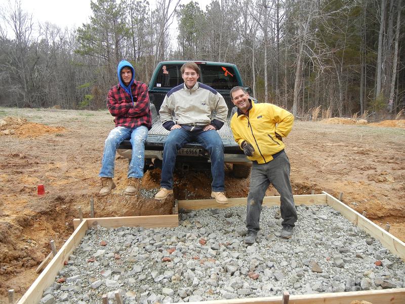

    I thought I would share some photos of my progress, as today we are being snowed in with only generator power and plenty of time on my hands.
    Thanks for the forum members and all the great tips. I sincerely appreciate those that offer so much of their time in the service of helping others enjoy great pizza.
    I started this project to get the kids outside and learning to create something with their own hands instead of becoming nintendo superstars. (Although I am grateful to have a couple of big strong boys to help with the concrete).
    As soon as the weather breaks and I find some insulating board, I will be ready to start the dome. yippee!!!!!!
Name:	nice to have a friend with a tractor.JPG
Name:	forms for foundation1.JPG
Name:	ready for rebar.JPG

        Re: 42" build in Virginia
        I ended a renting a mixer to help with the foundation pour. I almost bought a cheap one from Harbor freight but decided to just let the big boys get some exercise when we did the hearth.
        For those looking for materials in Central Virginia, I found most of what I have used so far at Lowes for the concrete bags, but the brick, block and mortar was less expensive at the masonry supplier Shade and Wise.

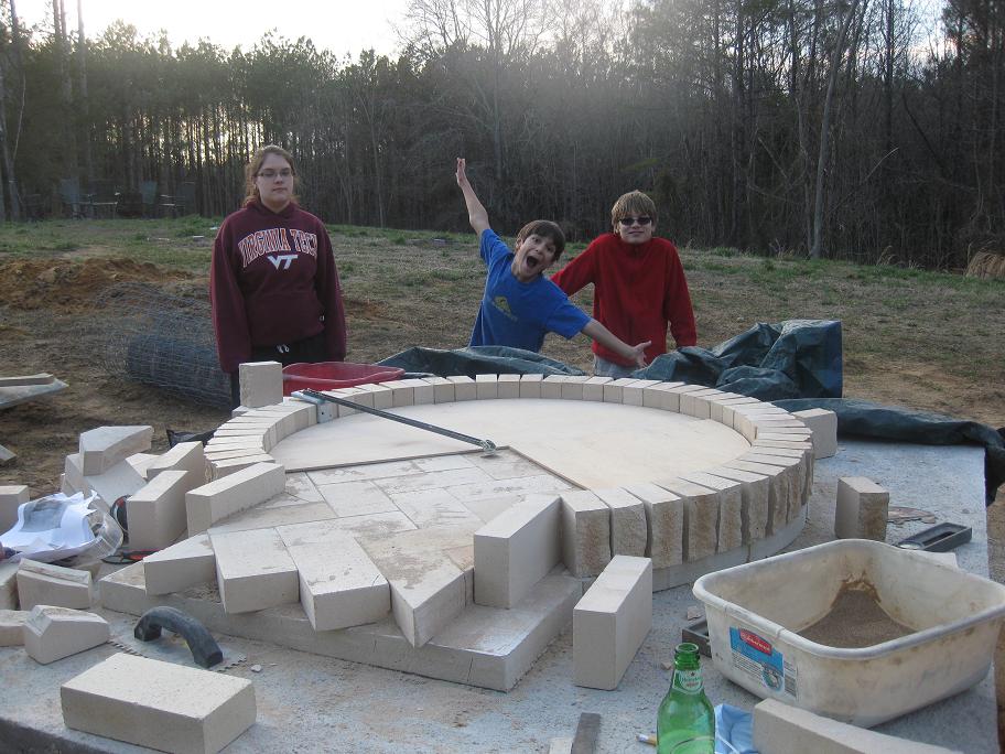

              Who the hell wanted to build a damn pizza oven anyway?:ad:
              My camera is destroyed with brick dust, my sinuses are clogged and my eyes are weaping......that's with all the proper eye and respirator wear.............................................. .I Love It:
              OK. I am using my daughters 3g camera, but pics no the less. At least I still have all my fingers.
Name:	va tech 1st course.jpg
Name:	first course.jpg
                  Some progress shots. Notice I have switched from Yeungling to Red Hook.............It was on sale
Name:	fourth course.jpg
ID:	293495;Click image for larger version
Name:	setting the angle.jpg
ID:	293496;Click image for larger version
Name:	dont look at the red hook beer.jpg
                  If you closely at the courses, some of the bricks dont line up the best. I have started adding a 1/2 brick to keep the courses offset. Is that OK?
                  thanks again for all the help.
                  • #10
                    Nice use of snap headers, I dont know why more ppl dont use them, nice tight joints too.
                    Just a tip, start from the back of the oven overlapping the bricks by half, that way all the fiddly little bits will be out of view against the arch at the front.
                        Originally posted by Bacterium View Post
                        Al what you mean by snap headers?
                        You pick up a brick and give it a crack with a hammer, aka snap headers.

                          • #14
                            BACTERIUM, you have cut me deep. I am "fabby", not FLABBY!
                            oK, NO MORE BEER FOR ME. I am officially on a diet.
                            Dadgummit, what am I building a pizza oven for if I am already flabby.
                            Seriously, thanks for all the comments. I will start my future courses in the middle back to help the bricks to look staggered. Should I continue to use a 1/2 brick to try and keep the joints offset or does that matter?
