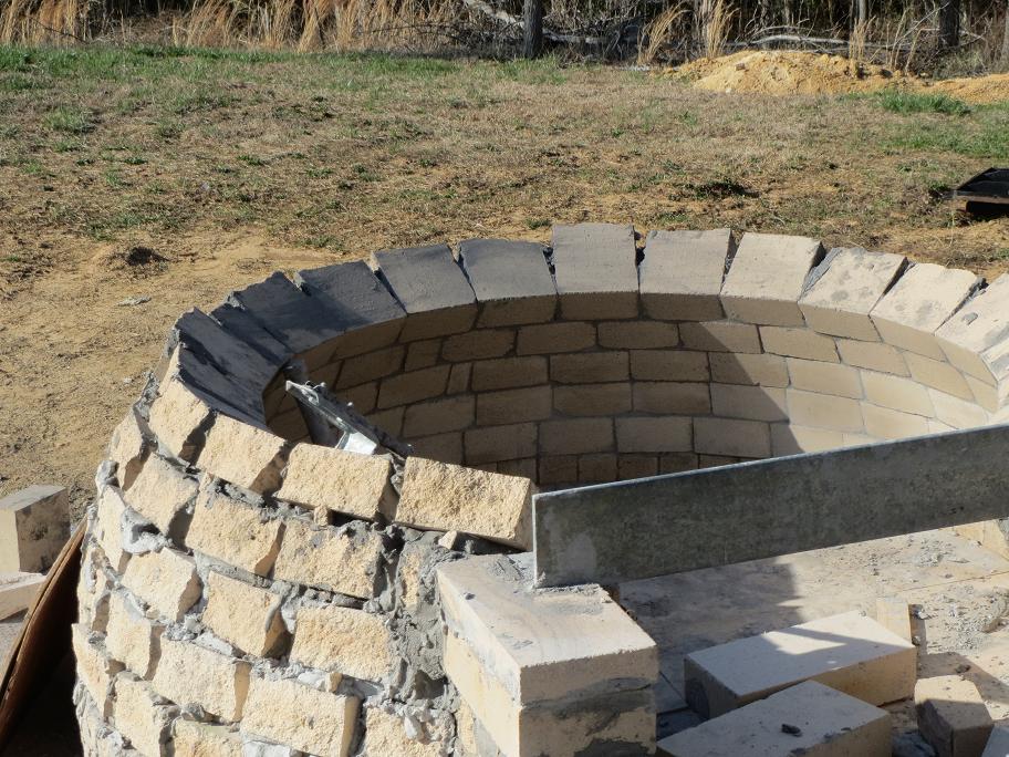

              Some pics of my progress. Another snow storm, unheard for Virginia this time of year, slowed me up. It has been cold and windy and I had brick dust in the ear canal......ouch
              I hope to have the dome done this weekend, if the kids will let me work thru their Easter egg hunt.
Name:	dome overshot progress.jpg
ID:	293591Click image for larger version
Name:	back pic of dome progrss.jpg
ID:	293592Click image for larger version
Name:	side dome progress.jpg
              I need to order my insulating blankets. ROCK AND ROLL

                          I hit it hard today, the knees are sore, the neck is cricked..........but I feel good that I was able to make some serious progress today. Finished some courses and the bricks over the opening.
                          some pictures
Name:	course 8 pan view.jpg
ID:	293611Click image for larger version
Name:	inside dome course 8.jpg
ID:	293612Click image for larger version
Name:	rear dome course 8.jpg

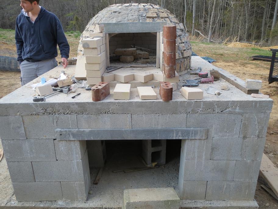

                                closing in on the dome. man, this is a lot harder than I thought. cracking bricks, keeping them from falling.............................I am on my fourth 50 lb back of refractory mortar. WTF?
Name:	course 11 overview.jpg
ID:	293625Click image for larger version
Name:	course 11 rear.jpg
ID:	293624Click image for larger version
Name:	course 11 front close up.jpg
