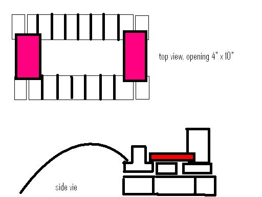

                            • #74
                              Re: 42" build in Virginia
                              I was trying to visualize how to tie in the vent and front arch. I have some half bricks that I was planning to notch the arch bricks to span the sides. Not sure if I can do this or not.
                              Does that seem like it will work?
                              • #75
                                I was planning on using some terra cota rectanglular vents to make a chimney. 9"x 12" is what they stock. Is that too big? Will terra cota hold up OK and handle the temps?
