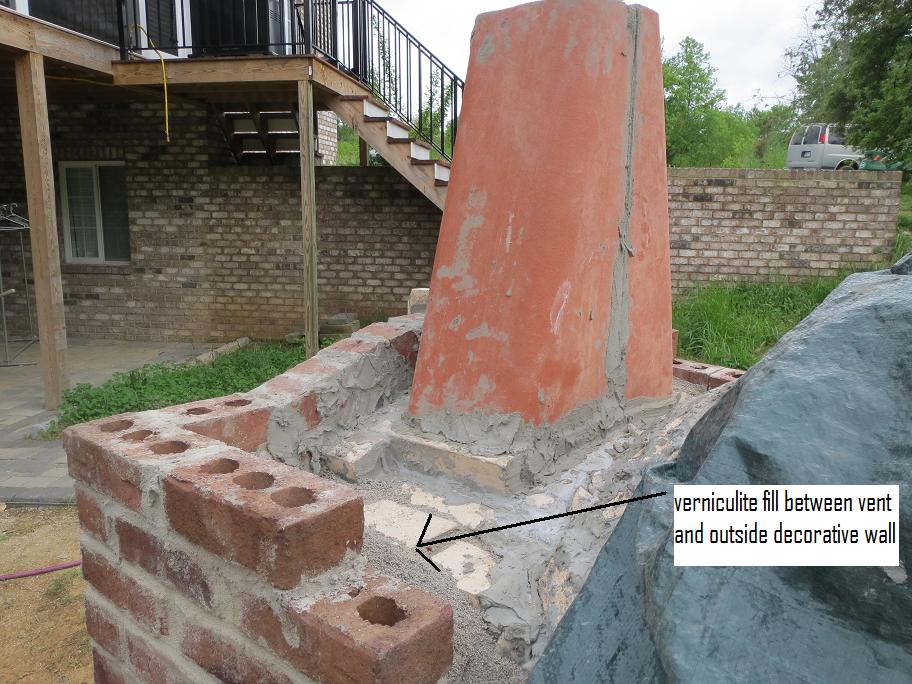

    Thanks for the info. I have since added a decorative arch and left a two inch space on the sides of the entrance, that I filled with a 5:1 vermiculite mixture. I am hoping that this sets up strong enough to buttress the archs and insulate the entry.
    I know I need to get a pic in here for you to see.
    Does vermiculite ever set up, after one day, it still seems to be crumbly.

      It takes a while (at least a week) for the vermiculite to get hard.
      The picture above is what I did to buttress my arch. I have plans for the dress up once I get it moved to it's permanent location. I did the vermiculite and the buttressing all at the same time. I will also incorporate the square concrete into the oven cover.
      Forgot to say before...It won't hurt to give some curing fires before you put on the insulation.

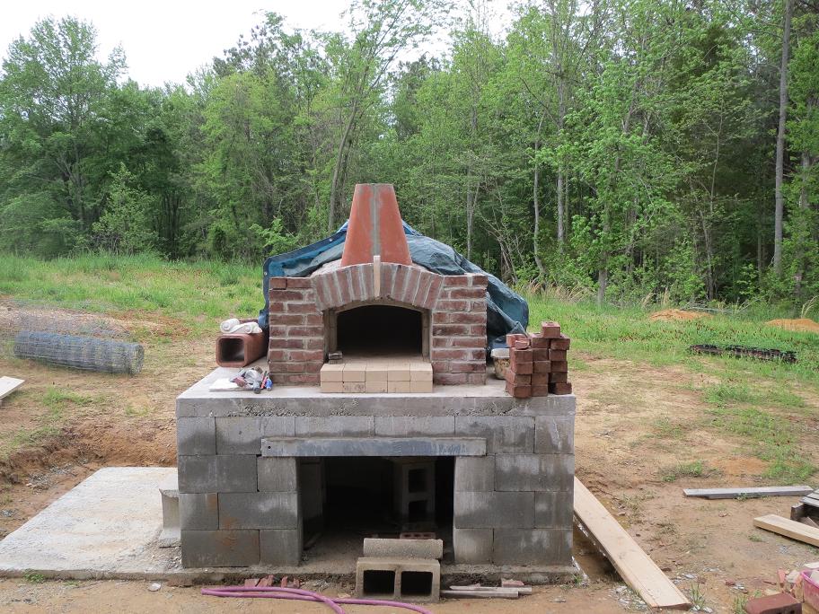

        Here are some photos of where I am at, having completed the decorative arch and filled the sides with v crete to help support/buttress the vent archs.

        As you can see, I am stumped on how to build the chimney.
        Do I start on the inner vent wall and go up, or continue up on the outside decorative wall? (Wont that look too big and wide?)
        I also had a thought of getting the next larger flue size, inserting that over the flue I already have, and just fill the space between the two with vcrete as an insulator. Any thoughts?
        • Re: 42" build in Virginia
          Stay on the outside brickwork, you could step each course in if you feel it will be too big.
          Step each side in but leave the front and back flush, as you step in go until you just cover the hole in the brick (measure each side to make them look the same).
          Step it in until you think its right and then go flush for the rest of the chimney, dont forget to make sure it works full bricks before going flush upwards as cuts in the middle of a chimney look ugly.
