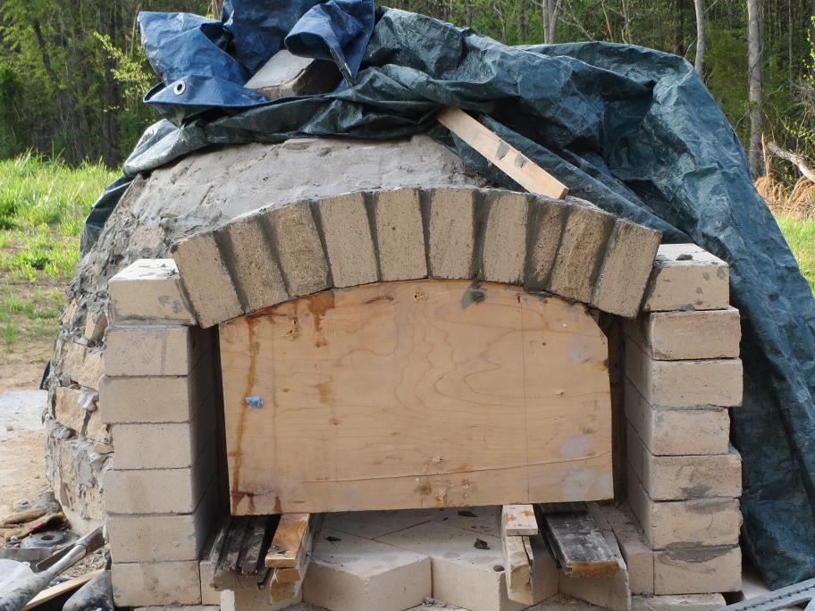

              Well, I snuck out of work early today, and was able to set up and mortar my outside arch. I did not clean the bricks up too much as I am planning on another decorative arch.

                  Flabby....., sorry couldnt help it.
                  Youll have to sort out some way to secure the half bricks that the arch is springing from, if not and one moves itll all come down.

                    Brickie, I know I need to support the archs more. I would appreciate some help.
                    I was thinking of wrapping the sides with a layer of decorative brick, and then leaving a gap between the firebrick and decorative wall and filling this with concrete. This would secure the half bricks to the decorative arch. Does that sound OK?
                    Or how would you insulate the vent on the sides? Should I leave a two inch space and fill with vermiculite and concrete mix? Is that strong enough?
                      That would secure it for sure.

                                Looking good. Be sure to buttress that arch before you put any heat to that oven. The expansion of the arch brick will give you an undesired issue.
