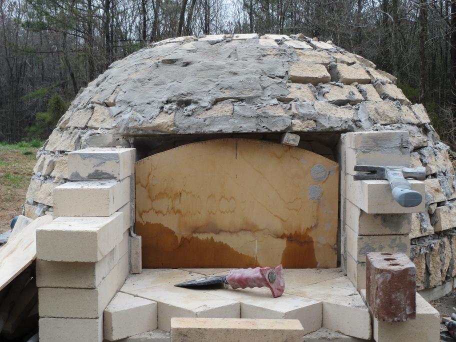

            • #36
              Re: 42" build in Virginia
              You probably need to build an arch to support the opening, also, your little reveal pieces will just fall off over time like they have now.
              • #37
                I took a pic of a cut out for the arch, with a height of 12.5". Can I build an arch that is that thin at the top, or do I need to make the opening smaller? What is the thinnist keystone I can have at the center of the arch?

                • #38
                  You could always cast the arch.
                  • #39
                    Casting would be a good idea, but you should be o.k. if you go with firebrick. Don't forget to cut your form a little less than the total height of your finished arch, then use wedges to raise up the form. When you are done with the arch,pull the wedges out, the form drops, and you have an arch.
                    • #40
                      You could try something like what I did with my firewood storage area. I built an axed arch as a decorative finish that had to fit into a square opening, and was surprised by how sturdy it was, even using voissoirs (love these brickie terms!)

                      You could do the same with the bricks on their long side. Cut to fit the square shape from the back ~2-3 inches of each brick to fit into your oven opening, but have the strong part of the arch built with the rest.
                      kind of convoluted, I hope it makes sense.

                        • #42
                          Thanks for all the tips.
                          Deejoohah, your fireplace storage looks better than my whole oven
                          I am going to remove the rest of the supports, build a better side reveal, and then try to build some sort of arch. If that gets too complicated, I do have a piece of regular steel that my brother has, (not galvanized) that I can always go back to. I am not sure I can cut my bricks with my grinder and diamond wheel to fit this space. My cuts have been crude at best

                          • #43
                            If I were to make an cast arch, is this poured out of refractory cement, or is there a refractory "mix" for strength? Would I have to pour the form in place?
                            • #44
                              I don't have experience with castable refractory (yet) but, the way I would make that arch would be to make a form on a table, then cast it as I would a concrete piece. I feel that you can control the quality better than casting in place, and less chance of damaging the piece when you remove the form.
                              • #45
                                Also, if you choose to build it from brick, why not make a template of the arch out of paper so you can make adjustments to your cuts without having to slide brick in and out of your form? Then just lay the template down and dry lay your brick to fit...once that is done you can mortar it all together.
