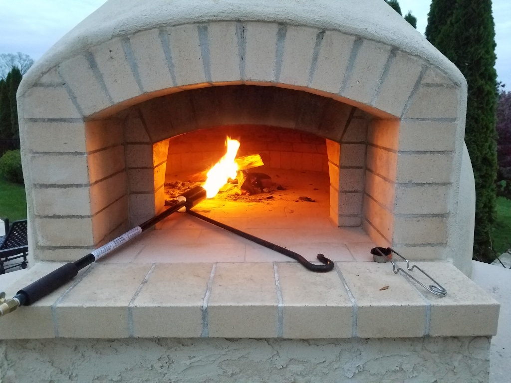

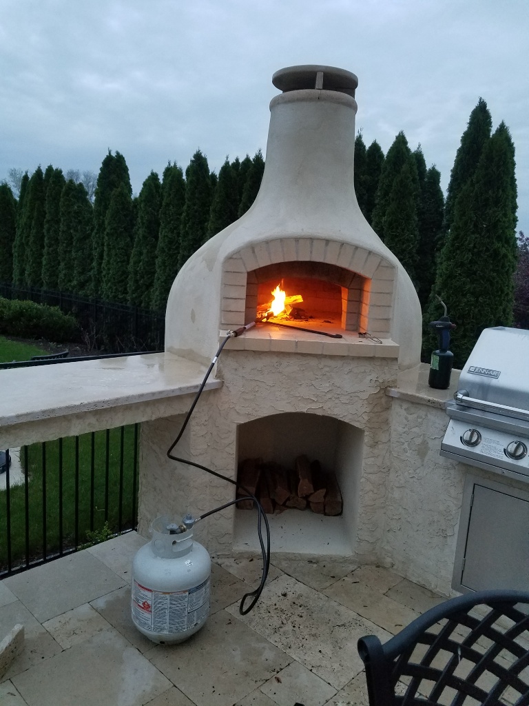

For sure there's some water....everything soaks water out of the air over time. Another bigger fire this morning, another tonight and so on until it full hot Saturday evening
Will an oven fit....looks like yes! PA build
I agree with David, better to be the tortoise than the hare. This is the point where we see a lot of builder fire too fast too hot and end up cracking their ovens. When water sublimates to steam, the volume increases up to 1500 times, this will cause internal pressure between the brick dome and the stucco coat. Too much pressure and the dome cracks this is why we advocate some type of vent in the apex of the dome. It is a fairly aggressive curing schedule.Comment
Good luck, just giving you feedback from the dozen or perhaps hundreds of builds we have watched or advised on over the years.Comment
