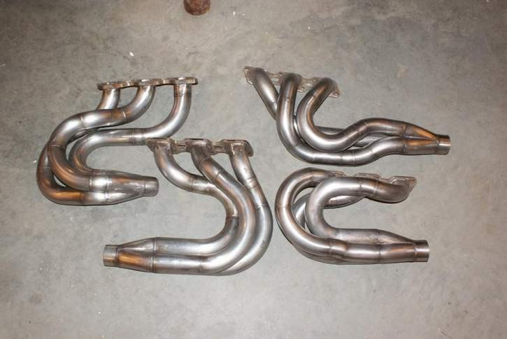

                          thanks...I've had some practice over the years. here's the last SS job I did, headers for my V12 ferrari, formerly the frankenferrari but increasing known as the project from h_ll in my house.
                          https://www.roadandtrack.com/car-cul...-308-v12-swap/
                          Click image for larger version  Name:	2009-12-14%2520004.jpg Views:	0 Size:	59.2 KB ID:	418376

                            mike, umm, I am impressed that you did this conversion let alone own a Ferrari.
                            • #89
                              mostly did the conversion....like everything else in my live its still a work in progress, the engine is in bits at the moment. I've had the car for many years, literally bought it from a salvage yard, not crashed or rusted but everything was in such bad shape finish wise even the cars guy wasn't sure there was enough good stuff for with to get his money back so he sold it to me whole. Every year it gets a little attention so eventually it will be nice. Lana is very good at finding "better" uses for my time like say building her a pizza over
