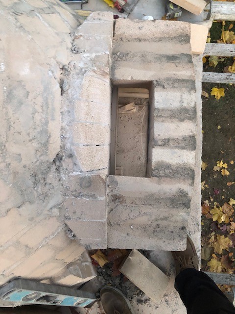

                            • 5263
                            #118
                            Building a 4" thick door will give you a lot of insulation power but weight will be a factor. IMHO, Ceramic Blanket, Foamglass and ceramic blanket have roughly the same K value (thermal conductivity) so use the one that is the lightest in weight. SS has the lowest K value of carbon steel, aluminum so best metal choice but get as thin as possible and still be weldable.I can't tell from pic but it looks like the reveal is failry small, 1/2" or so. Some builders are using wood stove gaskets for tighter seals but I did not. Not sure a door thermometer gives a true internal temp. I use a laser gun.
