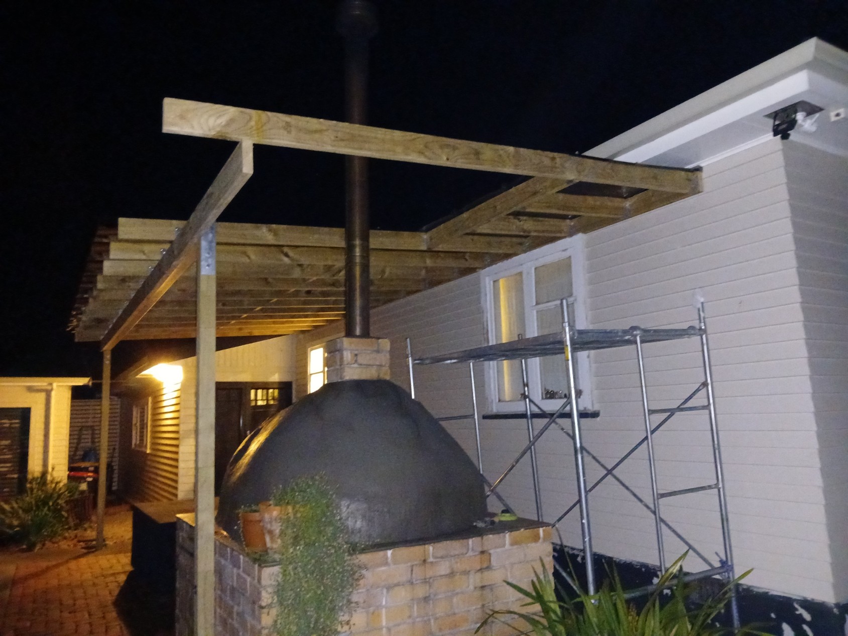

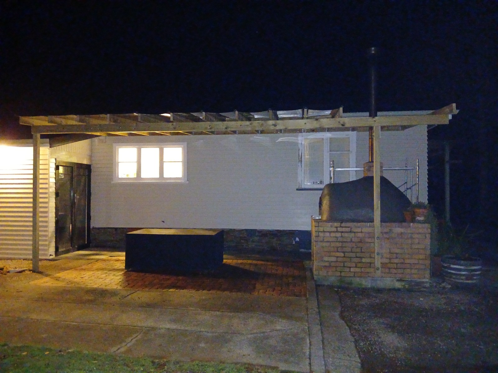

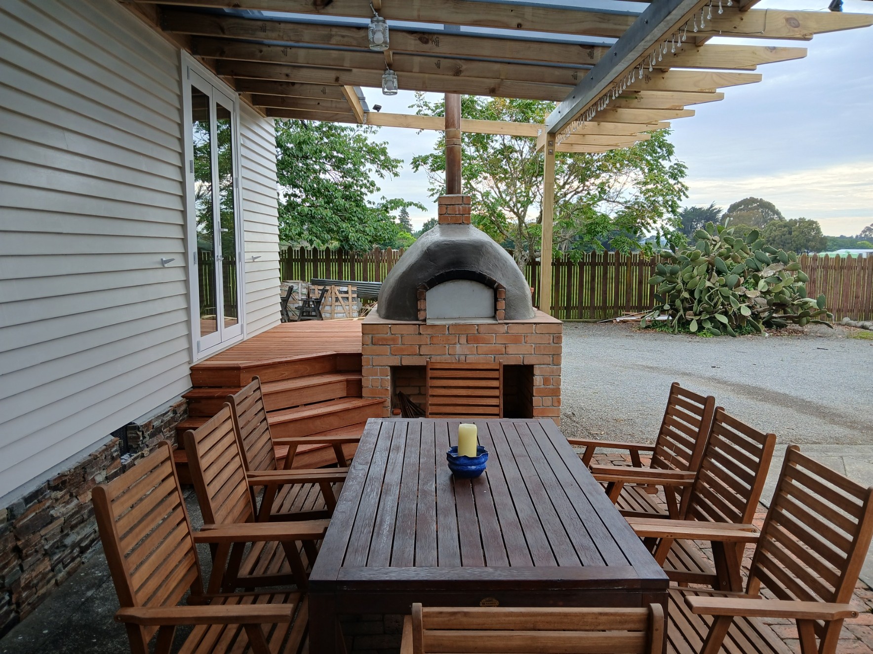

                  Time for an update. After having had a pretty wet oven due to lots of rain, I've decided to build a verandah over the oven and patio. I'm almost done, still some finishing touches such as facia, gutter, downpipe etc to do. The unpainted window will become a pair of french doors, so we can access the oven more directly from the dining room.
                  Click image for larger version  Name:	20240707_182722.jpg Views:	0 Size:	377.2 KB ID:	459765 Click image for larger version  Name:	20240707_182737.jpg Views:	0 Size:	368.6 KB ID:	459766

                    Looking great Mark! You'll certainly use the oven even more with the protection from rain Next, I bet a drop-down countertop along the side of the house will appear. I've appreciated all your forum constructive comments over the years...glad you joined our WFO family.

                      Thank you Mike! Much appreciated. And thanks for the work you do as moderator. I'm a moderator on a busy international photography forum and, while there's about 8 of us, it can be quite a job sometimes!

                          That is looking really nice! Once you get your roof done you'll wonder how you lived without it. Are you planning on putting up any sides?
                          Since we built ours some of the lots around us have been cleared and built up with multi-family dwellings. Having the translucent side walls is nice as we can chill out around the oven with a little privacy.

                            It sure will John! We're lucky in that it's the most protected area of our garden and no close neighbours, so probably won't need any screening. I may end up adding a bit of a wind screen on the South side, but will see how we go first.

                              JR, no sides at this point. But, will add a pergola to the front of it and plant something, maybe a grapevine or something aromatic. We're lucky in that we have no real close neighbours and plantings between us and the closest neighbour, so pretty private really. We have paddocks to two sides and only the one closer neighbour.

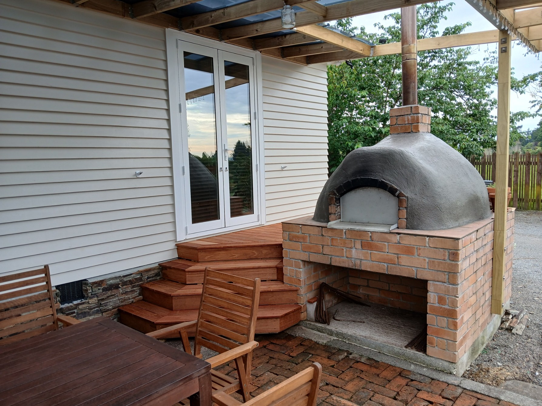

                                An update. House now painted, new roof, verandah completed. Deck now complete at this end of the house so direct access through the new door to the dining room and kitchen, where there used to be a window. Click image for larger version
ID:	468659 Click image for larger version
