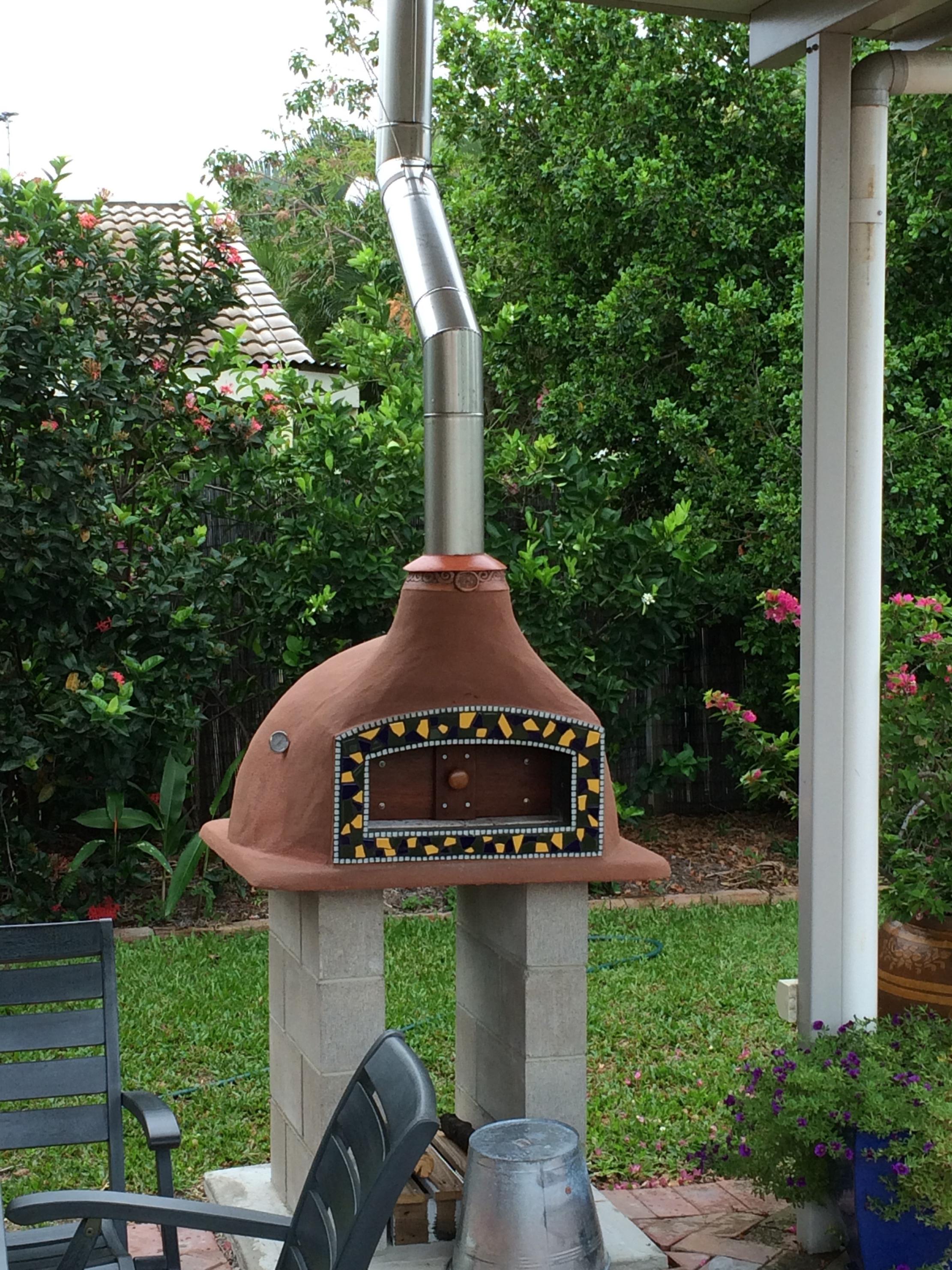

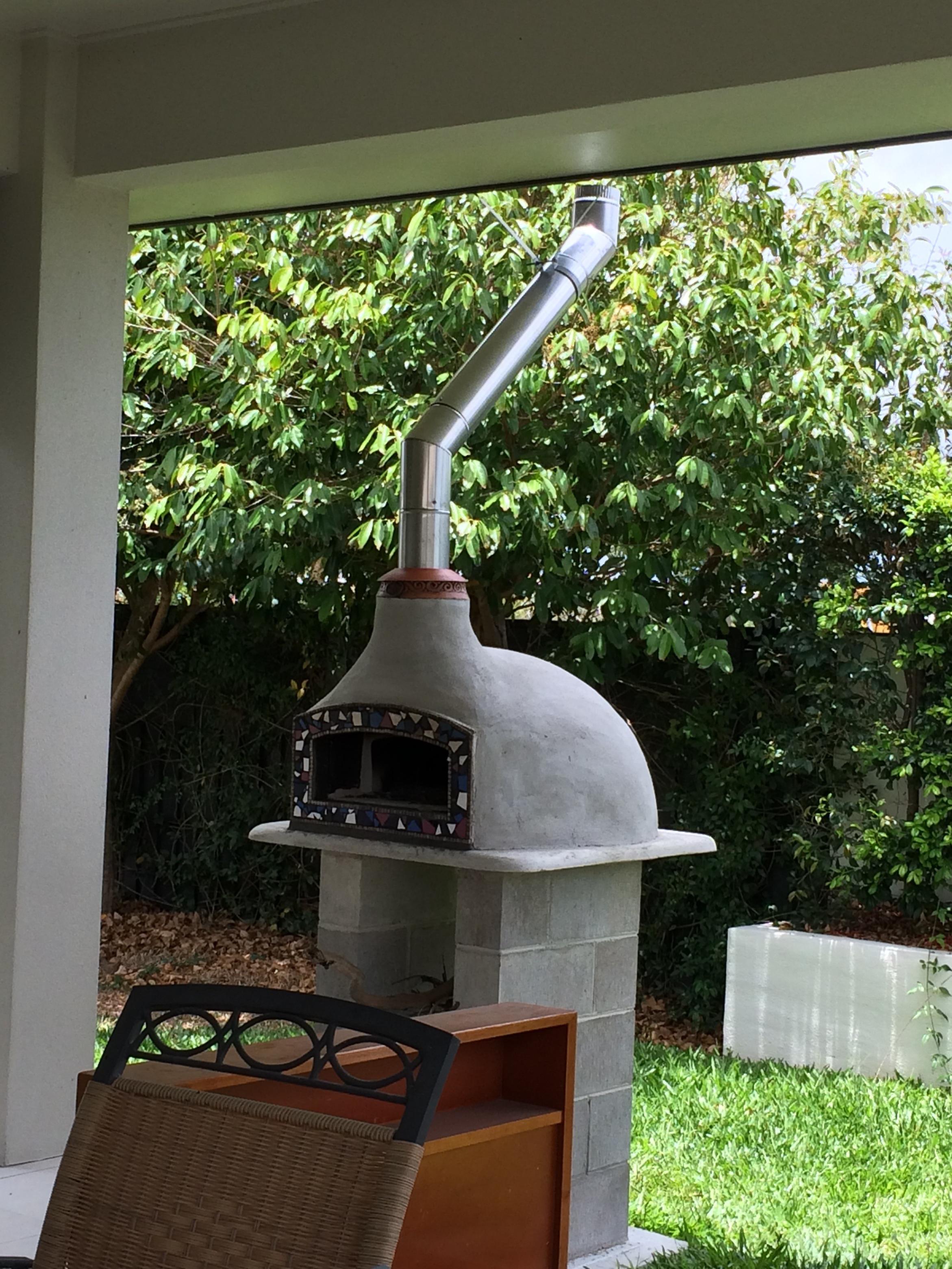

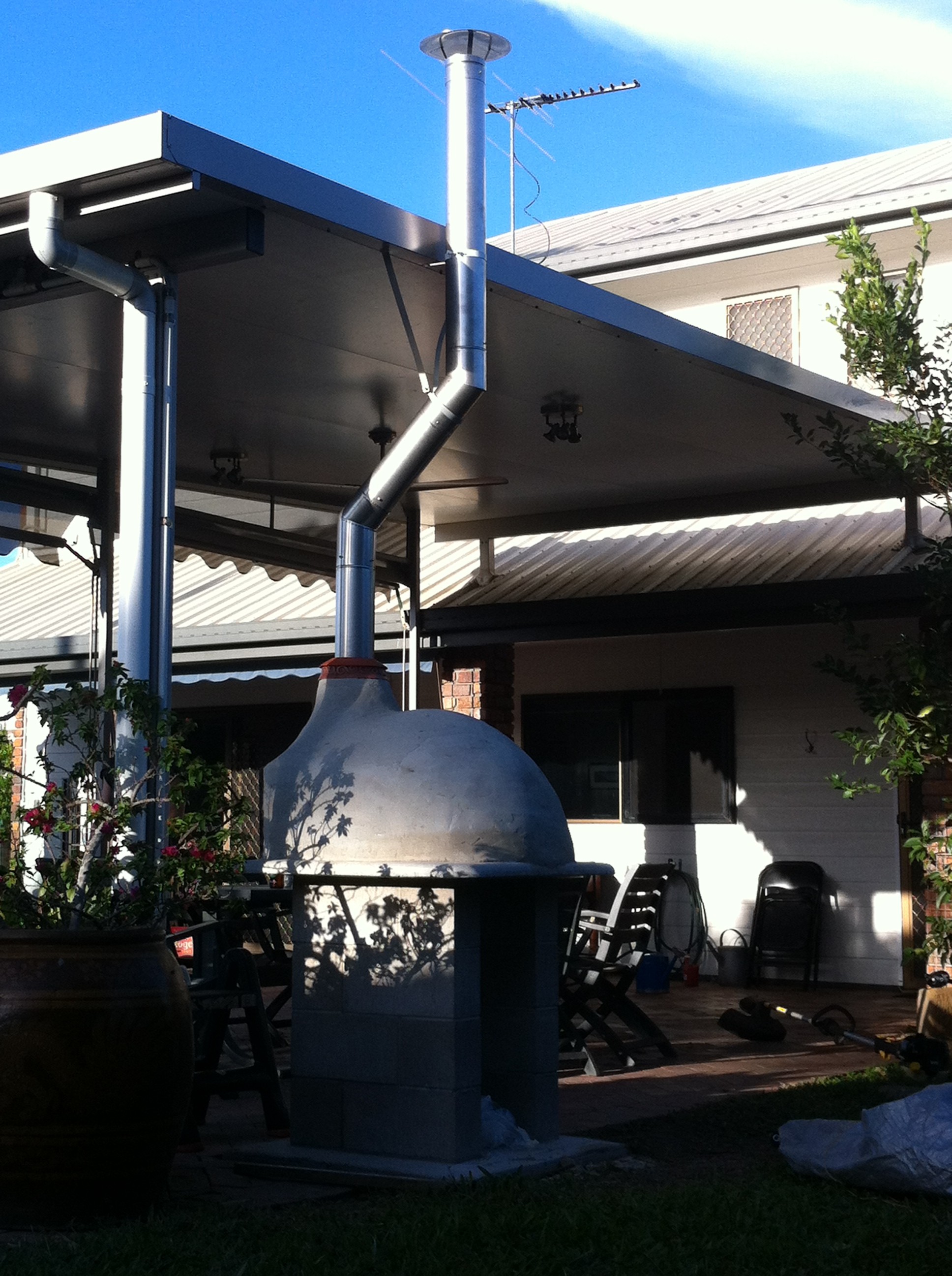

          Click image for larger version  Name:	Lara's oven  copy.jpg Views:	0 Size:	853.2 KB ID:	469073 Click image for larger version  Name:	Lara's flue copy.jpg Views:	0 Size:	870.9 KB ID:	469074 Click image for larger version  Name:	Tessa's oven copy.jpg Views:	0 Size:	818.1 KB ID:	469075
          Here is an alternative method, that I personally prefer, because it does not require a double or triple flue that a roof penetration does. The oven mouth is well under cover, but its bum is out in the weather. As well as staying well away from flammable roof trusses, it also eliminates corrosive emissions falling on the roof around the penetration of steel roofing material. My sister had problems with that from a slow combustion stove, which required an expensive repair to the roof.
            I like it! With my squirrel-tail flue position, the oven mouth is always dry. I may cover the gap with steel, no purlins, but I don't need to crank the flue. But good solution, none the less.
