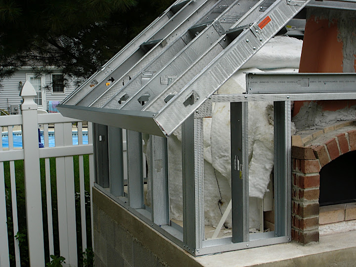

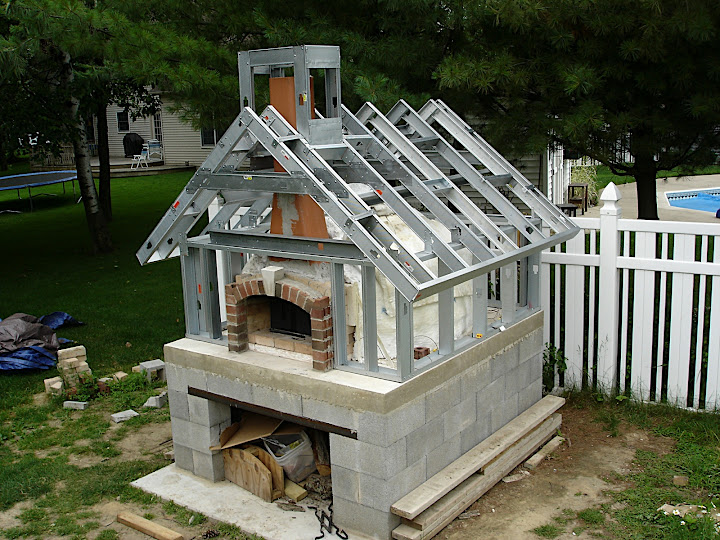

            I finished the bulk of the steel framing for the enclosure today. Other than an occasional brace I might need to add for support once I install the cement board, I'm done with this phase. I enjoyed it initially. It then became a real pain (literally, my hands and arms are really nicked up!).
            I'm still not sure how long I want my overhangs to be. I'll wait until some of the stone goes up. I put a length of tracking on the ends of the trusses temporarily. Mainly because I was sick of hitting my forehead on those sharp edges!

              Re: Michigan WFO
              Mike,
              Once you wrap that chimney in blanket, or vermic/portland, I doubt it will open up if it is cracked. I really learned a lot tonight after my fire!
              Even my dome did not crack, and I really insulated according to heat location. More in the upper third of the dome, then the most from the dome top to the flue. Even with a raging fire in the dome, the center outside was 90 degrees ( ambient temp of the day)
              Lars.
              ps. I like the steel framework. It will really withstand the elements. Do you plan to fill with more insulation?

                Nice work, Mike. That thing will withstand a nuclear blast!

                  Awesome work Mike! Steelworkers of America beware

                    Well, it took a while, but I got some time put into the oven today. I finished putting concrete board on the walls. I worry that the peak is too high, looks a little out of balance. I hope it looks better with stone on it. Too late to turn back now.

                      Mike, you have officially surpassed ME now. I'm so jealous. Your enclosed oven looks great. I really like your roof peak angle. Looks very nice and will be impressive with the stone veneer. Is that mortar or thin set you used where the conc boards come together? Maybe I need to do that, also fill in some of the uglier screws that went too far into my cement boards.
