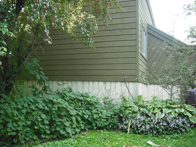

Digging the 48 inch deep (below the MN frostline) footings was the last discrete thing about the whole project. Then a truck with a 100 ft boom showed up to blow in the concrete for the hearth tower. After that, although they're still guessing, there was nothing clandestine about this!2 Photos
