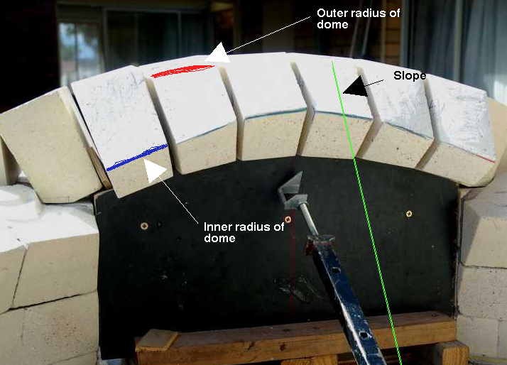

                  Are you doing a tapered inner arch, it appears that the bricks you have cut show this. It is the best way to match the dome and inner arch. If you are not familiar, then do a search on the forum. But here is a pic showing how the IT works for a tapered inner arch and you have to use full length bricks to accomplish.

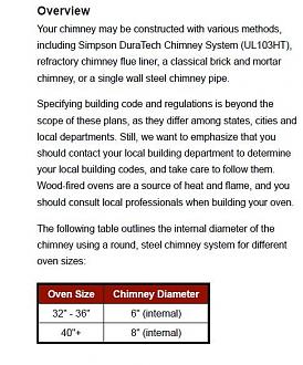

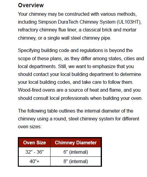

                            Will This 6 inch chimney be sufficient?
                            (42” Oven)
                            Thanks for responses.
                            David
                            • #15
                              No. See attached Click image for larger version  Name:	chimney.JPG Views:	0 Size:	86.9 KB ID:	417019
