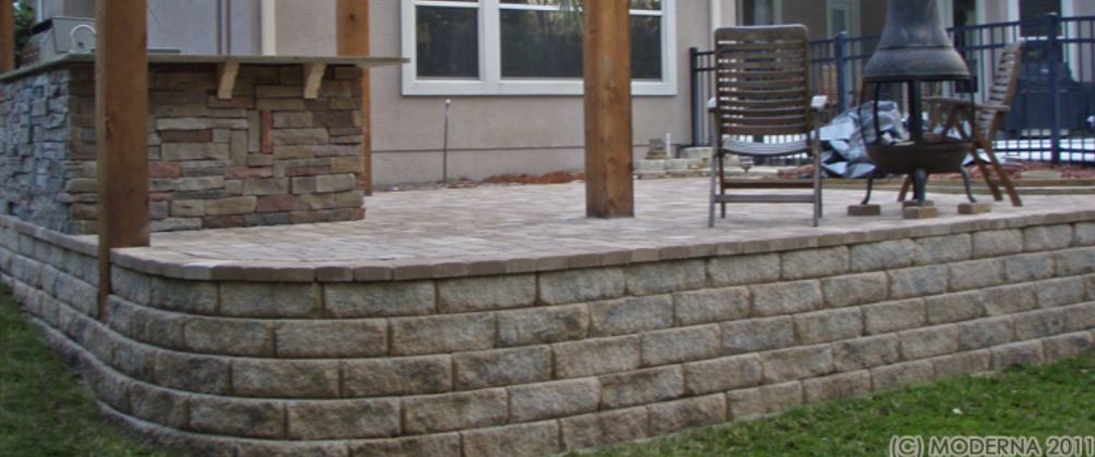

    i am in works of planning my vesuvio replica build but a question on base. Im currently having a paver patio installed with a corner section being poured concrete to set oven base on. With paver being stronger than concrete would it be ok to just have pavers the entire area and lay cinder blocks on top? Thanks
    It depends on what the foundation subsoil consists of. Pavers on loose soil is a very different situation than pavers resting on bedrock.
      Thanks Gulf. I guess I should have provided more clarification. The patio area where the pizza oven will sit will have soil compacted by a compactor. then there will be at least 6" of 3/4" stone compacted in two 3" pours. 1" layer of sand and then pavers on top. The corner in which over will sit will have a stone retaining wall around it. Will be similar to below but at a right angle

        I’m assuming that you are planning to remove the topsoil and compact a suitable fill dirt. Top soil is not suitable for a foundation. A good portion of topsoil is made up of organic matter. Your plan is just fine for pavers. However, I would still pour a reinforced concrete slab for the oven stand to sit. If there is any setting, under the weight of the oven, that would insure that the stand settled evenly with no cracking.
          I agree with Gulf on pouring a concrete pad where the oven sits. With a concrete pad, the base is tied together both horizontally and vertically with wire mesh and rebar where as individual paver are not tied to each other.

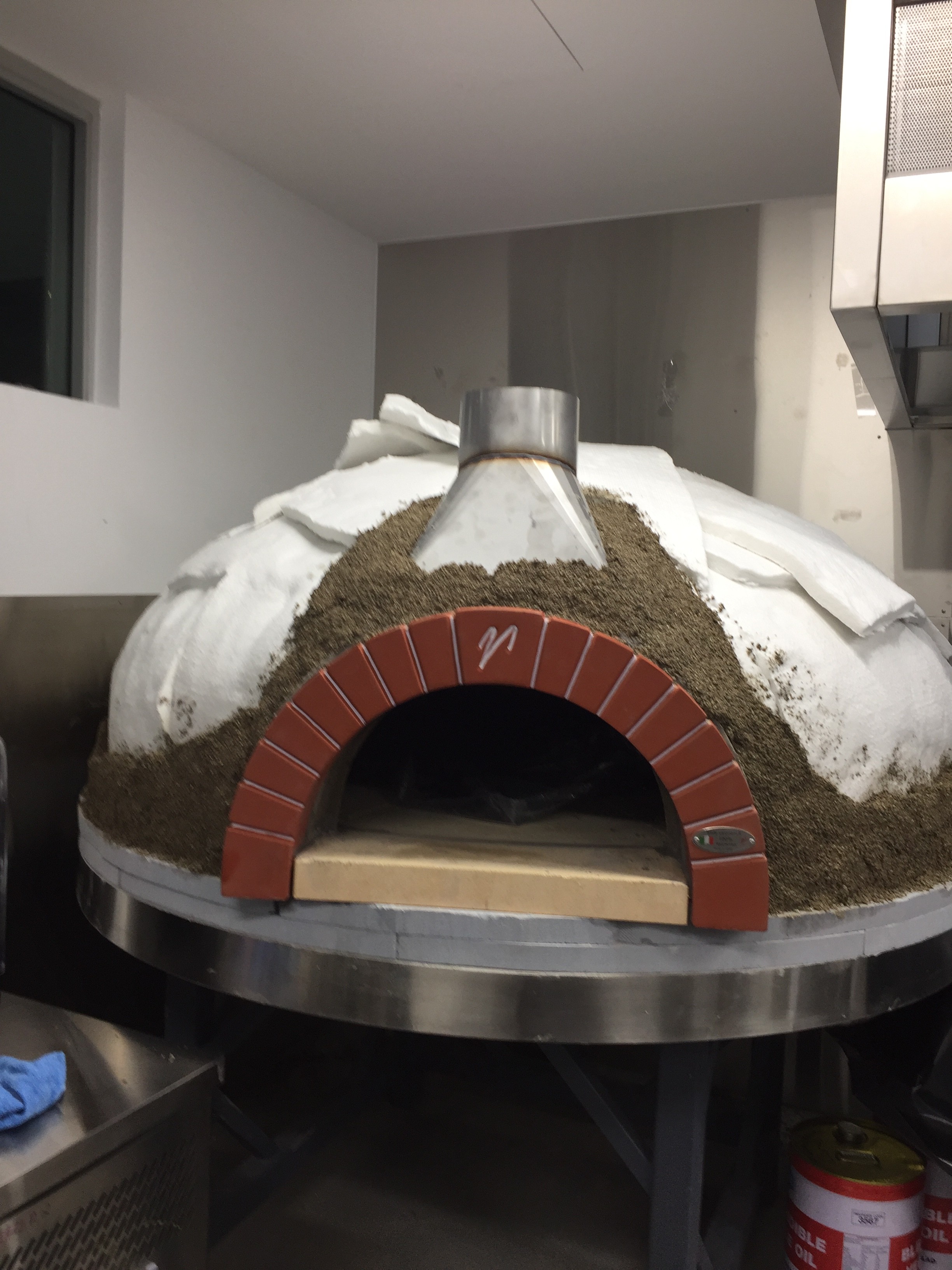

                            I built a Vesuvio Click image for larger version
Name:	IMG_2009 copy 3.jpg
ID:	452672 160 build that could be similar.

                              Originally posted by Golfpro2301 View Post
                              Thanks Gulf
                              Do you know of any threads on here that has a vesuvio/ napalino type build?
                              Okay. I think that I know what you are looking for now. The Vesuvio and Napalino ovens are finished ovens. You are not going to learn much from threads that just place these completed ovens on a stand. Both of these completed ovens have a kit oven core that can be purchased from Forno Bravo. The Completed Vesuvio has a Casa core. The Napalino has a Giardino core. Both of these kits are for sale on the Forno Bravo site. The specs and installation instructions and some videos are also available on the Forno Bravo site. You can also scroll through the Forrno Bravo Oven Installation Forum for the builds that you are looking for. But, along with Vesuvio and Napalino, look for Giardino and Casa.
