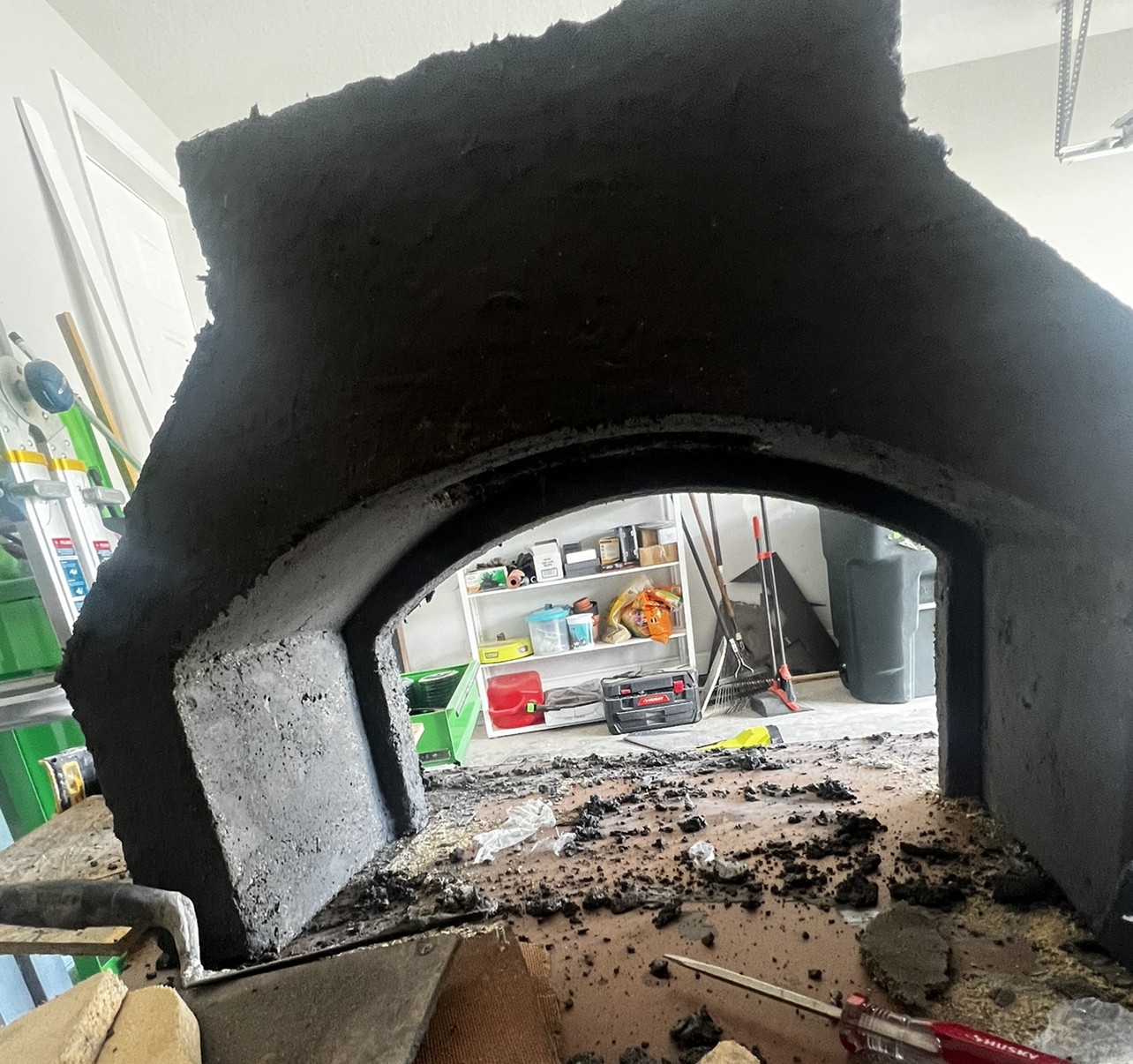

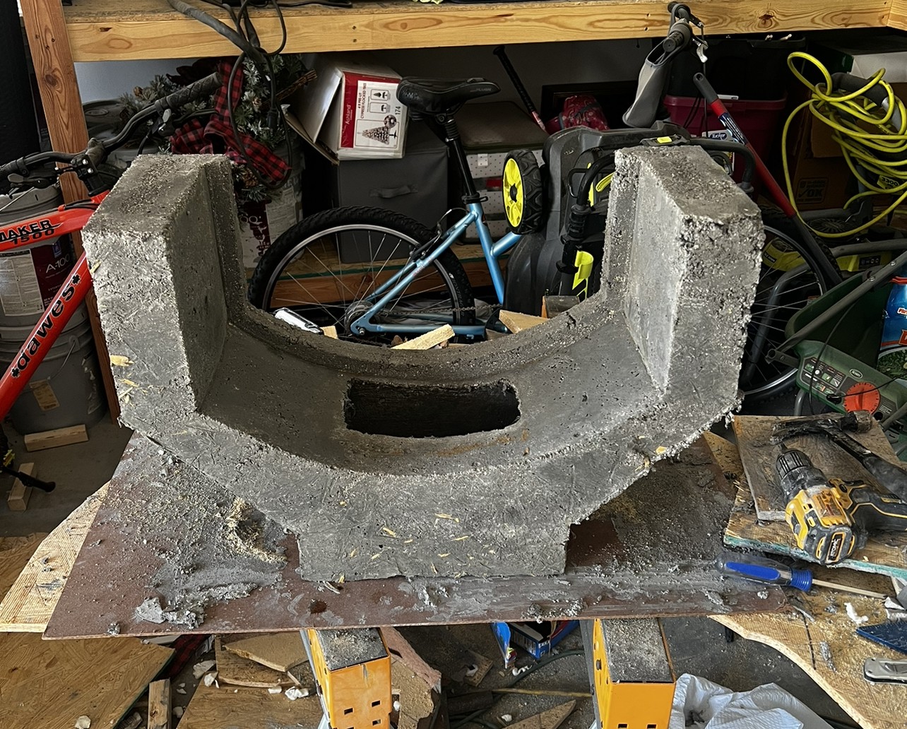

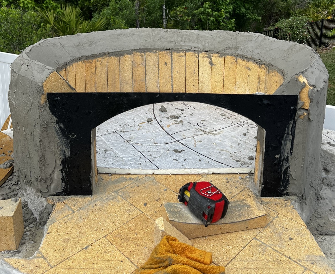

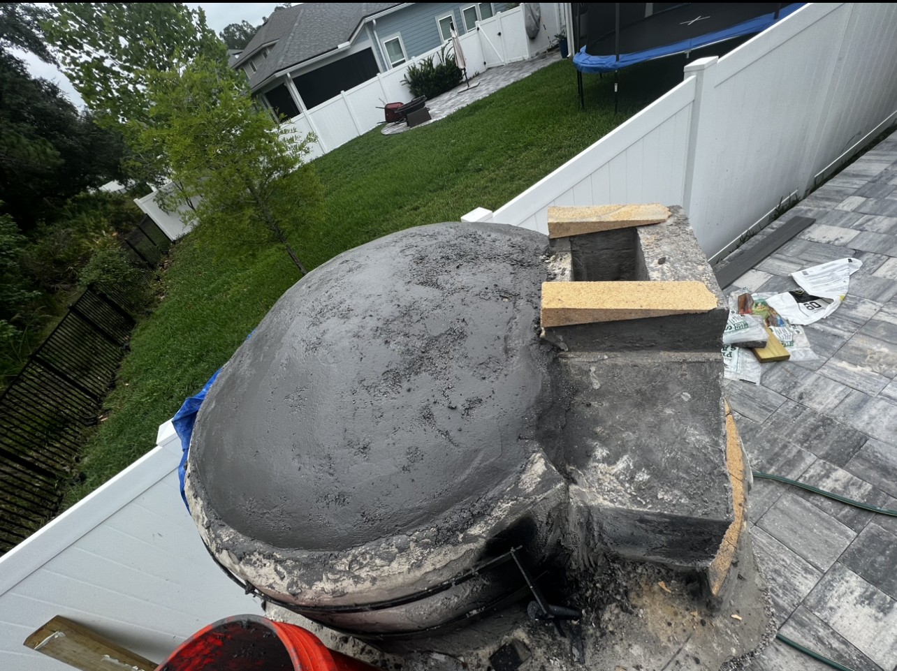

What would be a good flue opening size? I plan to use 6” stack but not sure how big opening should be on forward arch. If I use same philosophy we do for bbq smokers I would need match area. I can do prob 5x7 or 5x8 which is more than area of stack opening. Thoughts?

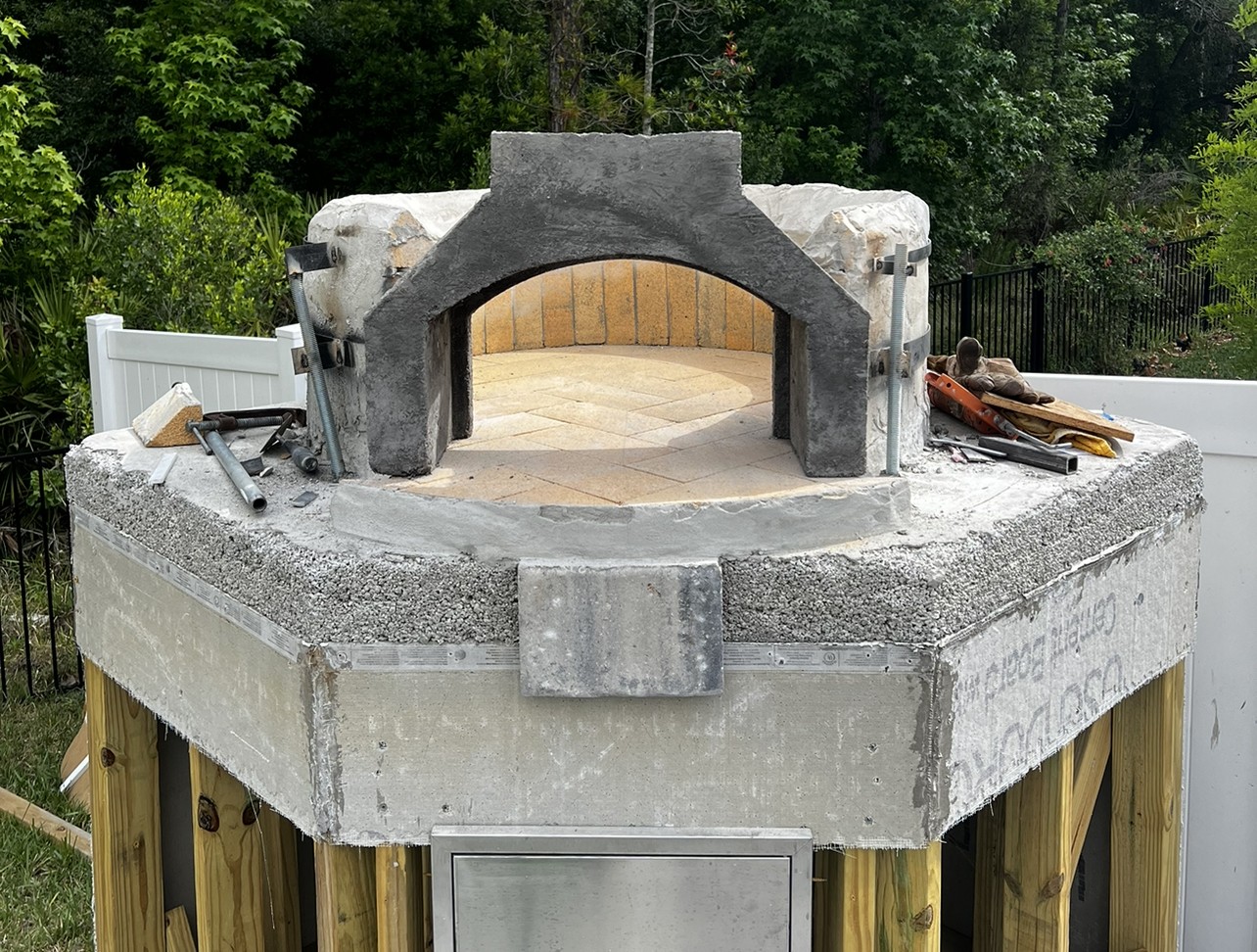

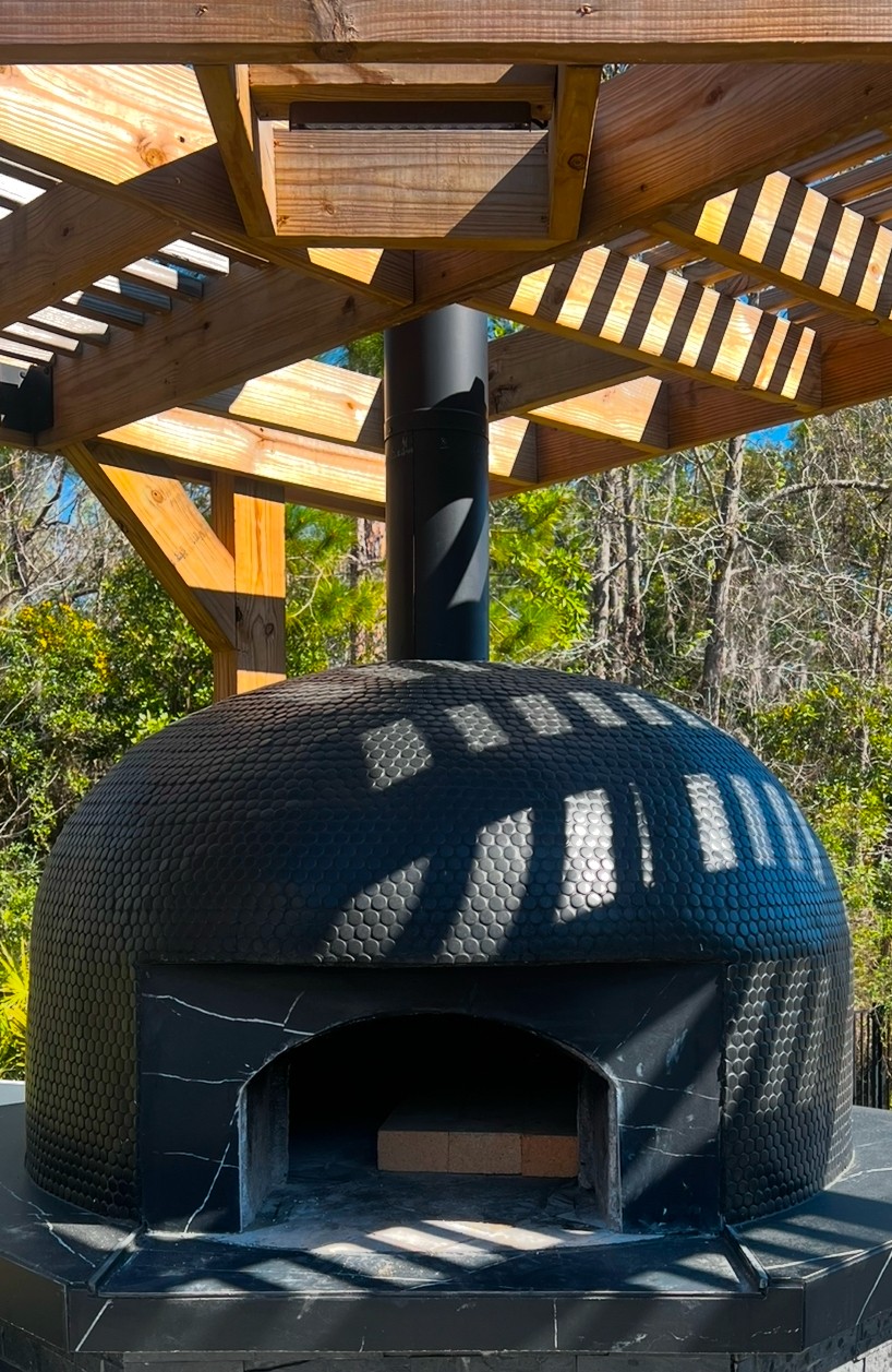

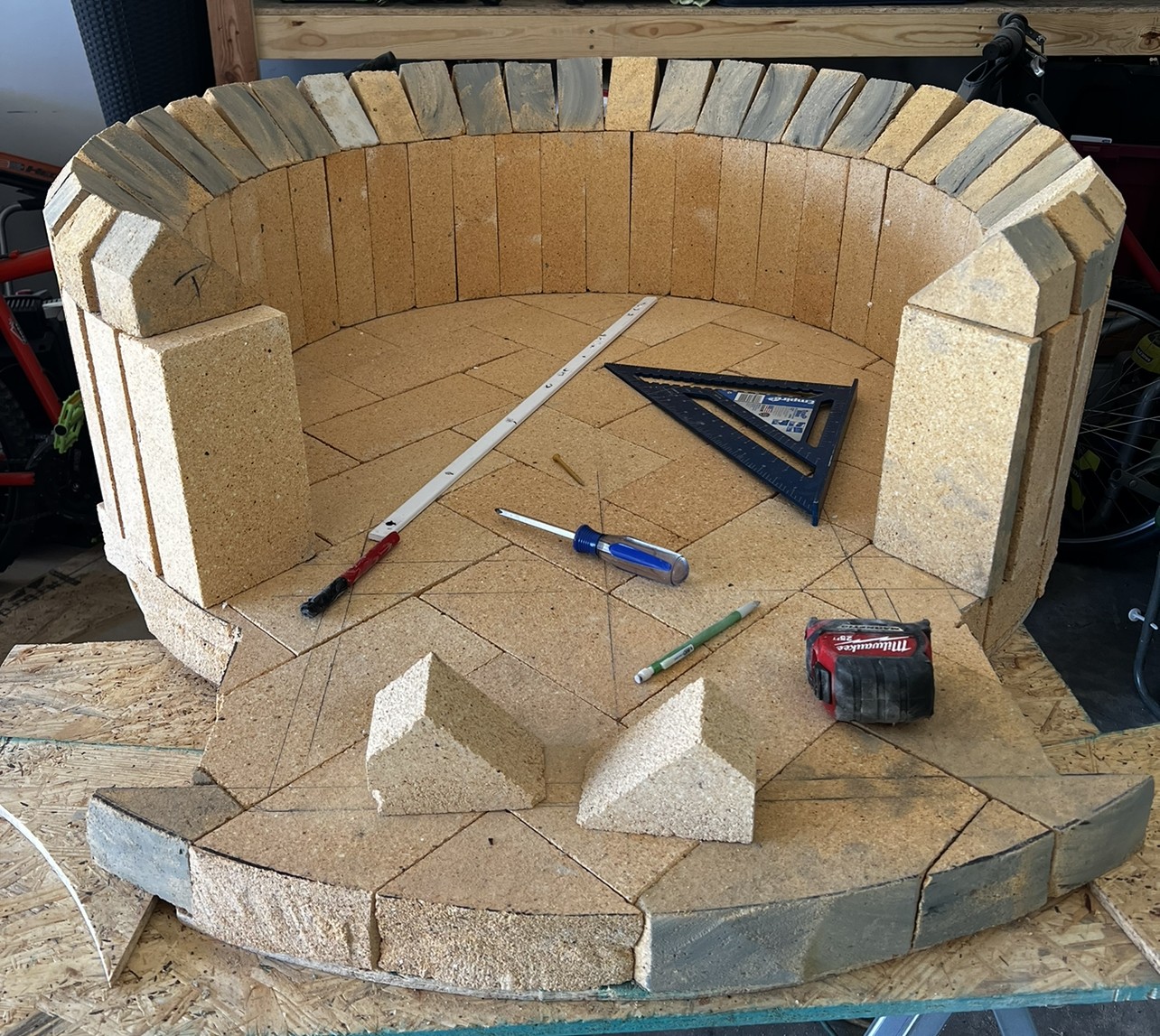

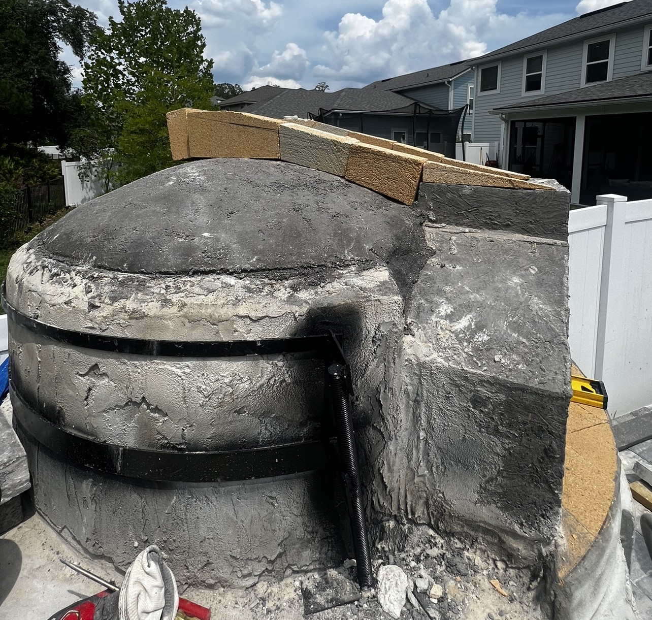

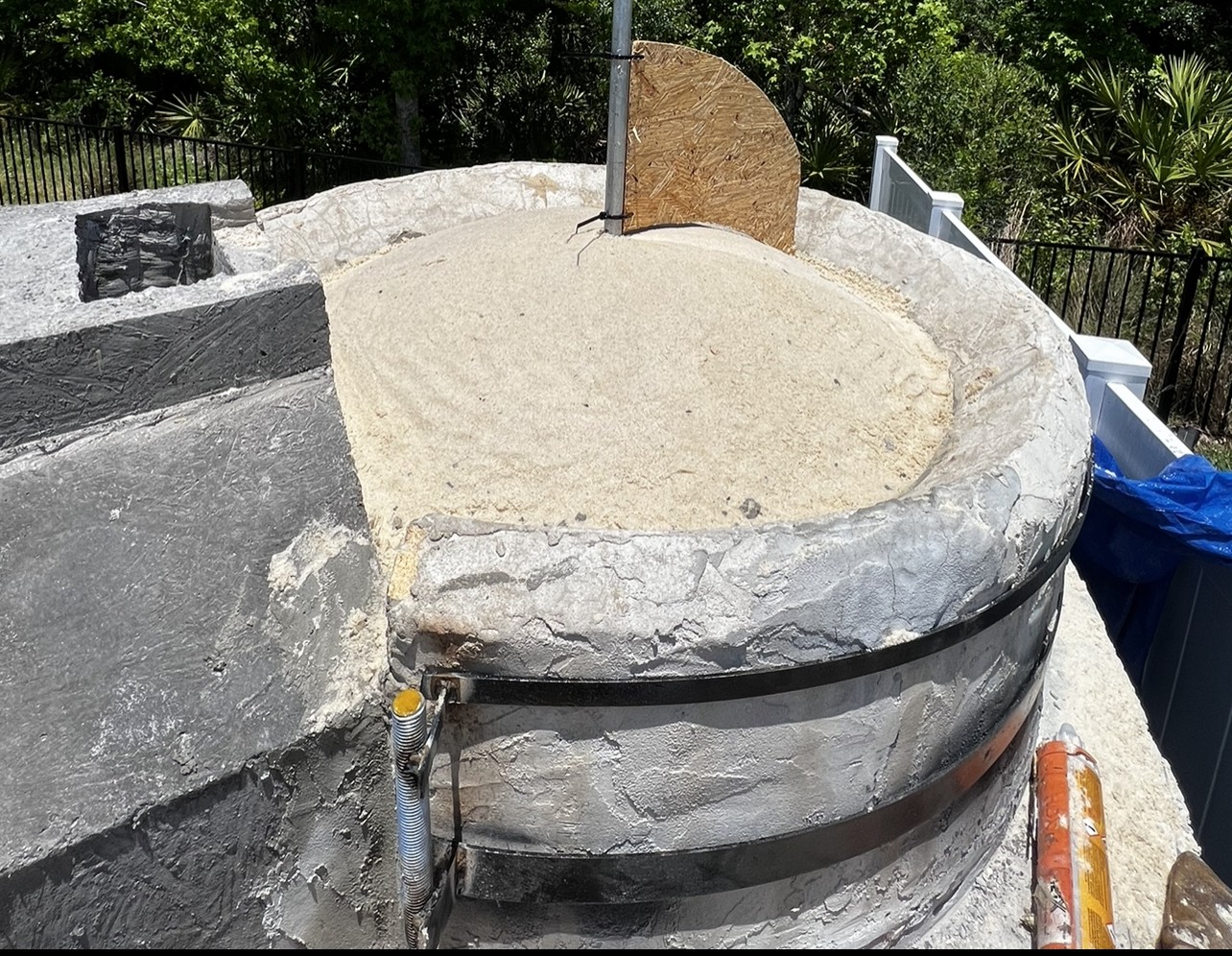

also I am pretty much copying larry P low dome build. Here is where I am at
