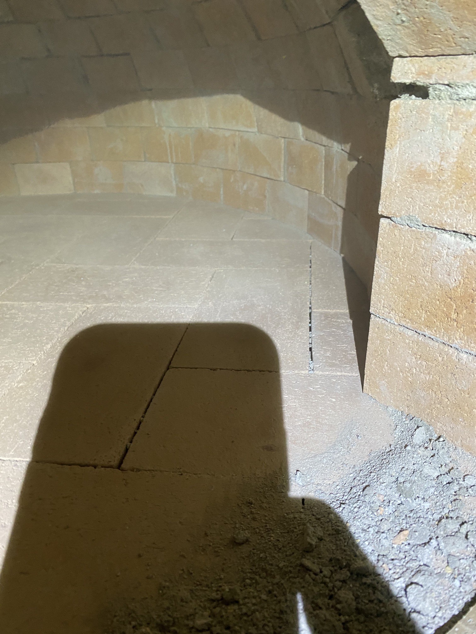

                            Thanks for the kind words. after taking off my platform I noticed a small gap, let's say 1/8" between floor bricks near the front right of my dome. Awesome how the gap shows really nicely in the shadow of the iPhone, right?
                            I am thinking of taking my firebrick paste, the material from cutting the bricks I have left over, and then fill it in somehow with my trowel. Do I need to do that? Or will ash fill that in and not worry much about it?
                            Also, anyone else with the drip stains of mortar? Will these burn off, can I wire brush it off or do I just need to accept them?

                              I think ash will fill those gaps so you need not worry. If the mortar stains will brush off, then that will be good. In my case, I just left it. (But then, my oven is not nearly as tidy as many people's!)
