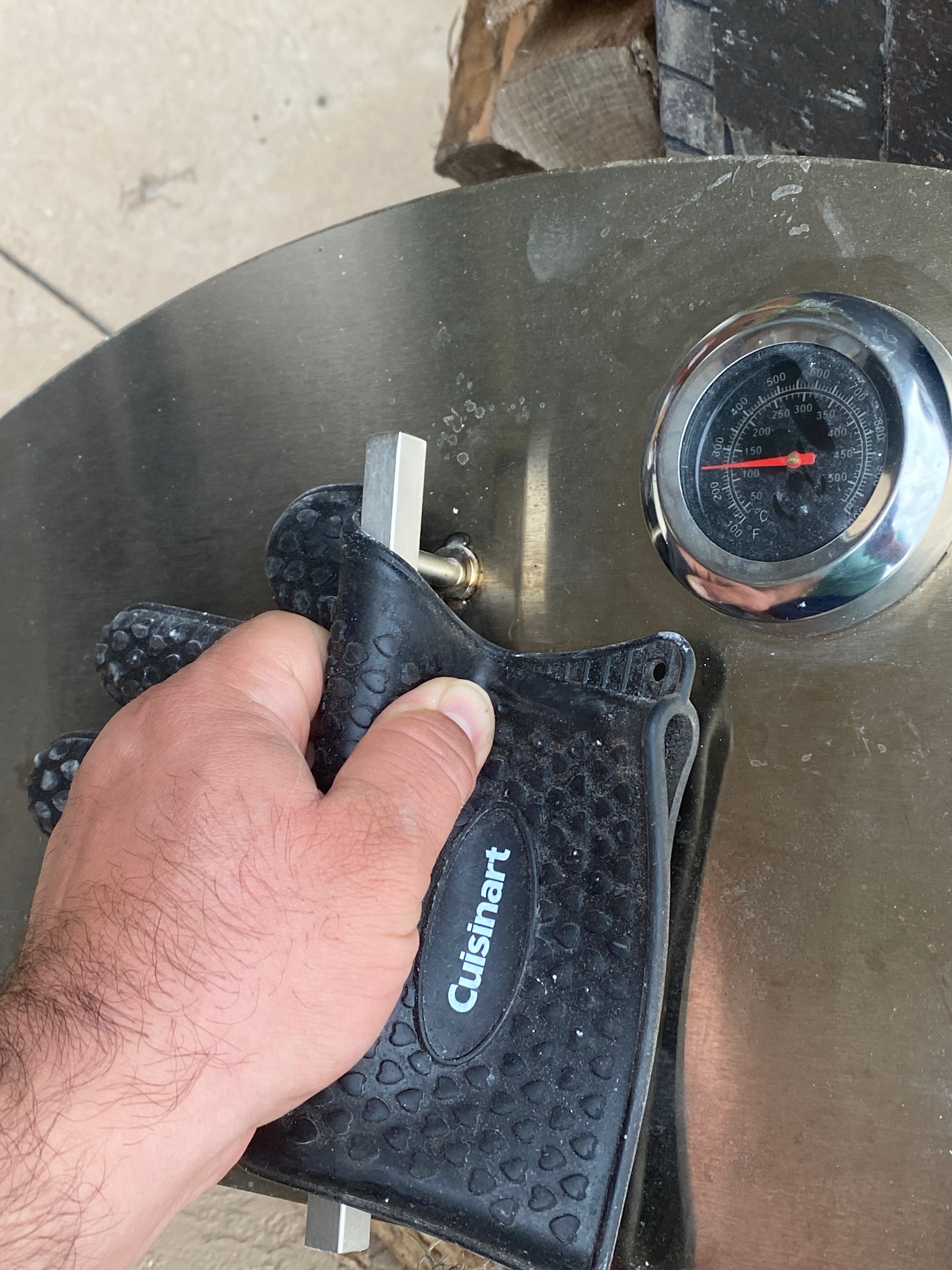

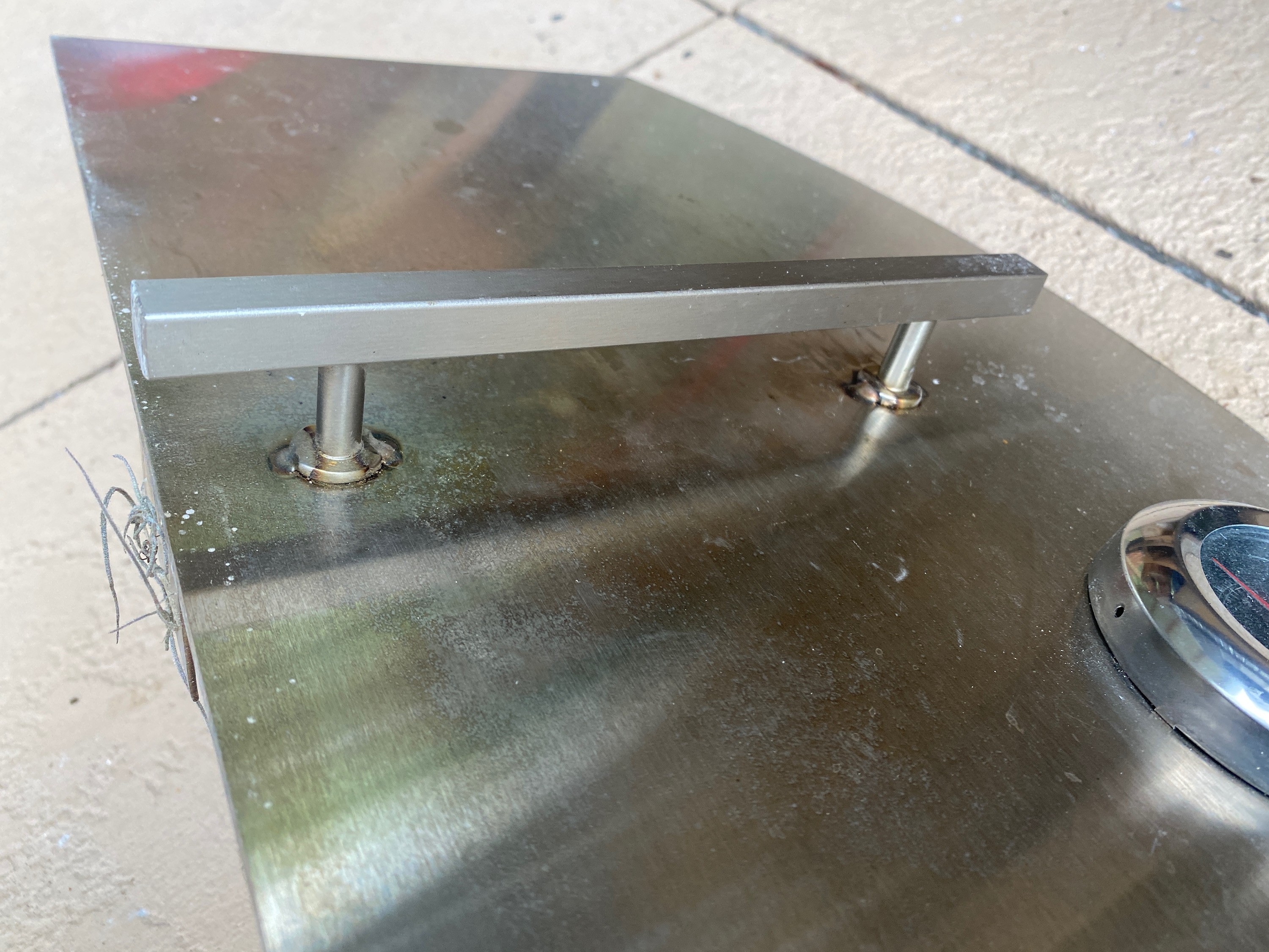

    i plan on chopping my handle off and replacing it with something that is more insulated.
    Have you checked out the "Show us your door" thread (linked below)? Many different styles that might give you some ideas. Also maybe post a picture of your door so we can see what you want to cut off and possibly how replacement handles might be attached.

        Constantly have to use a glove.

              Those are great - have them on both my doors. I can't see the back of his door but it looks like he might be stuck with a welded solution.
                The handle is welded on mine. I think a diamond blade followed by a grinder to touch up the welds will make it flush again. This will give me the opportunity to drill a few holes for a new handle.
                    I wonder if you can wrap the handles with leather. This way you can keep what you have and not have to take anything apart
                    There is also food grade silicon that you can form up your existing handles and pour the silicone and create a thick coaring that is oven safe. Smooth-sil is one product but there are more out there.

                      i have about 1/4” between my door and finger as it is right now when I grab the handle. I can’t add anything else to it right now.
                      Originally posted by Chach View Post
                      I wonder if you can wrap the handles with leather or some type of material. Maybe thin sheet of ceramic blanket to insulate it and leather strips over the top of it or just the leather strips a few layers of it. This way you can keep what you have and not have to take anything apart
