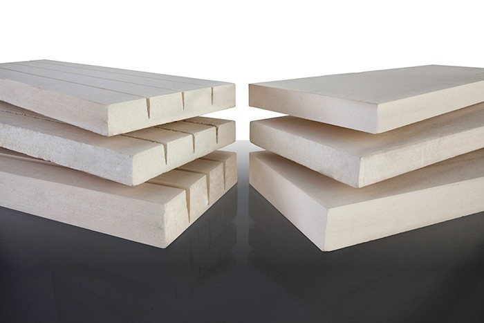

      +1 on Russell's advice. I too got my insulation from DI. Just make sure that you are ordering the solid Thermo-12 Gold board. The boards on the left in the pic are scored to fit large piping and round vessels. Someone mistakenly ordered the scored for their oven. You want the solid board. It also comes in water resistant and non-water resistant. I believe that the water resistant may have just a little less insulating factor. I have no experience with it. Regardless, you will want to keep you oven dry.
      Click image for larger version  Name:	CalSil.jpg Views:	0 Size:	43.1 KB ID:	436732
                    Whilst the water resistant board should be the best option (price consideration) the cal sil with the slots should be a better option than the solid variety (again price consideration) because the slots provide an exit path for moisture to escape, if the board is laid with the slots facing down.
                    • #11
                      I respectfully disagree.I don't think that the reduced R-value that the dead air spaces yield make it a better choice over solid CalSil.
                      • #12
                        That may be true, but the increased ability to eliminate moisture more efficiently should more than compensate for any reduced insulation value.
                        • #13
                          I'm very sorry David. I still can't come around to your way of thinking on this. Yes, wet oven insulation is about the same as no insulation. But, there have been many discussions on improving water elimination that you, I, and many others have been contributed to which have led to construction methods that improve this problem without using a less efficient insulation. We may have to agree to disagree, but I would like for anyone reading this in the future to at least do some research before determining that scored insulation is "better" than solid.
                          • #14
                            Yes, without conducting specific tests on both types, the two of us are just guessing, but as you say "wet oven insulation is about the same as no insulation" , so keeping or helping it to dry is more important than any slight loss of capacity.
                            Those with oven enclosures or a roof over their oven are less susceptible to this problem of underfloor moisture. Although in my case, living in the tropics means the oven will pick up moisture from a couple of weeks of really high humidity and no waterproofing or roof will keep that out.
                            I would however like to take the credit of being the inventor of the drain hole design.
