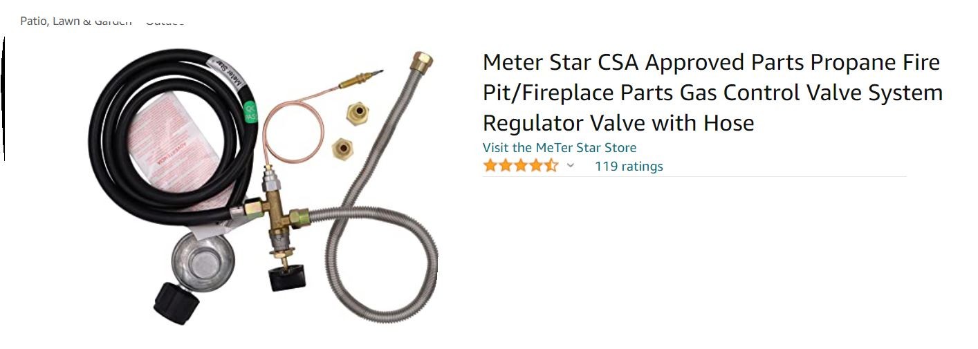

                    Can someone point me toward a devise that would work with my set-up. Thanks.
                    Would this work? Click image for larger version

                      #25
                      This question should be directed to a license professional, city inspector, or local gas provider as per the Forum disclaimer. I removed the direct hyperlink to the flame failure device.
