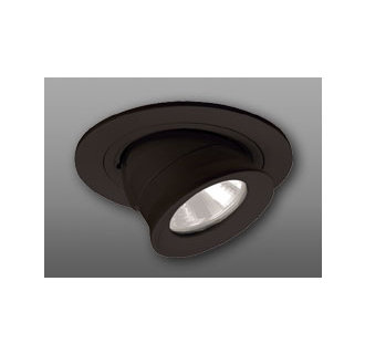

            I decided to go with two of these for task lighting. Low-voltage three inch recessed with a pull out light. One of the only 3 1/2 inch depth units I could find.
            Not sure about adding ambient lighting. I don't know what else I would put in the eaves, and I hadn't been thinking about lights on the face of the oven. I think I may just put a string of lights around the patio or even around the oven.
