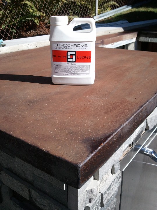

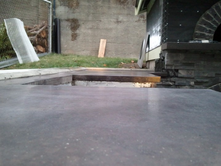

          We have surprisingly good weather here, so I got the stain onto the counters this morning. Looks brown now, I guess it will be black once I wash off all the stuff dried to the surface? I hope so.
          The manufacturer doesnt really give too good of instructions for the use of this stuff. We'll see what I get!

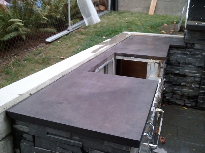

            Ok, after 3 coats of stain and sealer, I am finished with the BBQ countertops. I am pretty pleased with the way it came out. It's not a solid black color - it's brown to black mix. But I like the way it looks. It's dark enough to contrast with the stone veneer, the brown tones complement the clinker brick I used for my arch, and the sheen is very cool!
ID:	291891Click image for larger version
            I still have to clean and seal the landing. That one I need someone to help me lift off and put on sawhorses - and it is too heavy for my girlfriend to lift.
            I may wait to seal it until she gets the mosaic in though.

              #306
              Re: Starting new 36" build
              Looks fantastic. I would not mention that black was ever in the plans.
              dvm
              sigpic
                #307
                DJ,
                Way to go, looks very nice to me. I am still waiting for a window of good temperature to put my final seal coating on. Weather is very unsettled here. The moment I take the tarps off it sprinkles......Nice work.
                • texman
                  • Nov 2009
                  • 724
                  #308
                  DJ
                  Nice job on those counters and congrats on having that done. I hope to get some templates made this weekend for the door and landing. Stainless door and granite for a landing is the plan. Cant wait to see your mosaic.
                  Tracy

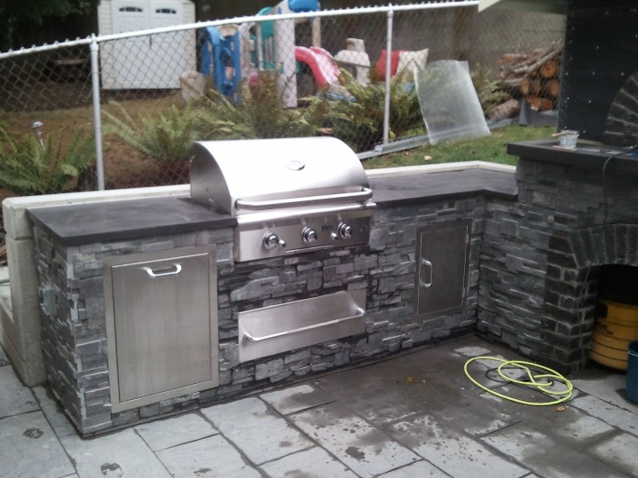

                    Look what I finally got installed, just in time for winter!
                    I also started cutting the metal for my oven door. 16 gauge mild steel. I plan on welding it with a two-inch deep void that I will pack with insulating blanket left over from my oven build. I ordered the high-temp thermometer from our hosts to go through the door.

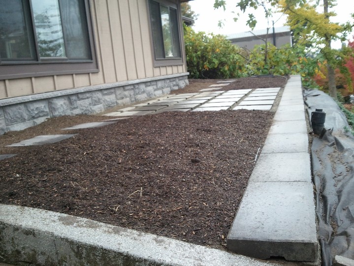

                        Completely unrelated to pizza ovens, but I am totally making progress on my yard transformation. I had some guys in this week and my front yard went from this:
                        to this:
                        I'm in Seattle, where everything seems to be built on a hill. I have struggled for a couple years trying to figure out what to do with that space - all the while maintaining the look of living in a hovel. I am very happy with the transformation. Going shopping for some plants tomorrow to fill in the space.

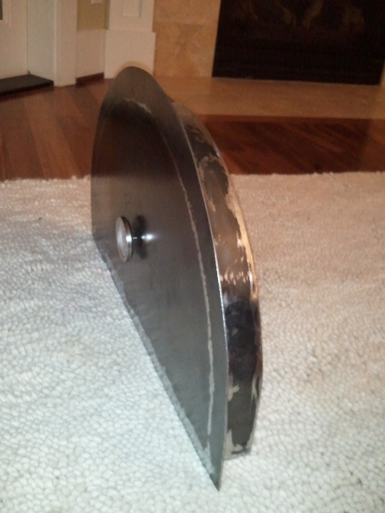

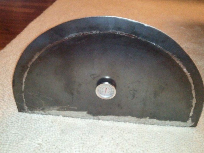

                          Not much going on for me in the oven department, but I am happy to report -
                          I have a door!
                          I had to learn to weld in order to build this thing. Those of you with mad welding skillz may find my efforts a bit amateurish (and I would agree they are). I bought a used HF 90Amp flux welder off craigslist and went to town. With the help of my trusty grinder I was able to get the thing looking ok. here's the details
                          - 16 gauge mild steel
                          - 2 inches of CF blanket as insulation
                          - Weight is 10 pounds, 2 oz
                          - High temp thermometer sourced from our hosts. It's mounted on a 5/16" nut welded to the back of the front plate. I was pretty proud of figuring that out.
                          - 1/4" of space between the door and the oven wall. I may get some CF rope to act as a gasket, we'll see how well it works.
                          It still needs a coat of high temp primer and high temp paint, and I need to figure out handles.

                          • Laurentius
                            • Nov 2010
                            • 923
                            #313
                            How do you remove your hot door? Ceramic suction cups?
                            • deejayoh
                              • Jul 2010
                              • 1893
                              #314
                              that's the "I need to figure out handles" part

                              • mrchipster
                                • Apr 2010
                                • 1502
                                #315
                                You may want to try something like this but welded to the outside now that you are a certified welder.
                                Chip
