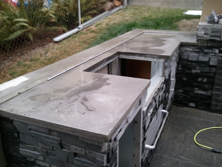

                thanks. I am polishing. I got up to 400 grit on one section today. It is looking pretty good. The edges are a bit dodgy, but I guess it will just be "rustic". On the color - it did not turn out quite as dark as I wanted so I think I am going to apply a black stain. We'll see. I wanted it to be almost black

                BTW, As you can see in the picture, I have finished installing the veneer all the way up to the countertops last week and I think it looks great. I wish I would have taken a better picture of that. Makes all the difference in the world to not have any open patches
                The upside down pour for the oven landing did not come out as well. I have lots of bugholes. Still working on that one! I hope to get both counter pieces polished up to 800 grit tomorrow and then do a slurry layer for the bugholes. I want to finish with 1500 grit on Thursday. Friday it is supposed to start raining here and who knows when that will end!
