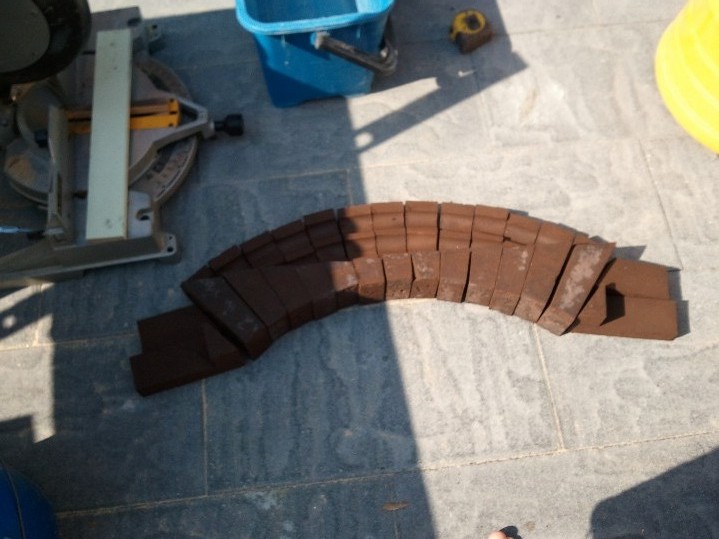

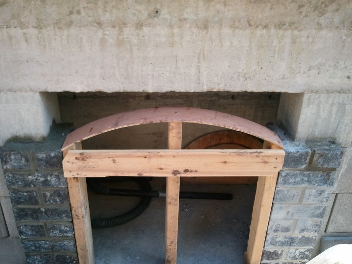

        Insert part A
        Into slot B
        Probably should have used solids, but that was a sh!tload of cutting! I hope this works.

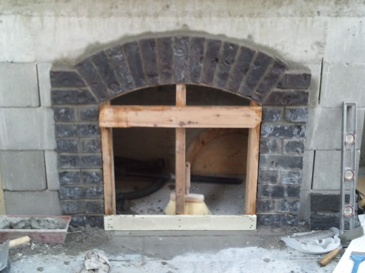

          Re: Starting new 36" build
          It fit! I am pretty happy with the results. I am amazed how much mortar one uses with regular bricks! About 100 pounds just to do that. Course, I had a coule of restarts...
            You don't want to use solids for this type of brick work - cores are stronger. Looks great!

              Wow! An excellent result!

                PS, Great job! on the arch. I wouldn't call that a "faux arch". That is the real deal .

                  wow, nice brick arch. I am pouring counters tomorrow....wish me luck!

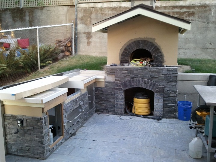

                                I got most of the veneer on, and my decorative arch is now in place. I also mounted all the stainless storage doors/drawers in the kitchen area.
                                I had hoped to get my counters poured tomorrow, but it is looking like that will be a sunday activity instead. I lost a day to digging out the bamboo that had grown under a retaining wall in into my yard. It grew thru 4 feet of dirt! I dug a 5 foot deep hole, picked out all the rhizome I could find, and poured in some herbicide for good measure (I don't have anything growing that deep...) Capped the place where it got into my yard with 8 inches of concrete. Hopefully that will do the trick! Running bamboo is not something you want in your yard around here. It grows all too well.
                                Tomorrow I will get my forms all corner caulked, the reinforcement in place, the concrete on site, and the pigment weighed in prep for an early sunday pour.
                                Wish me luck
