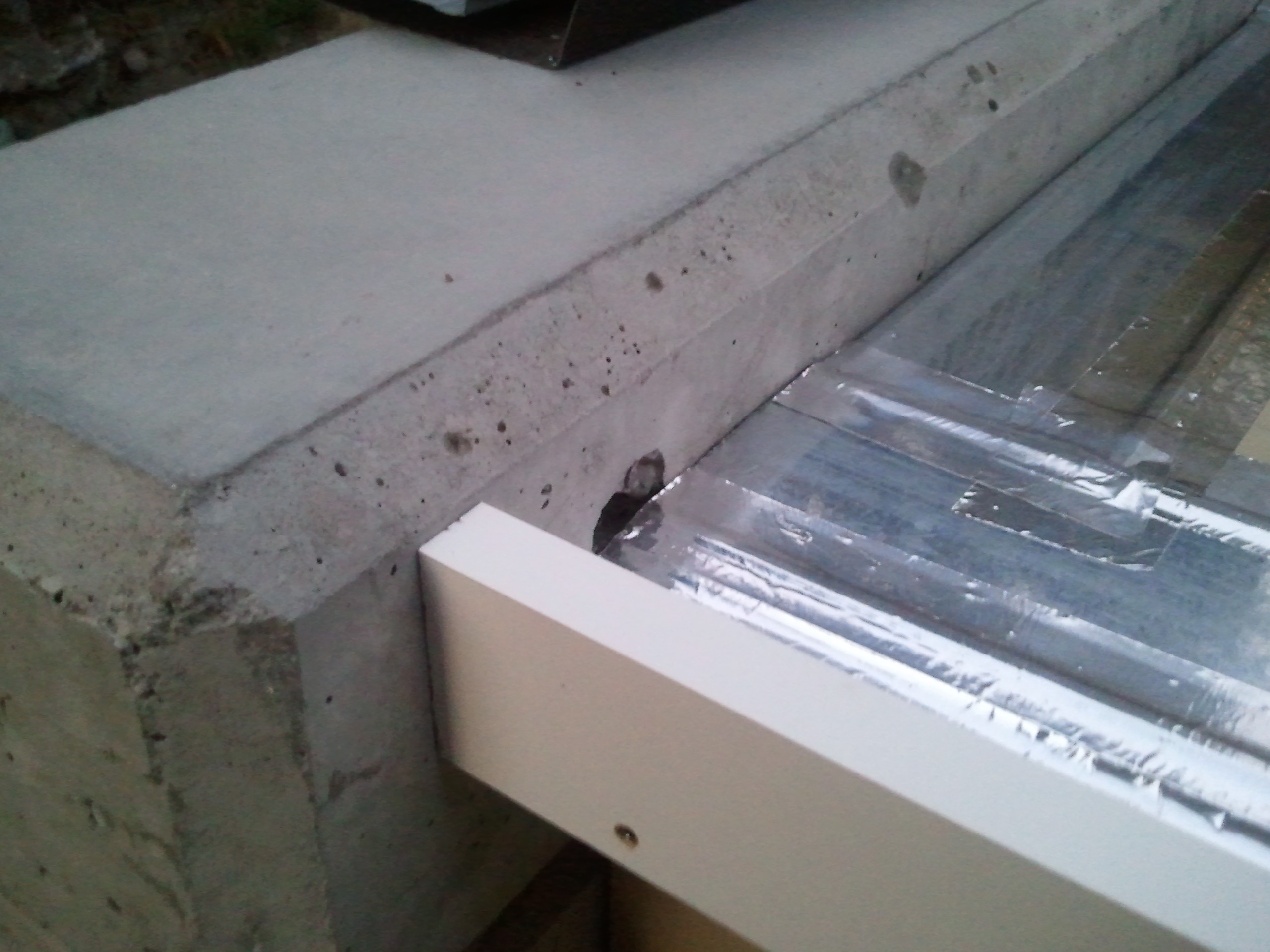

          here is a picture of the back corner of the form, so you can see how it meets the wall:
          The top of the form is just under the edge of the bevel

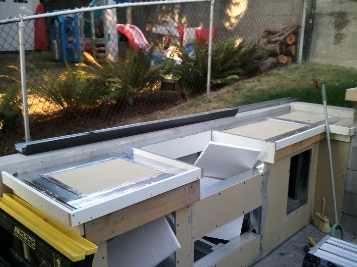

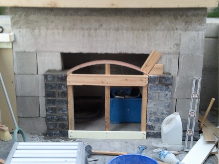

                    Forms, forms, and more forms
                    First, the archway form for the "faux" arch over my firewood area. The wood I'll use to jig the voisseurs and the corner pieces is shown for fit. Setting the columns was a total PITA but I think I finally got it right:
                    And the countertops:
ID:	291420Click image for larger version
                    And finally the pre-cast form for my oven landing. I have it sitting there for scale, but will be casting it on a table that has leveling legs
                    Hoping I can pour the countertops this weekend. But if not, I have the brickwork and then the stone veneer to keep me busy.
