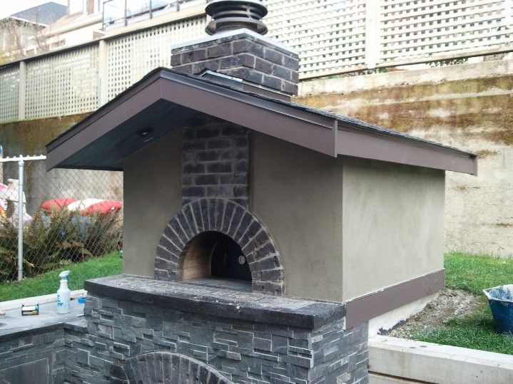

    Got the brown coat all on today. Cleaned up the brick on the arch and chimney. I think she's looking pretty good! I kind of like the taupe shade of the wet brown coat, but SO says something lighter.
    I'm headed to the concrete supply tomorrow to look for acrylic final coat + coloring.

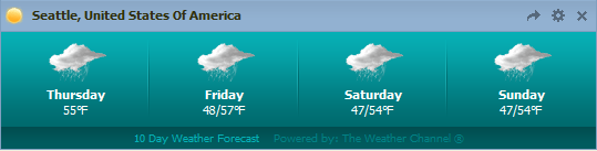

          We had our annual "spring tease" here - a week of great weather that make you think summer is about to start. Today we are slammed back into reality:

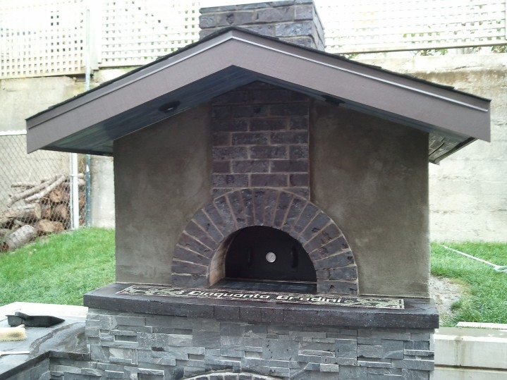

                  Got a bit more nice weather, so I was able to finish the stucco. Yeah! Now it's just a bit of quarter round trim in the eaves, pea gravel around the base, some cleanup - and I am off to the "what's cooking" section full time.
                  Here's the housing pre-stucco, all taped off because I make a mess with a trowel

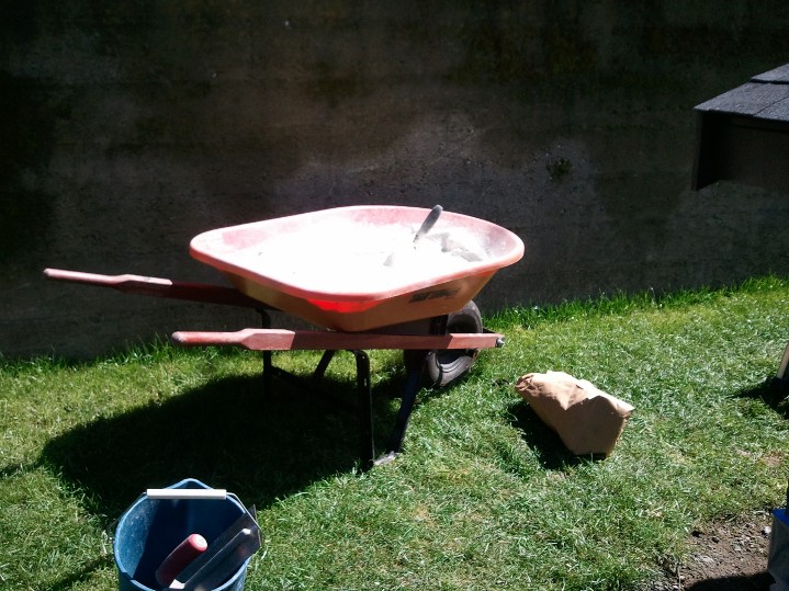

                  90lbs of stucco mix - probably 30lbs more than I needed. But it comes in bags that size.

                  And the finished product

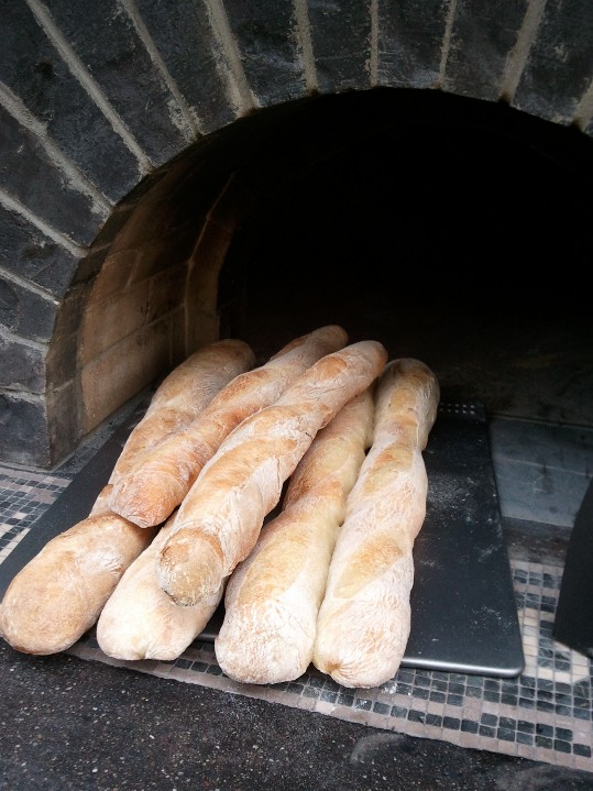

                  And just because I have one picture left - here's the baguettes I made yesterday! They came out pretty well for my first try - but I think I needed my oven a bit hotter because the crust wasn't as golden as I would have liked

                    Very nice work, it looks great.
                    Baguettes are often cooked a bit hotter and faster, they are thinner and the heat can penetrate to their centres more easily.
                    This is good for WFO's because it takes the sting out of the oven so the next batch of bigger loaves can be loaded in and cooked at a slightly lower temp.
                    I read somewhere that the pizza was actually originally a bakers snack that was cooked hot and fast before they loaded their ovens with other breads.

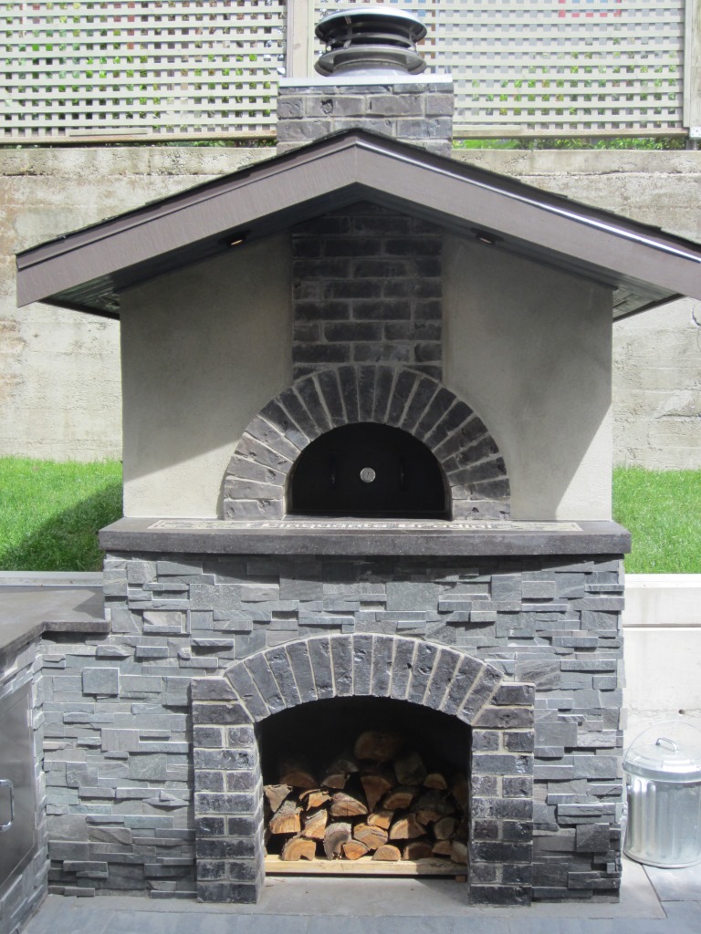

                            I got the last bits of touch-up paint onto the oven and power-washed the patio last week. With the stretch of nice weather we are having here in Seattle, I was finally able to get some higher res shots of my 100% complete oven and kitchen
ID:	294554 Click image for larger version
                            Total time elapsed on the project was about 15 months - but I took about 6 months off for the winter. Total budget was about $8.5k, but more than half of that was for the shiny stainless bits and the barbeque. Thanks to everyone for their help and guidance along the way. I'm looking forward to getting a lot of use out of this in the coming years.

                              Great job DJ!
                              A very beautiful oven which makes me think of the "F word".........Finished .
                              Maybe, one day, I can use that same word for the MQ .
                              It's fun to see a "finished" oven that I have watched from the very beginning .
                              Again, great job! I've learned from your build, and others will too.

                                DJ it looks pretty balanced with the amount of stainless, brick and stucco etc.
                                nice work
