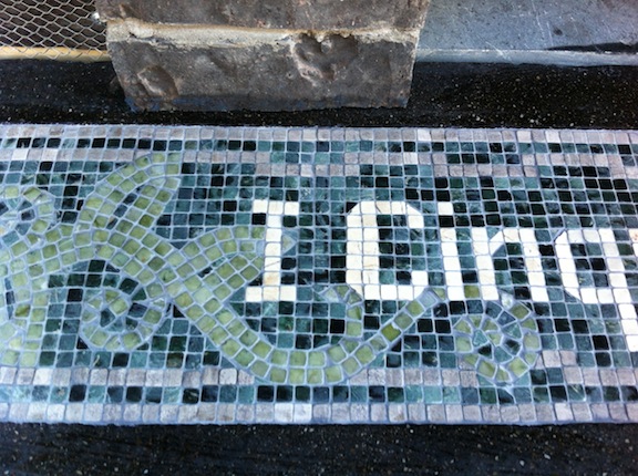

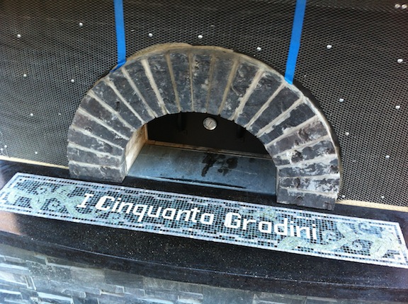

    Here are some better pics - not so washed out as the earlier ones.
ID:	293019 Click image for larger version

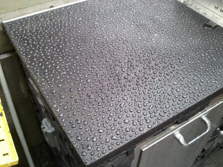

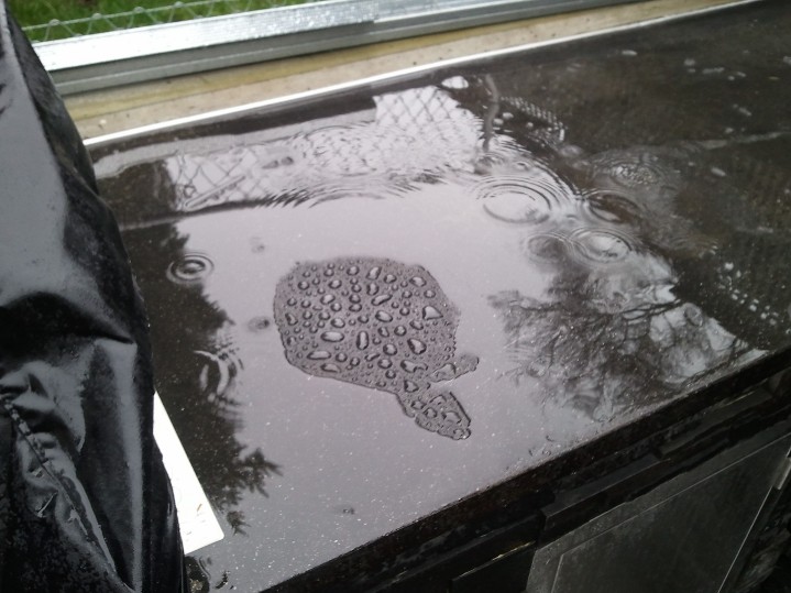

            Carnuba + Beeswax treatment on outdoor concrete counters = what seems to be a very good idea
            Counter with a full wax treatment
            Counter with only a test area waxed
            I was frustrated that the counters were so dull and dingy after the winter. Cleaned them up and tested a small patch... then a larger patch... and as soon as the rain clears up I will do the whole thing including the mosaic!
            The first wax I used was a furniture polish called Feed-n-Wax that is not exactly food safe. But it worked so well that I bought some Butcher Block Conditioner by the same manufacturer to do the rest. Both have beeswax + carnuba wax as the active ingredients. The wax really brought back the shine to the counters, and you can see how it repels water. I think I will probably need to get into a routine of applying every few months in order to keep up the appearance of the counters as the weather is too hard on them to go with no maintenance.

                #352
                Re: Starting new 36" build
                Beads up like no tomorrow, I have used a water based sealer on my granite counters,they are still shiny but do not bead water like that.
                I have a cutoff I think I will try a wax treatment to see how it holds up. I can put thr cutoff in full sun and weather to give it a good workout.
                Thanks for this update.

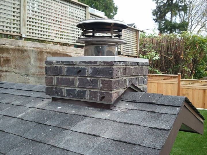

                            More progress to report:
                            Got the chimney tuck pointed. That was much easier than I expected, and actually kind of fun! I just need to do a bit of cleanup with muriatic acid. I found a great video on Youtube that showed how to do this.

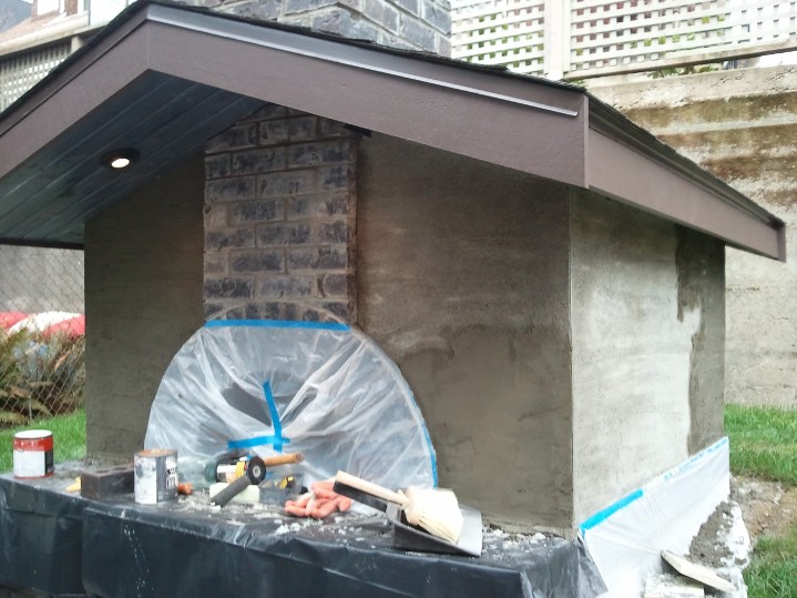

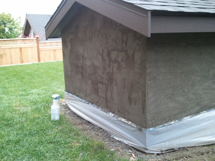

                            I am 1/3 of the way through the brown coat on my oven house. Again, it is not as bad as I feared. I am taking it a bit slow - going as far as I can with a bag of mortar each day. Masonry experts, please tell me if I am making any huge mistakes, but let the little ones slide . I used s-type mortar for both the scratch and brown coats. Stuff that I picked up at HD that says "use for scratch and brown coats" on the bag. Hope this is right. Seems fine. I've applied about 1/4" for each coat. Takes about 1 + 1/2 bags to do a coat.

                            I do have questions about the final coat. What do I use there? Is there something with an additive that offers better water resistance? And what about pigment? Can I mix the color in instead of painting? Does that start with white mortar so I can do lighter colors? I haven't really research yet, so thought I'd just throw those out there.

                            • brickie in oz
                              • Mar 2009
                              • 3445
                              #359
                              Do a google for acrylic render.
                              It comes in a variety of colo(u)rs and is water proofishish.

                                #360
                                The guys i hired for stucco used the cement based mortar for scratch coats and then used synthetic (acrylic) like brickie said. The builder supply place where i bought it said "nobody uses real stucco anymore for final coat." fwiw The stucco guy agreed and said the synthetic is better and lasts, and easier to apply.
                                It was an El Rey brand and you can pick the texture and color to your taste.
