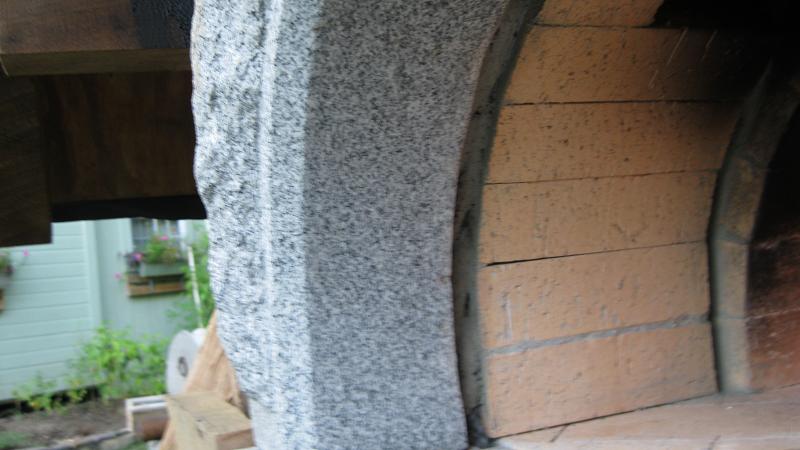

    Worked well Bruce, you should have no trouble with this.
Name:	IMG_1594 gasket slurry.jpg

      Re: 36" build in Tallahassee - AKA Bruce's Folly
      [ATTACH]37395[/ATTACH]
      Wow, that is amazing, it matches the granite and is very smooth. What was in your slurry and was that applied in multiple layers?
        Just Portland and a diluted acrylic mix....9:1. That is two light coats...keep a bucket of water and a sponge handy to remove the slurry off the brick as you work.
          Lowes has QUIKRETE Concrete Acrylic Fortifier (Shop QUIKRETE 2 lbs Concrete Acrylic Fortifier at Lowes.com). Is this correct?
          Also, I understood your instruction to be a mix of opc and acrylic (no water). Just checking. Is the 9:1 ratio 9 parts opc to 1 part diluted acrylic?
            Oops...no 9:1 was the dilution ratio of the liquid..9 parts water, 1 part acrylic.
            That quickcete brand is different than what I have, just cut it by 50% and that will be fine.
            As far as what quantity of opc to add..it's not critical. If you make the slurry like a milkshake, you're good. You just want to make sure there is enough porty to coat the insulation. If it is stiffening up just add a splash of cool water
              Oops...no 9:1 was the dilution ratio..9 parts water, 1 part acrylic.
              Thanks, should be able to try out this afternoon. I finished up the smoke chamber yesterday.

                              They are in the midst of building their first store. Should be opening in a few months. Thanks for the tip.
                              Well I have 3 coats of slurry applied now. I added a small amount of terracotta cement color because I thought it would blend better than grey.
