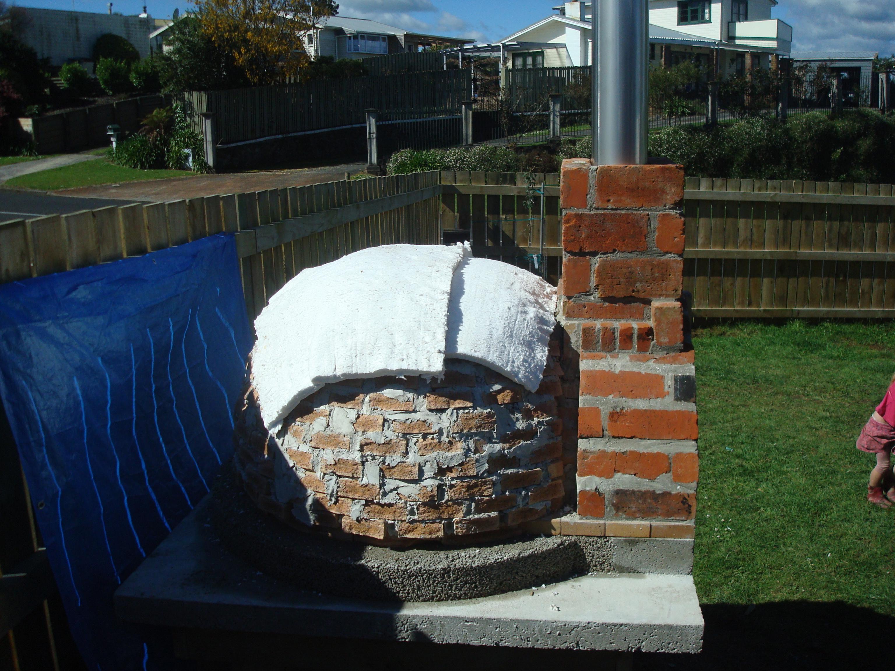

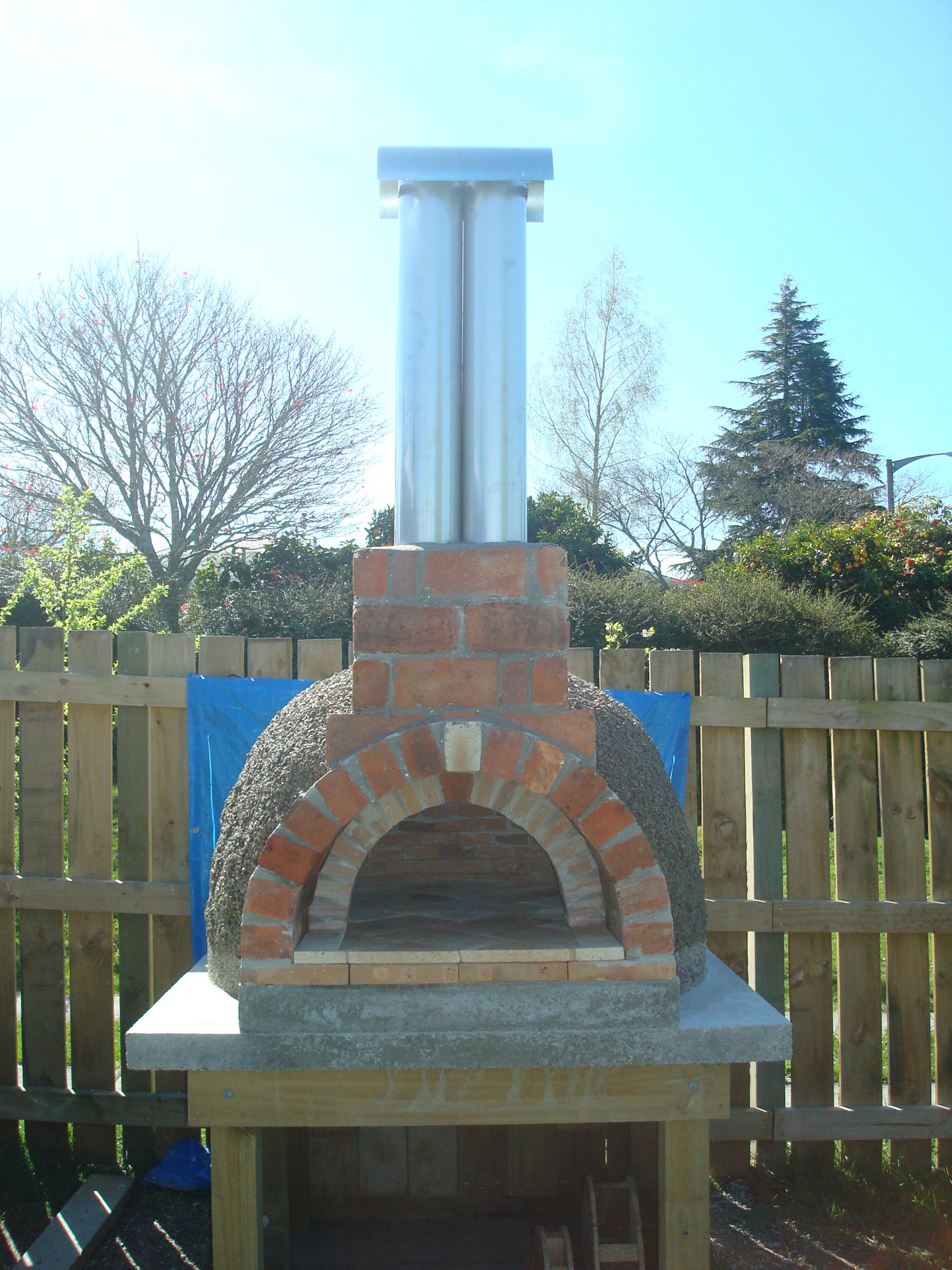

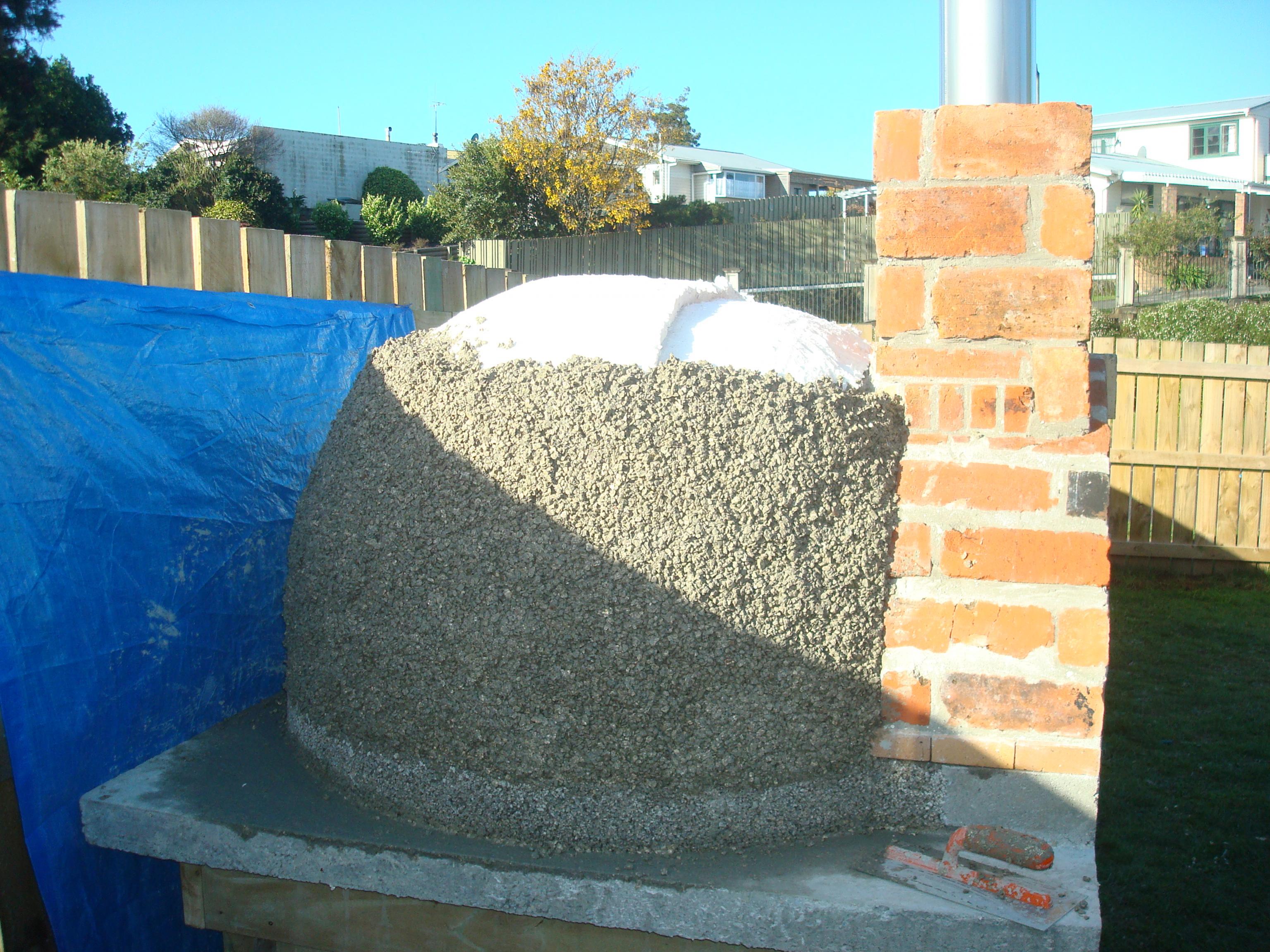

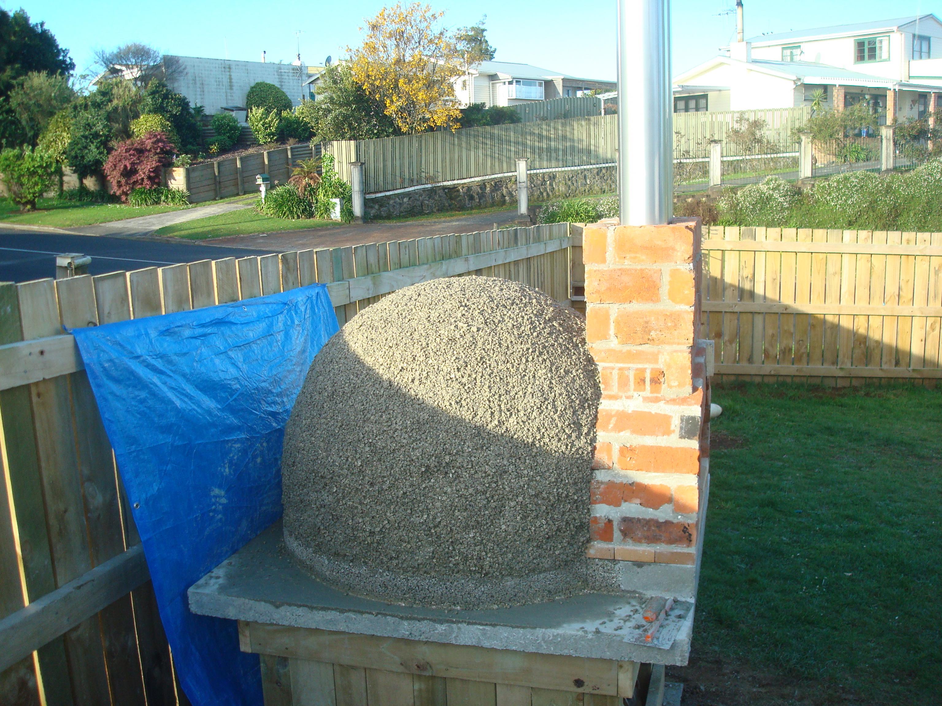

                I tackled the insulation today. Possibly the most frustrating part of the build.
                I choose course vermiculite for the best insulation (best vermiculite) and it was a major chore to try and vet it to stick vertically on the dome. I emded up adding a small amount of fire clay to the mix to try and help it stick.
                I doubled up my ceramic blanket on top of the dome as it seems like the most likely place to focus the insulation on.
                I also have much more vermiculite on top of the dome. Perhaps 5" + 2" blanket.
                The sides are about 3" vermiculite. A bit on the light side, but such is life.

                  #143
                  Re: Budget Build 36"
                  Gudday Bevan
                  May have been a difficult job but you have done well and that's as neat a job as you could ask for!
                  I'm feeling a bit cheated here I was looking forward to seeing you make that pumice stick never seen anyone use it that way.
                  Seems the strange chimneys with caps are now explained. If you look at the last photo you posted you can clearly see some cement fence posts with caps on a property behind the photo .

                    #144
                    Hey Dave, The pumice would have been a nightmare as it is very heavy compared to vermiculite. I do think it was fantastic as the base insulation though as it has no give/bounce like the perlite or vermiculite.
                    I have decided to do another bag of vermiculite as well, I don't want to lose the round shape of the dome and have a lumpy mess, so I might try and make a straight sided form for the lower 12" and that might work.
                    I think I may start curing tomorrow afternoon... hmm, will see how bored I get!
                    Bevan
                      • 9213
                      #145
                      You'd be better off to wait until the vermicrete dries before either lighting fires or adding another layer.
                      You can get a surprisingly good surface and form if you tap the vermicrete lightly with the flat of your trowel after placement.
                        • 5262
                        #146
                        I made a curved trowel to assist in keeping the round shape when I installed my perlcrete but a flat trowel works just as well.

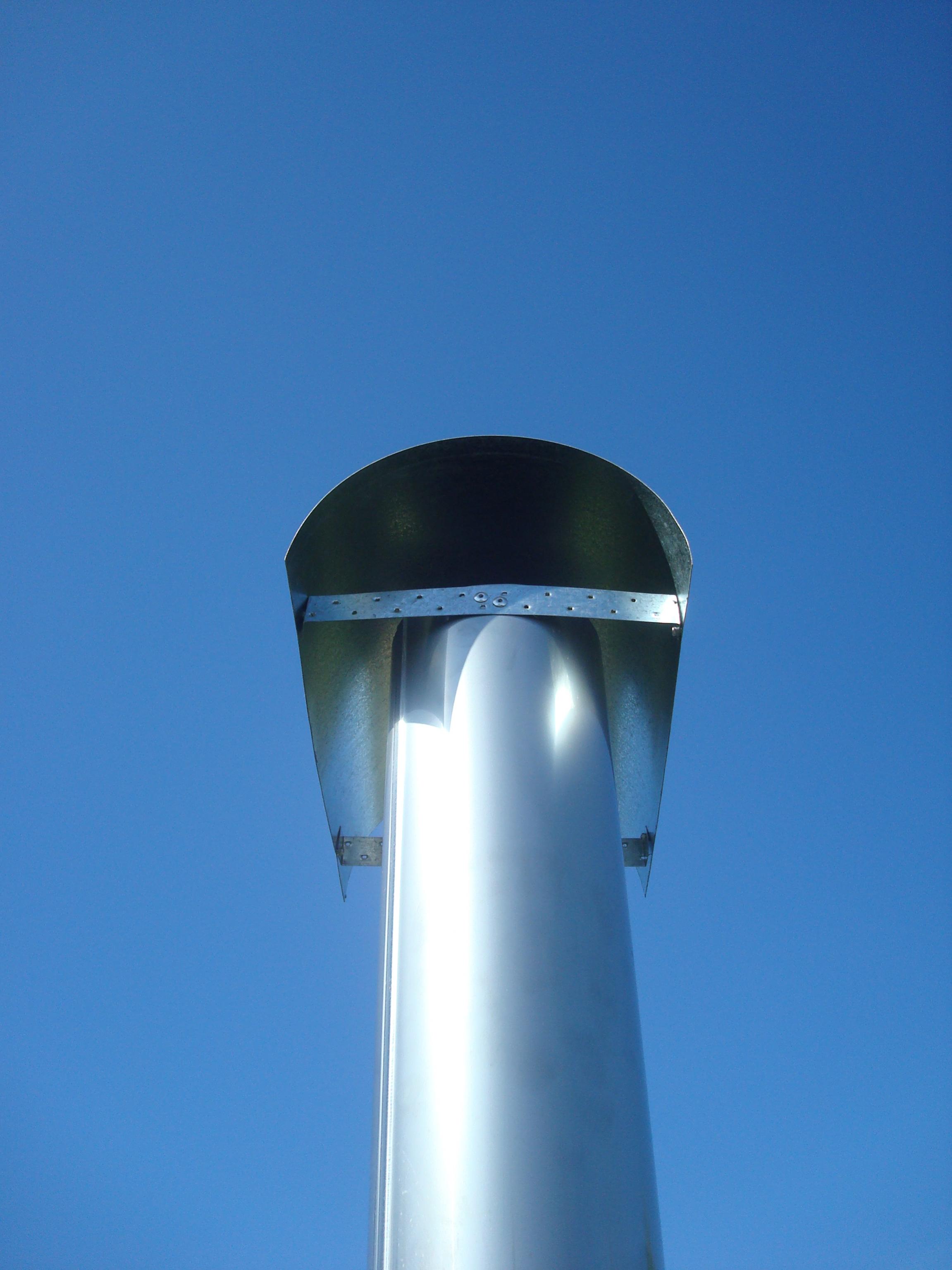

                            I cut some bricks to slot down in the chimney around the flue. Then I filled the flue with vermicrete and capped with poor man's mortar. I am thinking I could stucco on top of that and use some high temp sealant around the flues?

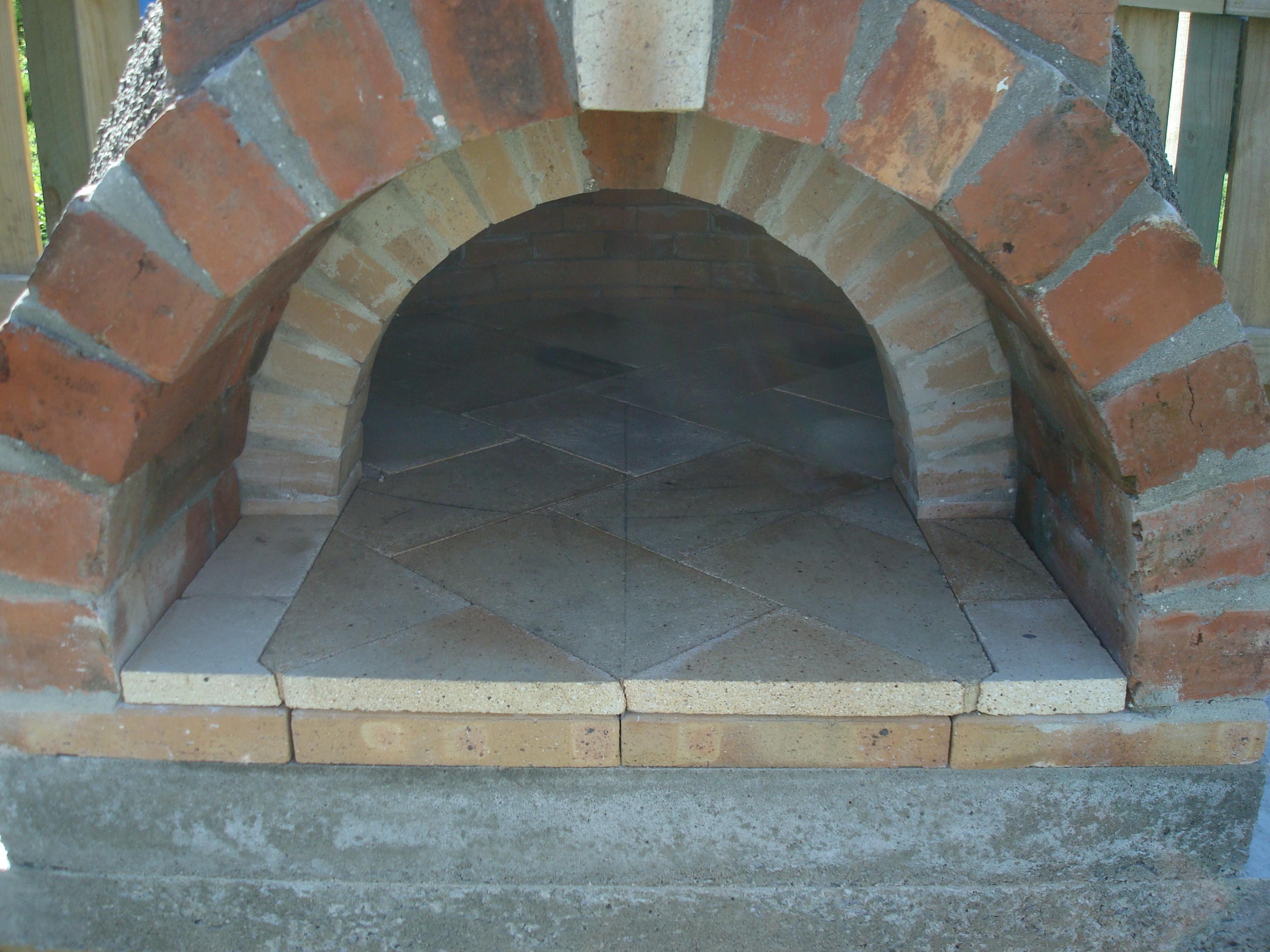

                            Also, does anyone have an idea for my floor tiles... I want to stick the front row down so they don't fall off. What would be the best for this? I guess the temp at the front will still be too hot for a dab of construction adhesive?

                              #149
                              Gudday Bevan
                              How long?..... I don't know.
                              You base slab is only 3 weeks old . It's certainly not dry as you put a layer of pumise cement over that the next week and its not dried as you have added a hearth and an oven and a insulation layer.
                              Like I said before ALL of the water you have used in the construction is still there! The cement may have hardened and partly cured but it does mean that the moisture is still there . Cure is a chemical reaction not drying out.
                              Put a spot light in there and warm it through. Slowly.let the wind and sun help.
                              We are coming into summer and the warmer wheather let it do the job. Slowly.
                              I wouldn't think about fire for a coupla weeks .... And then only twigs.
                              Simply and truthfully if you try to fire that baby, your work and money will just go down the gurgler..
                              Regards Dave
                              PS and that means NO more insulation Yet!!!!

                                #150
                                Well I went ahead a got a fire going...and then DISASTER!!
                                Kidding! I am waiting patiently. I have turned my attention to far less exciting tasks such as the lawns and garden. It is spring here and I have lots of seedlings ready to plant. So I am killing time building trellis for tomatoes and cucumbers etc.
                                The problem is that the oven won't stop looking at me, it is right outside the french doors. I feel like a neglectful parent
                                Not to harp on with stupid questions, but what did you guys think I could use to stick down my front row of floor tiles?
                                It's Friday today, so if you are firing up your ovens for pizza tonight, have a slice for me!
