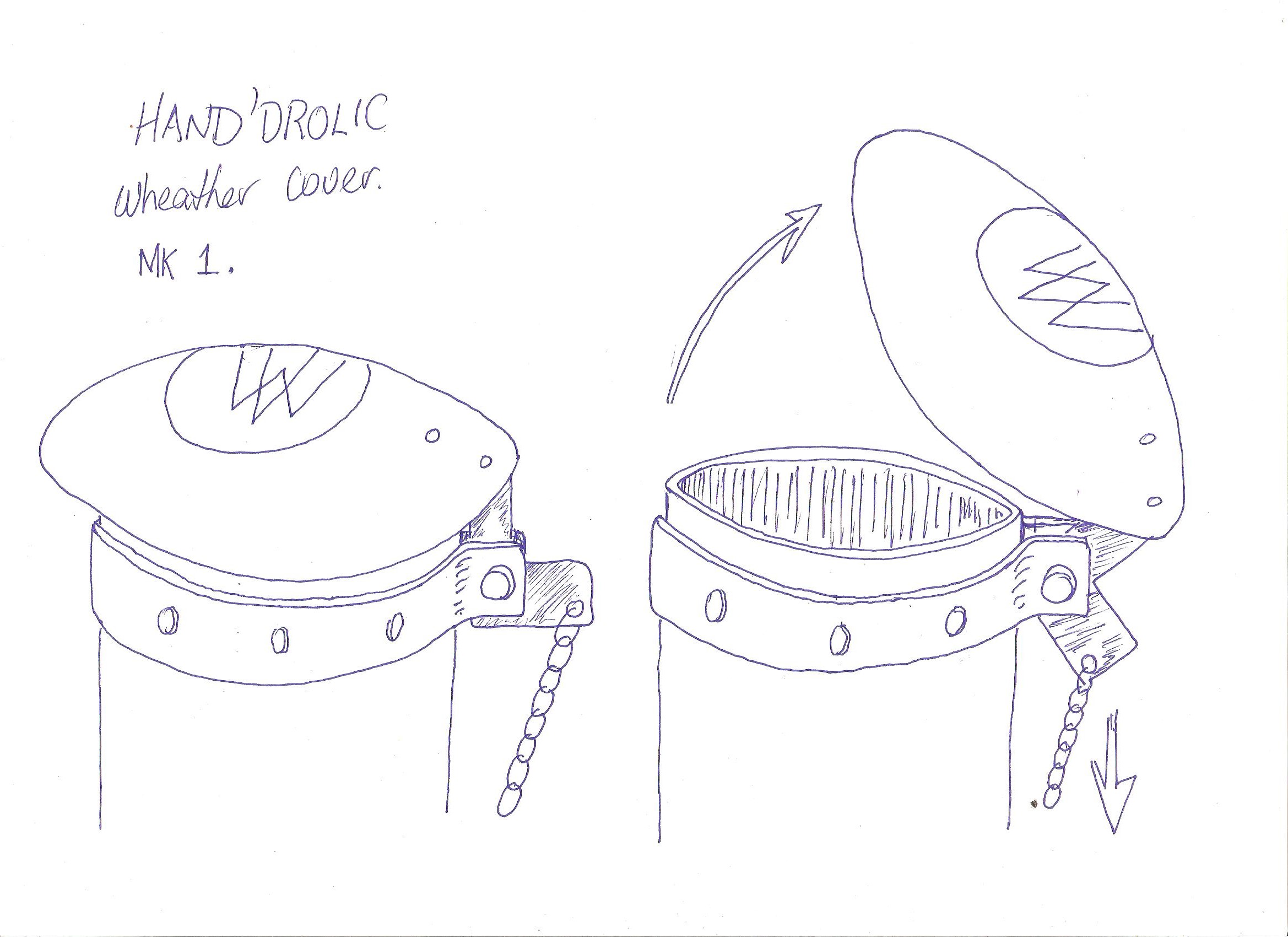

            Would this suit
Name:	chimney cover 001.jpg
            just something for you ideas bin
            Regards Dave

              Re: Budget Build 36"
              Awesome Dave! Thanks so much for putting in the effort
              Can I use the 150mm stainless as the inner and the 200mm galv as an outer do you think? And then do the hubcap hinged top.
              Thanks again,
              Bevan
