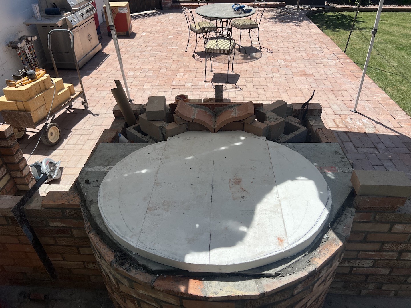

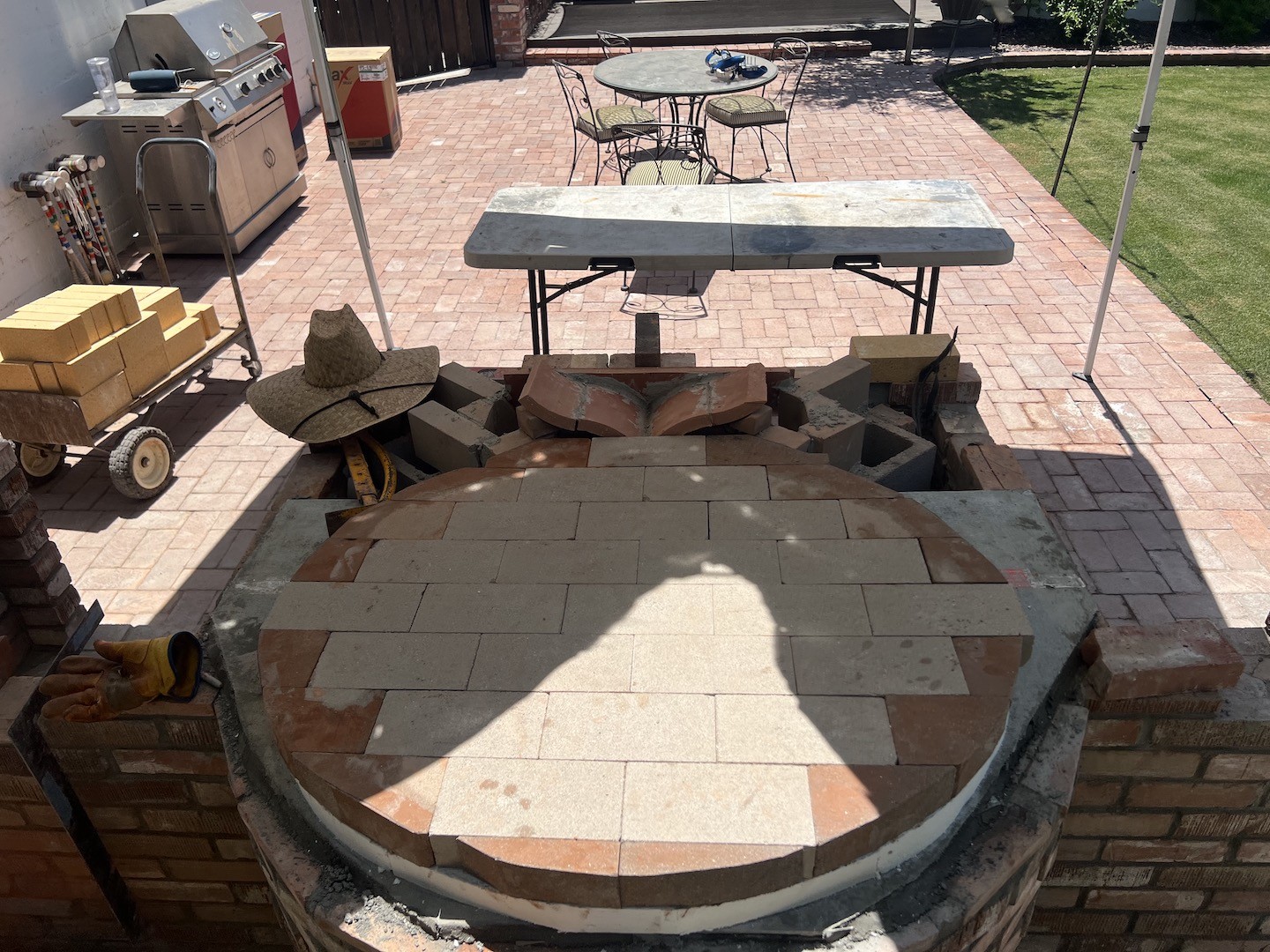

    Great point! If you look at the picture with the insulation, you can see that the chimney split for the fireplace is not under the actual oven. I hope we are OK!

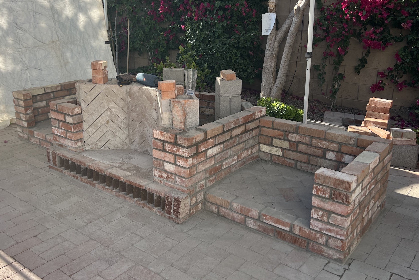

    Yes to both. Concrete with rebar for the supporting walls. I used 2" ceramic board under the oven with sand set firebrick on top. I attached a couple of build pics.

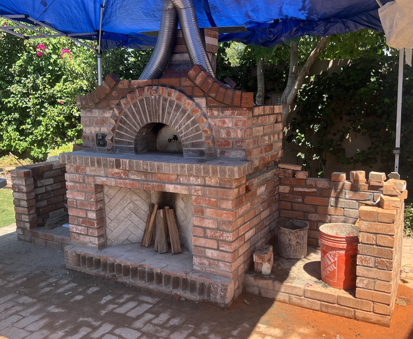

    Hi Forum,
    I am almost finished with my second Fireplace/pizza oven. I took a different approach this time. A Rumsford fireplace on the bottom with a 32" Pompei style oven on top. I achieved this by splitting the chimney of the Rumsford around the entry to the oven. Both flues are separate but encased in one chimney shape. So far, test firing has had excellent exhausting of smoke. The oven cooks perfectly and holds heat of 300 degrees for 3 days.
