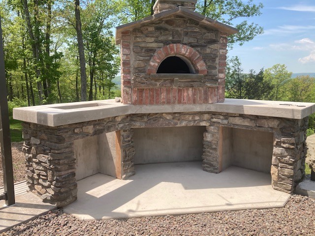

              Thank you for posting...your oven looks great. we had limited space but i can see what you are talking about with wanting larger counter tops (and beer tap).
              I am a little behind on the update and we are installed. cured the oven and cooked our first two batches with some success. looking forwarding to getting my new mixer so i can perfect the dough.
              Let me know what you guys think.
