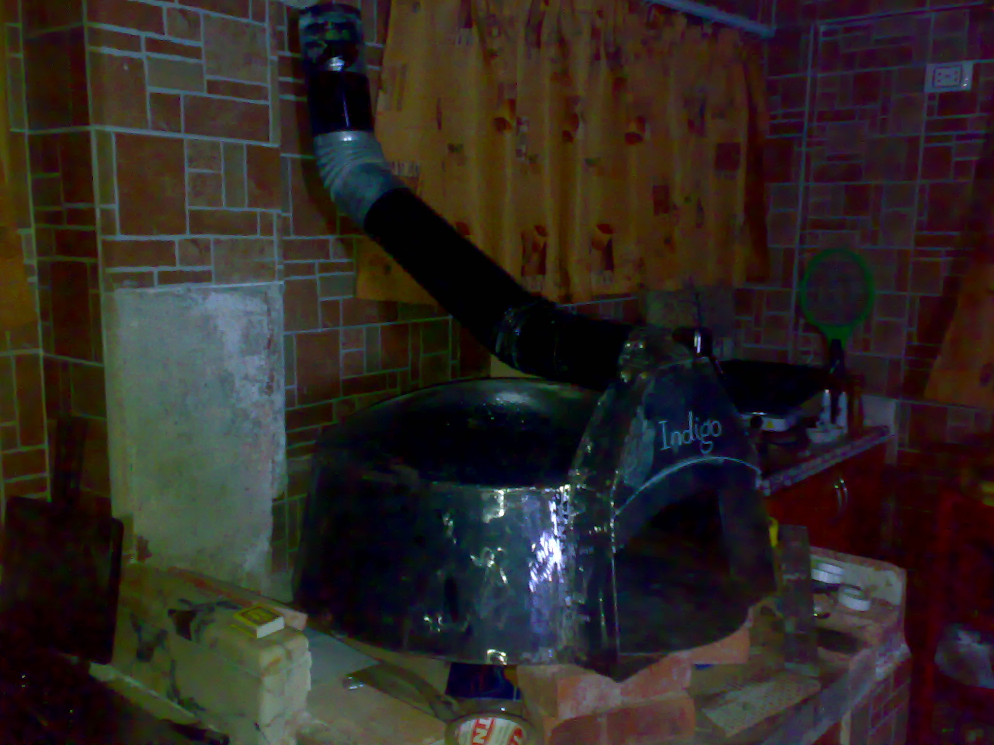

            Since I am going to enclose the oven and the flu as it is an indoor one, replacing the flu in case it wears is not an option.
Name:	More vertical flu.jpg
            The one in the picture above will not live for long. It is less than 1 mm thick. Thus, I'm going to replace it with a thicker one. I wasn't lucky to find a flue of 2 mm thick steel. I found 5 mm thick one available. I am afraid that is too thick for the application and may suck up lots of heat.
            Do you think that a flu with a thicker wall will affect fuel efficiency provided that the contact area with the vent top is the same in both?

                Yes, a thick steel flue connected to the rest of the steel oven will suck heat away because steel is so conductive. I think you would be better off using a thin walled (0.55 mm), but stainless steel flue pipe that won't corrode, but won't suck much heat out of your steel oven.

                  I am considering cladding my oven. I have two options; cladding the entire dome, and cladding just the covex cap without the side walls. According to the q=c m dt law, the second option saves half the heat up thermal energy and time, being saving half the extra mass (m). The first results in 90 kg extra weight, while the second results in up to 50 kg. Something's telling me that things are not bound proportionally i.e. the 90 kg will not require twice the heat required to saturate the 50kg (even if the law states that), Another thing is telling me that they are quite peoportional that with the 90 kg I will end up with amassive oven that will take a while to clear.
                  My math sayes that the first option will require up to 6.6 kg wood to clear while the second will require up to 4.2 kg dry wood. In practice I hope to drop below 2 kg of wood which still looks vage to achieve.
                  In both cases, my oven is still light compared to brick ovens its size and should be more efficient, but that still is not the efficiency I have been seeking. I prefer to refer to heat up effeciency in terms of the weight of required wood rather than heat up time. my goal is to accept the maximum thermal mass that lets the oven clear in less than 2 kg of dry wood.
                  Any comments are truly appreciated.
