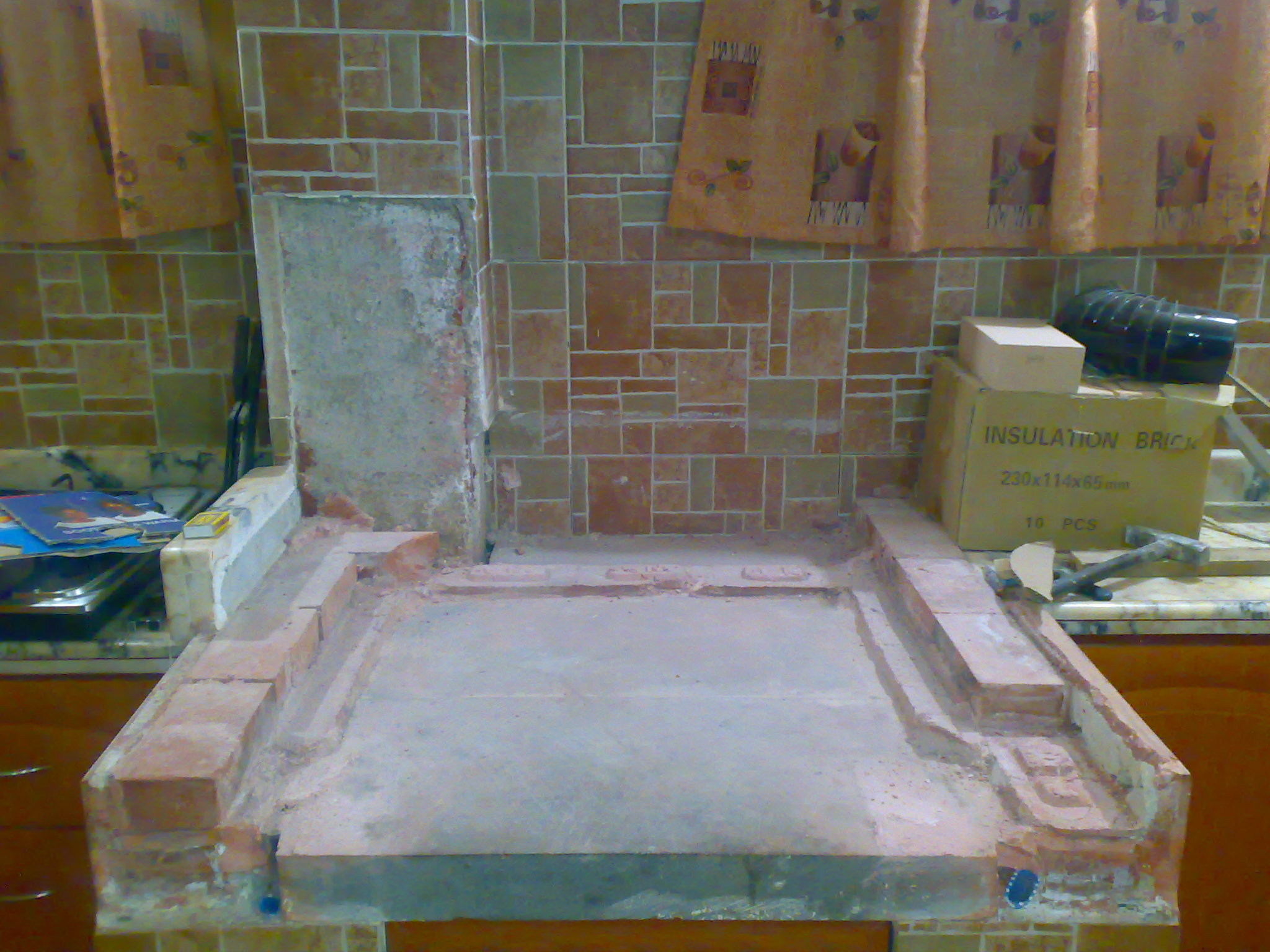

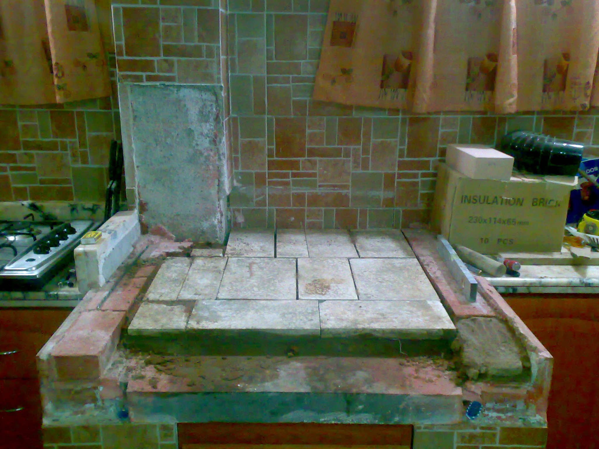

      The oven was planned to finish tomorrow which is the Lesser Bairam. I wanted to make some traditional Bairam bakery in the oven and share them with the forum. Unfortunately the finishing was delayed for reasons I don't have control over.
      I?ve been trying to stick to the plans of construction. They suggest 100 cm as a height for the cooking floor (which feels the most comfortable). I modified my slab and raised it to the desired height using these floor tiles that I found in the garden. Laying the tiles was not that accurate being almost my first masonry job. When tried laying some insulation bricks over the tiles they were a little bit shaky. Is laying a thin layer of sand or clay over the tiles useful to make the insulation bricks steady?

        #93
        Re: Brick oven reconstructed to a steel one
        G'day
        50 /50 powdered clay and sand, add water to make a stiffish paste. Apply with a notched tile trowel. When you put the bricks in position the sides of the brick must first touch, then you drop them down. If you drop them down first then try and push then together your paste will build up and seperate the brick. Tap then down with a rubber mallet if not a block of wood and an ordinary hammer is just as good.
        If the surfaces are drawing the moisture out of the paste a smear of margerine or cooking oil will provide a temperary barrier. Might not be needed inside out of the sun. See what happens
        Regards Dave

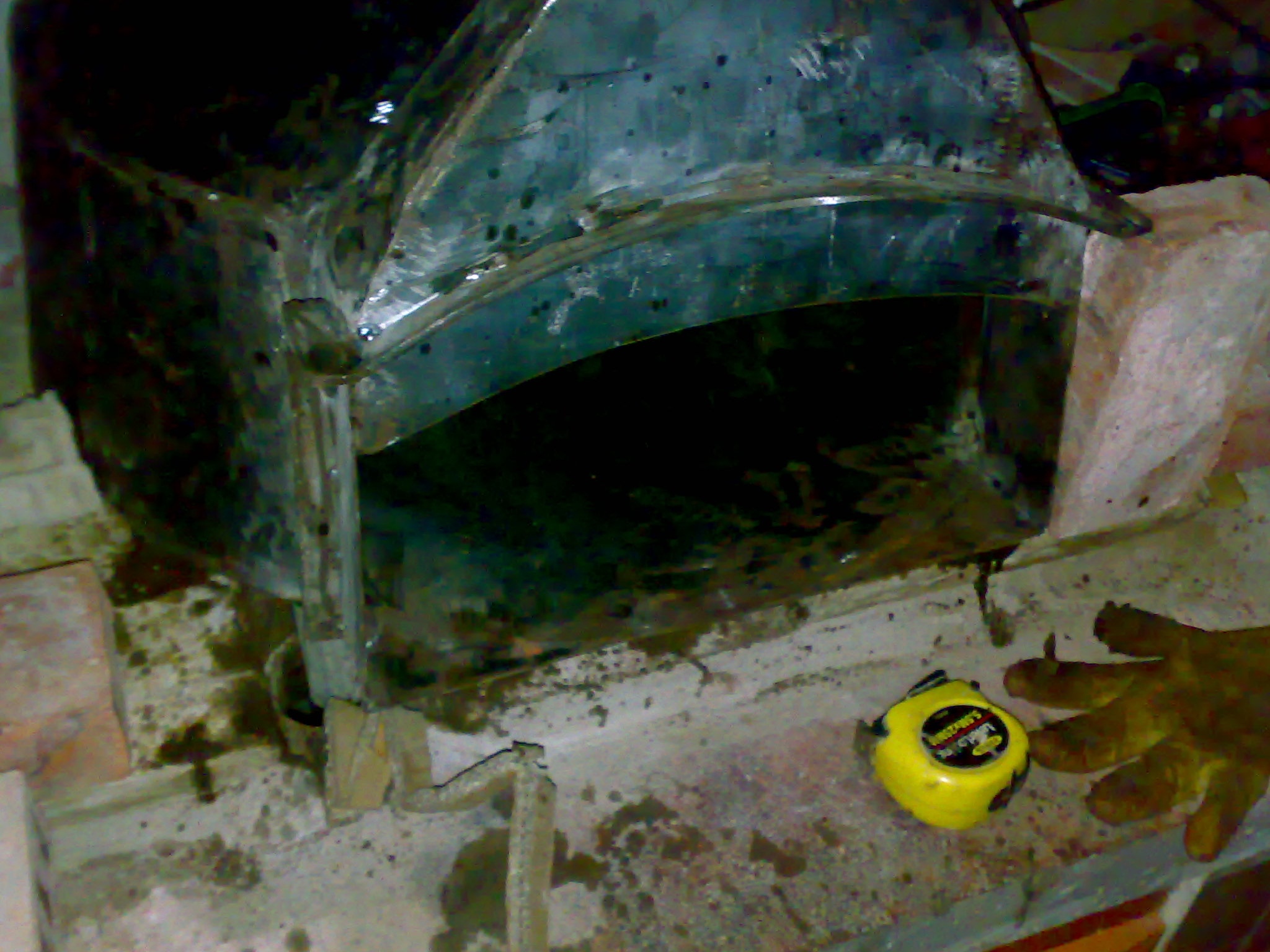

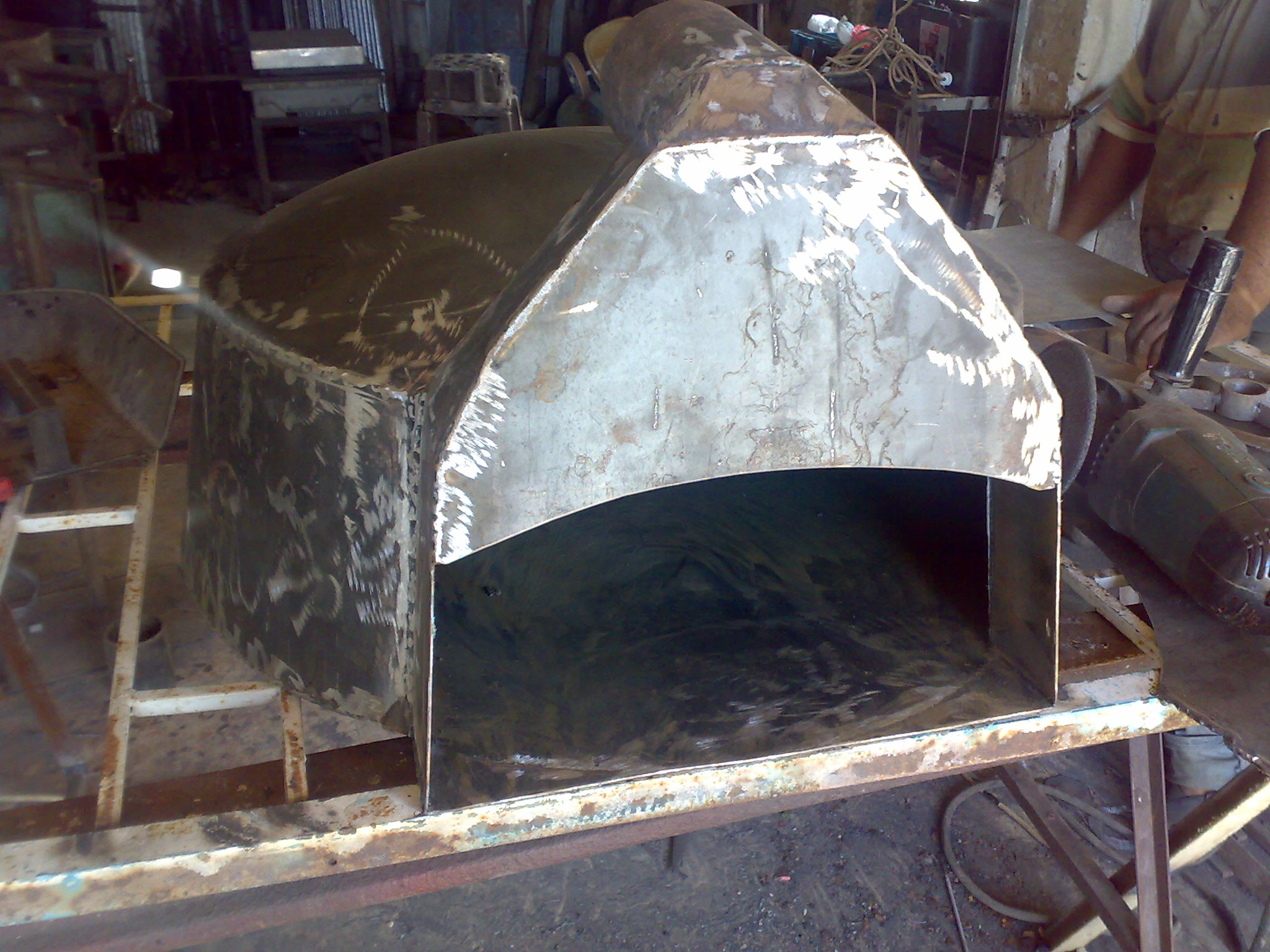

                      One of the things that still puzzling me is how to make the ends meet between the steel and the decorating bricks.. The steel arch looks like this in the picture
                      I welded this rim all around the oven opening in hope of providing a sort of sealing base where the arch bricks can lay on (for the top bricks) or engage with (for the side bricks).
                      My first thought is to slit the side bricks so their slots engage into the metal rim on the two sides, and let the top bricks lay on the upper part of the rim in order to achieve some sealing and/or integrated structure. But I don't know how to prepare for the inevitable different expansions of steel and brick!!
                      I forgot who said that.
                        #101
                        G'day
                        Why not insulate between the brick and the steel ? Otherwise you'll loose heat?
                        The expansion joint would be there as a bonus.

                          #102
                          Hi Dave,
                          Do you mean to insulate with the ceramic blanket? I just wanted to get an integrated structure. My oven weights about 20 Kg, so can't depend on gravity to get it fixed in place. After your suggestion, I'm thinking of fixing it in place with two screws, and building the brick shell as a distinct structure, insulated from the steel structure by the blanket.
