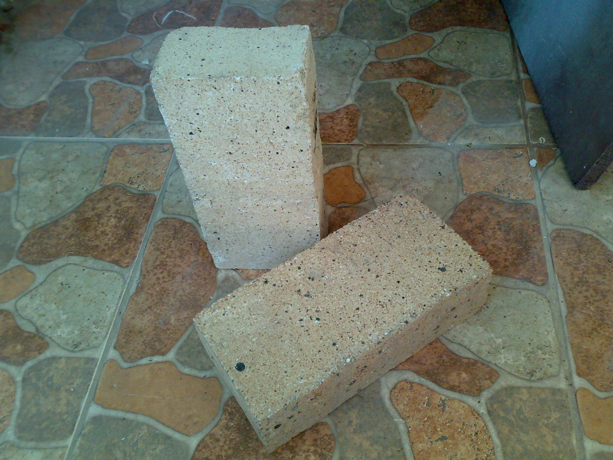

                          Hi mates,
                          My project has been delayed due to lack of materials, and I have been trying to get calsil bricks for the hearth for more than a month now.
                          I ordered the bricks after being assured by the masonry supplier that they were insulation bricks. They arrived today, but to my surprise, I found them not like the WHITE calsil bricks I used to see on the site. Rather, they looked like fire bricks!!!
                          Please tell me if these were insulating bricks or what ????
                          They are (11*23*6.5) cm, and they are about 2.5$ each.
                          I forgot who said that.
                            #43
                            Re: Brick oven reconstructed to a steel one
                            G'day
                            It all comes down to weight so the pics don't help that much .
                            If its as heavy or heavier than a house brick ... More likely a firebrick.
                            If is really light in comparison to a house brick .. It should be an insulation brick.
                              • 9212
                              #44
                              Insulating fire bricks are a different material to calcium silicate insulating board. If the bricks are really light then they should be IFB's, if they're heavy, about the same as a solid red clay brick then they are probably dense firebrick.Looking at the pic, they look like dense firebricks to me.
                              • v12spirit
                                • Nov 2011
                                • 466
                                #45
                                david, dave,
                                with the dimensions provided, how much must each brick weight? I'm gonna weight them to know what kind of bricks these are.
