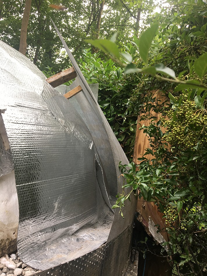

    Originally posted by david s
    An aluminium foil bubble layer will be impervious to water. This will have the effect of trapping any moisture beneath it which may cause you further problems.So take it easy with the fires and don't rush to pizza temperature for some time. Do plenty of roasting and baking at lower temperature first.

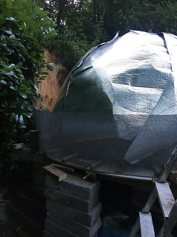

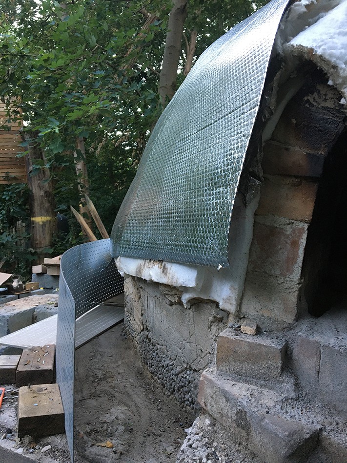

    You are correct. However I needed a protective layer for the ceramic blanket while it remains exposed to the elements since the galvanised mesh remained un-tiled for 8 months! Meanwhile, I left the bubble aluminum sheets layers overlapping loosely to breathe rather than water tight completely.

    Originally posted by Alomran
    Following adding 100mm of ceramic blanket, an aluminum bubble insulation was added, then created a space for the 250mm pumice. This may appear to be an overkill, however the oven exposed to the elements due to local regulations that made it impossible to shelter the oven.

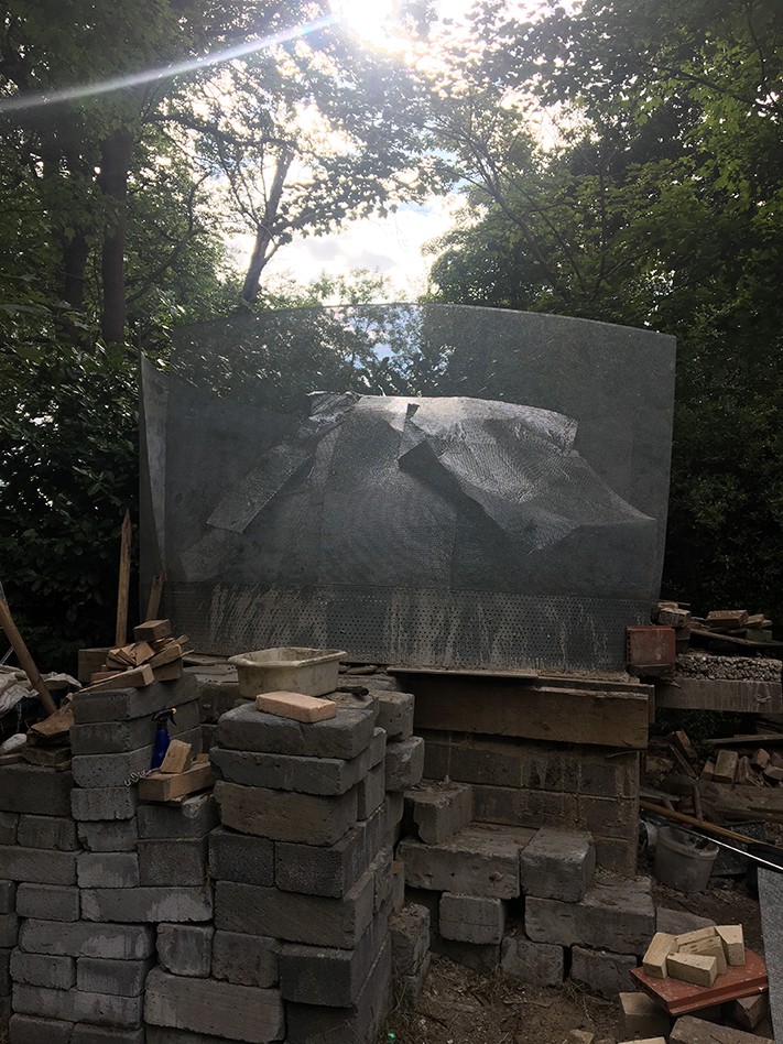

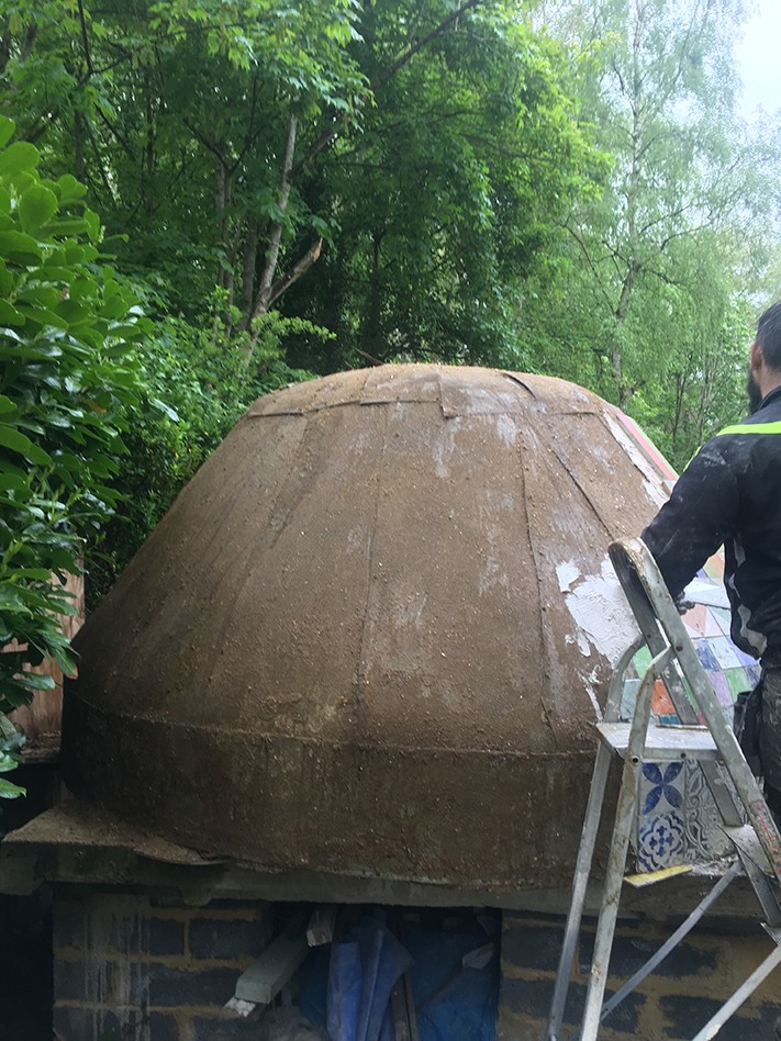

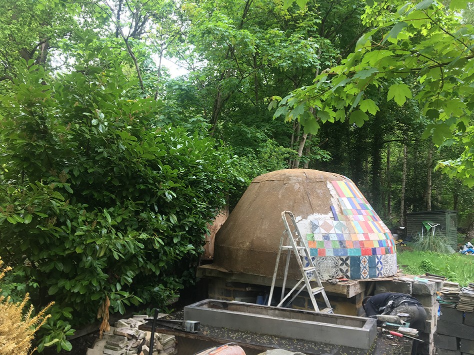

    After realising that no render or tiling can be fixed on any galvanised steel, a layer of Ardex R3E epoxy was added then a layer of sand was sprayed . Then after the epoxy was cured, I cleaned the sand to leave only the one stuck to the epoxy in order to establish a grip upon which I did the tiling. My Romanian friend Adrian carried the difficult task of tiling (partially).

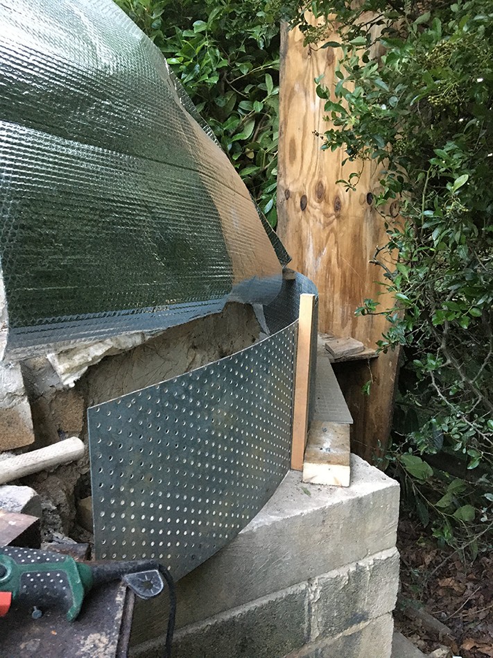

    A galvanised steel mesh was used to create a shell that contain the loose pumice. Then realised that I couldn't render or tile immediately on galvanised steel mesh as it won't stick. So I added a layer of epoxy Ardev R3E, then placed immediately sand on top of the epoxy to create a rough surface upon which tiling was placed. Very Expensive!

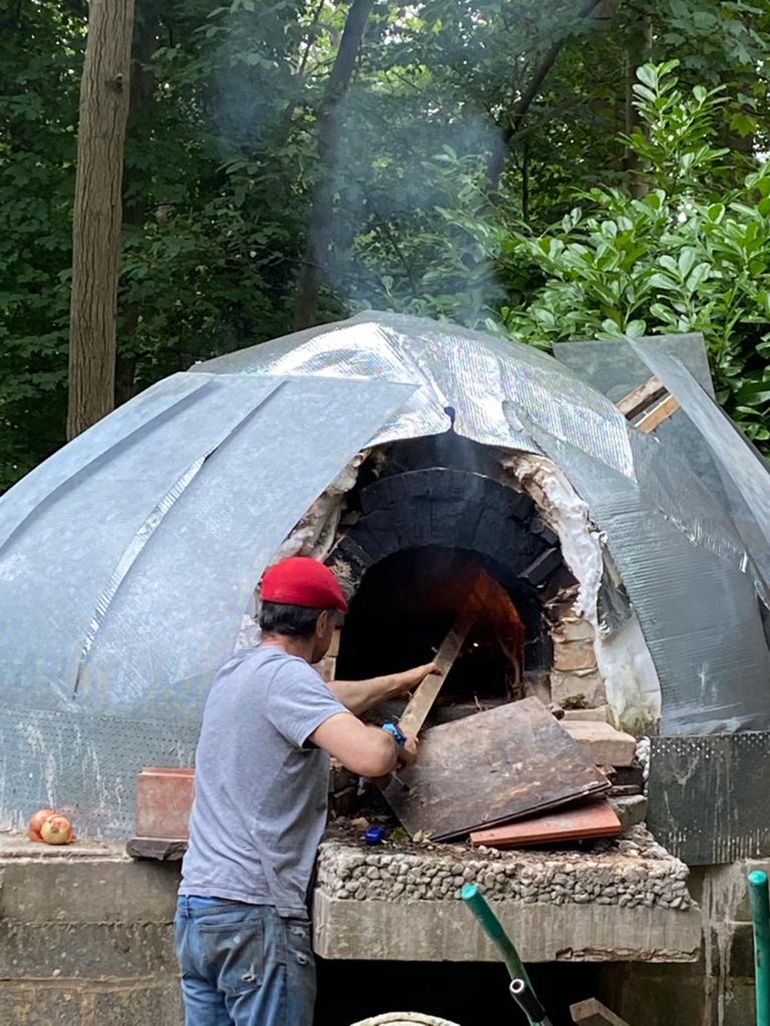

  • Alomran
    replied

  • Alomran
    replied
    Given that the internal dome is 98cm in radius with a full brick in thickness (230mm) making the external shell of the sphere about 9.5 meters which is very expensive to insulate with ceramic blanket, would it be sufficient to have 1 inch of ceramic blanket and compensate that with 6 inches of pumice with vermiculite?
    I have enough pumice to make it about 6' or even 8" inches thick. ALso, would fine wood ash be ok to be added to cement to make it workable ? I know ash is used in old cultures of the far east when mixed with clay as a waterproof.https://www.youtube.com/watch?v=mn1DEeyqaT4
    Leave a comment:
    replied
    If you already have blanket one layer should be sufficient. To get the correct consistency for every 10 parts of vermiculite(or perlite) add 3 litres of water. If you have some powdered clay a handful of it for every litre or so of cement will give it mor workability.
    Leave a comment:
