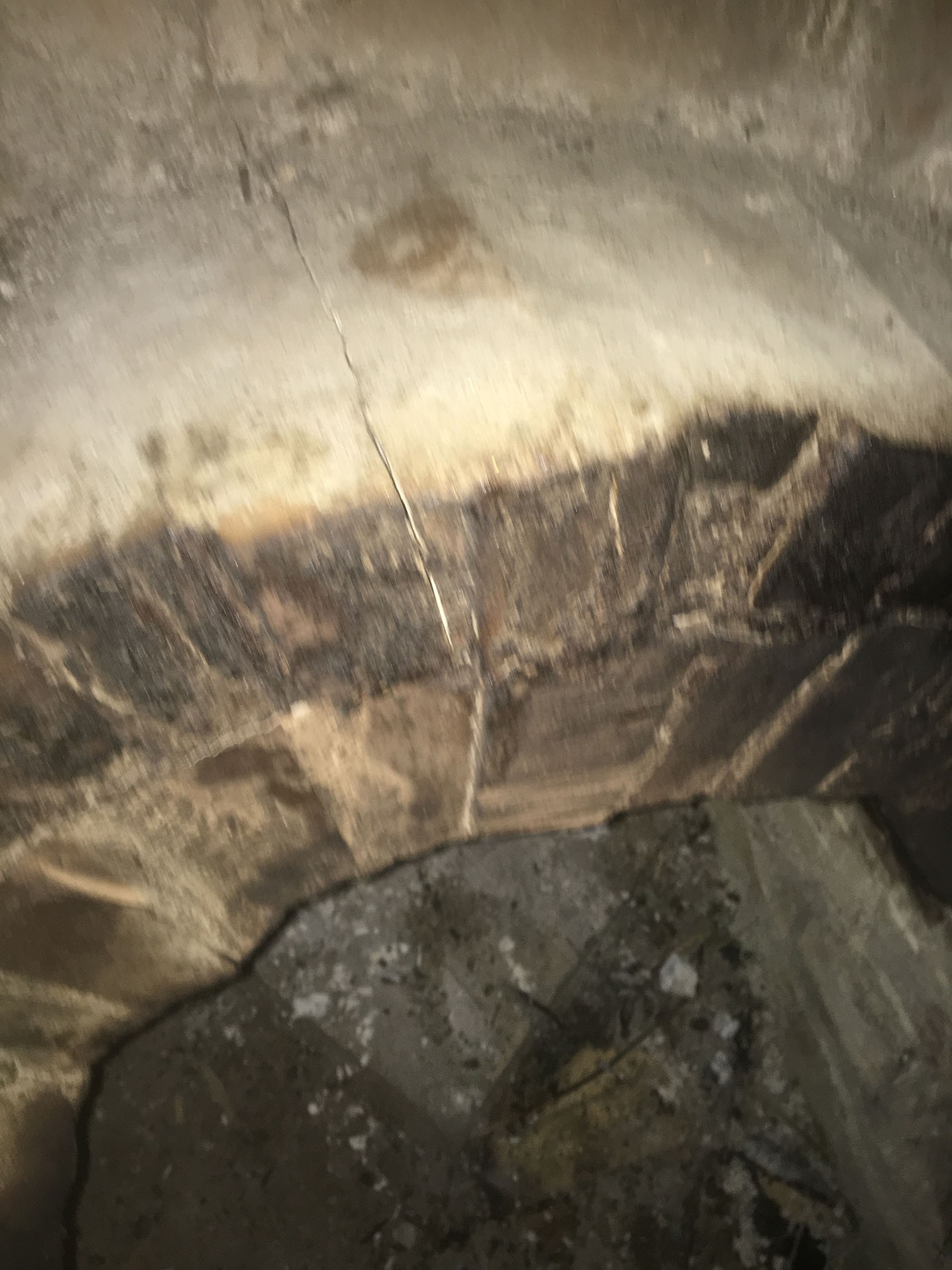

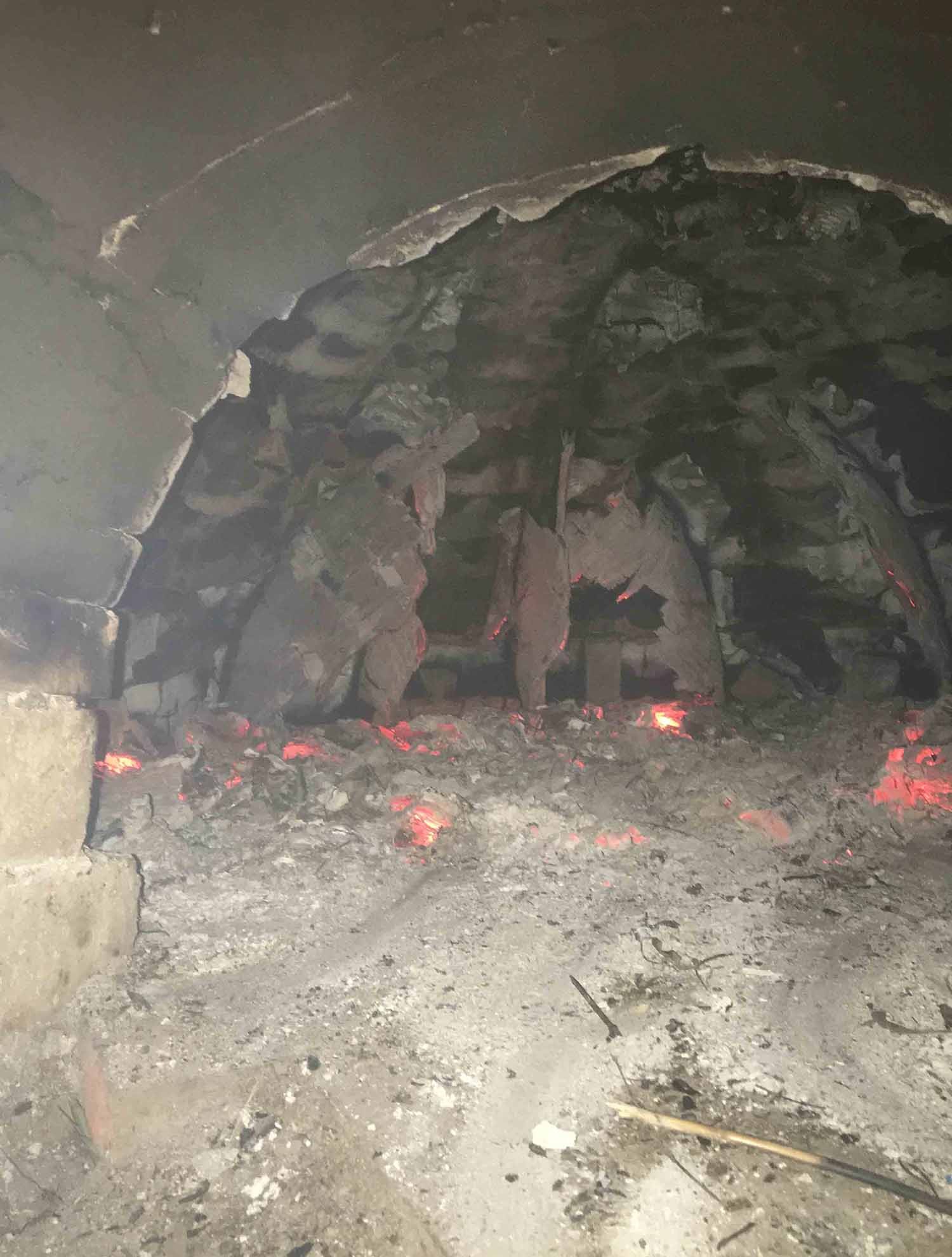

I opened up the entrance to the oven and have found that all the wooden frame shaping the domes were soaking wet.
With the inside absolutely soaking wet from years of accumulating rain, and out of excitement I'd decided to start a small curing fire using a handful of twigs only to dry up the wood thinking which was soaking wet. This is since flexible plywood upon which the firebricks is sitting on was almost rotten from dampness as well as the structural ribs holding the sphere form were also very wet.
With plenty of water on the side in case of uncontrollable fire occurs,I started the small fire and for about an hour it was going OK with plenty of steam coming our of the timber frame. Then my family asked me to join them for a late snack leaving the small fire unattended thinking the wood was far to wet to be inflamed by fire.
After returning back to the curtilage, I have found that the structural wooden frame inside the oven was fully inflamed !

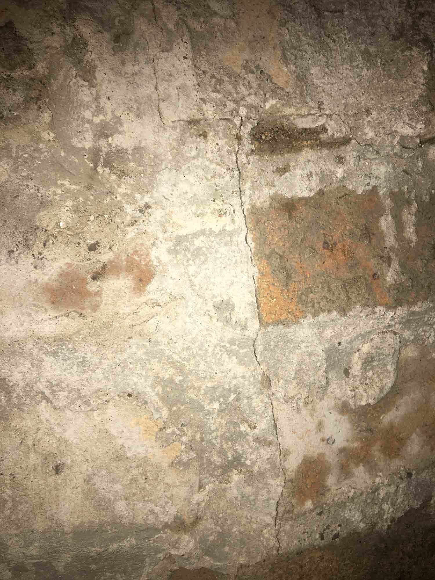

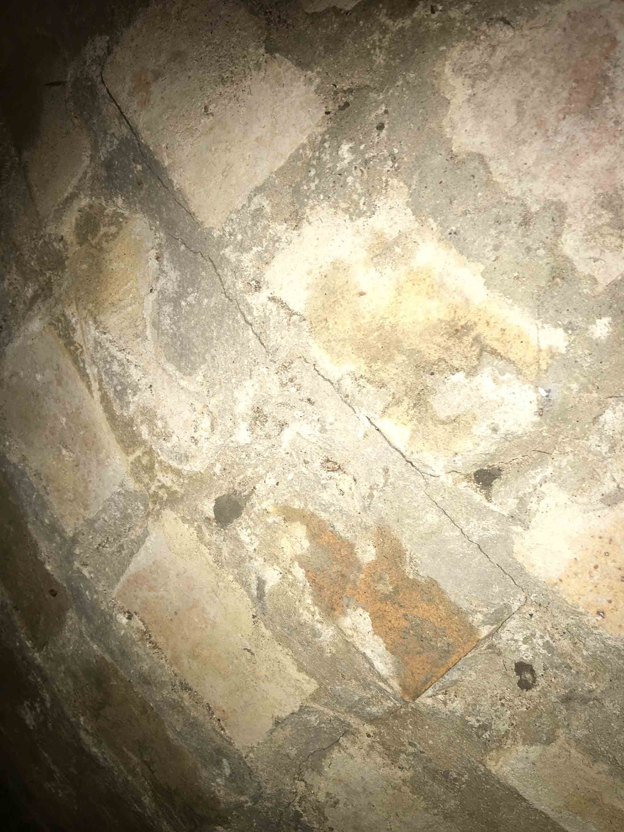

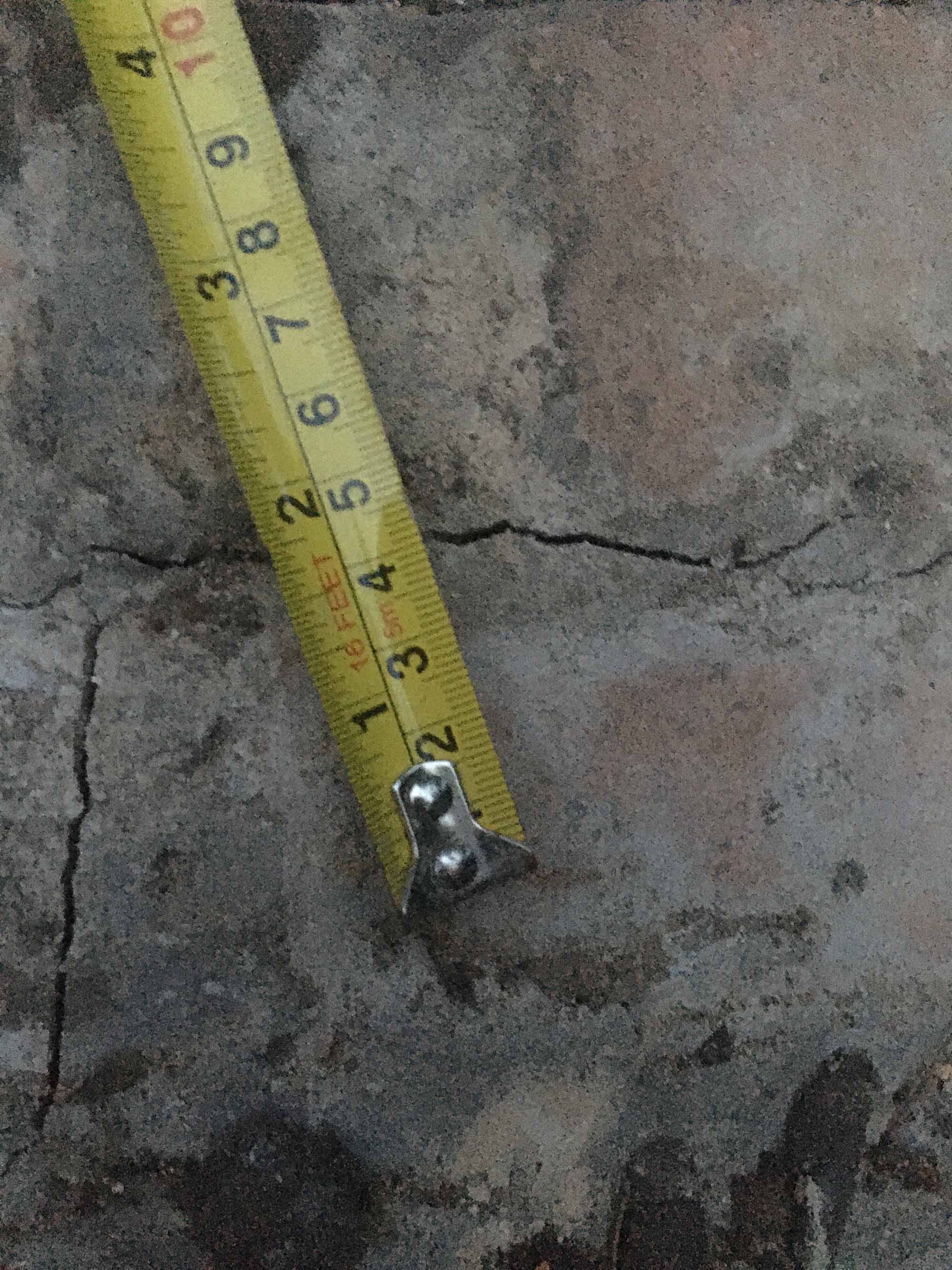

The dome is riddled with cracks, the cracks seem to run in both directions. IIt is evident the crack run vertically where the wooed structural frame were. I have counted 6 vertical cracks running along vertically and starting from the first third of the dome upwards towards the apex.
There are also horizontal cracks running in the last top quarter as a complete ring at the top of the dome!
How bad is this? Do I need to demolish it?
