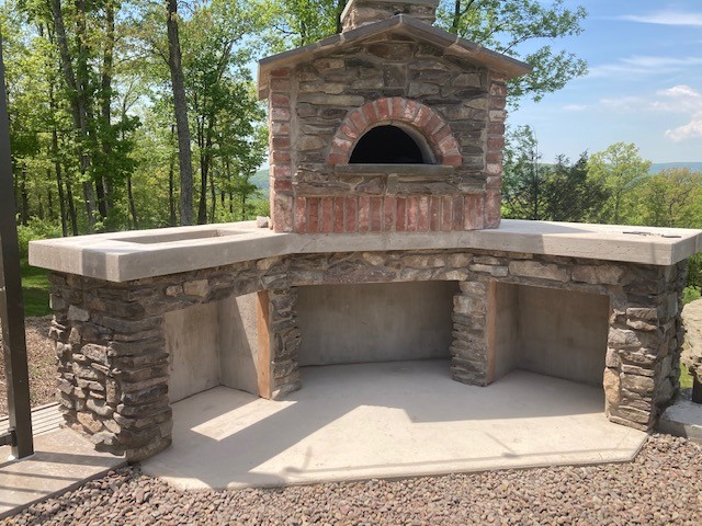

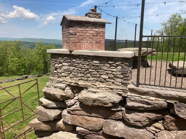

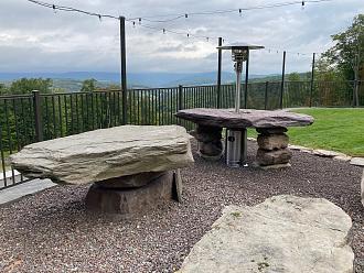

                        • Well, it’s been quite a while since I’ve updated this post, so here it is. We used the oven a dozen times(+/-) so far this year and the outdoor entraining time is coming to a close for the season. It’s been fun and quite a novelty having friends/family over for “pizza nights” and sunsets. We had several family birthday parties as well since it’s way more fun doing this than going out for dinner at some restaurant. All this and getting good enough at making pizzas that I will NEVER go and buy one ever again. It’s been a fun and informative journey down this WFO path and experience/education that I will have with me forever. Who knows, it may turn into something more later in life……
                          The oven has worked wonderfully just as built. The insulation definitely does it’s job, the damper surely helps help heat in and the door fits/works GREAT. Heat retention is incredible! The floor cleans off really well and at the end of the season with 100+ pizzas cooked, it looks almost like it did when we threw the first one in. The dome has a few small cracks which showed up early after the second or third use. Fortunately they have not become any larger, but I will certainly keep an eye on them moving forward.
                          After using the oven, the only shortcoming that I can think of is lack of counter space. “IF” I ever build another WFO, the counter space will be 6’-8’ on either side based on how we use it. One side for prep/building and the other side for wood preparation and serving. In our current set-up, we use the grey boulder table behind me to set the finished pizzas to serve everyone. Part way through the season Jennifer offered to her brother to have his 60th birthday party here. He was thrilled at the idea, and after we decided on the guest list(16-18 people), she was worried that our entertaining area wasn’t large enough. She asked if I could add another table for people to stand/drink/eat around. She also asked about some sort of outdoor heater since the evenings are getting cooler. This got me thinking, which can be very dangerous! I tend to think “outside the box”, so I had an idea. How about another boulder table with a heater? Easy, right? Off to my “stash” of rocks/boulders to see what I can find. Here is how it ended up, where it’s located and compared to what the area originally looked like. It turned out to be a very useful addition because the stone actually heats up and keeps the pizzas warm until eaten.

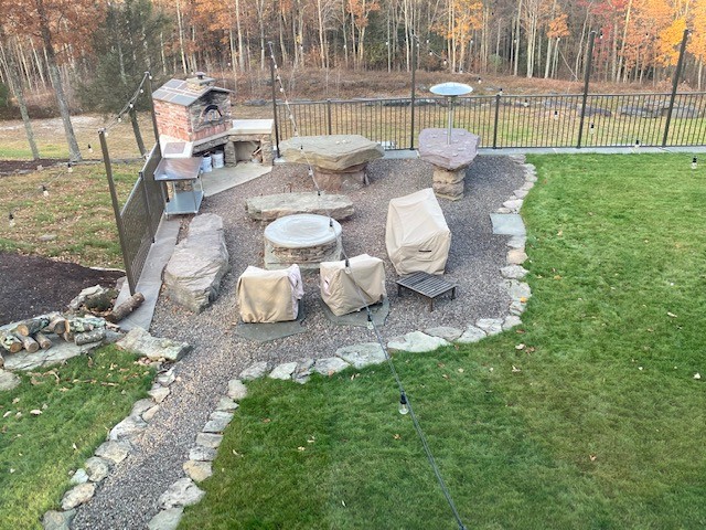

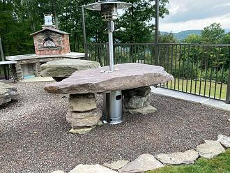

                          • The whole entertaining area in its current configuration and hopefully the way it will stay.
                            Click image for larger version  Name:	82ADAFD0-4BE3-45E9-BD51-F284D3D1B44B.jpeg Views:	4 Size:	149.2 KB ID:	443084
