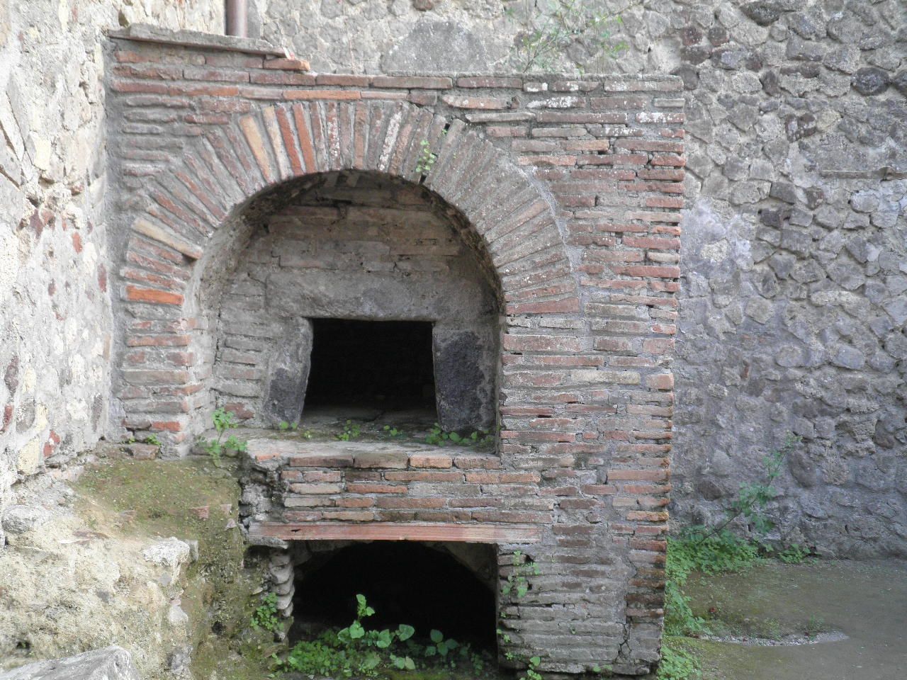

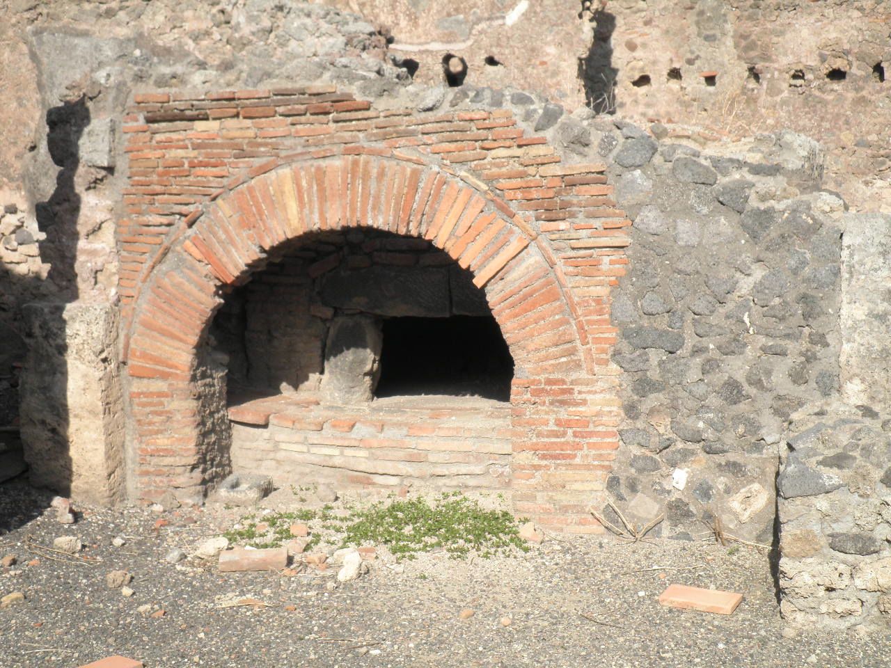

        Oscar,
        Your decorative outer arch bricks look very much the same in size, Click image for larger version
ID:	284684as those used by the Ancient Romans. Here are some pics of similar brick arches in Pompeii we visited last year. Because the bricks are thin like yours they didn't bother to taper them at all. We saw lots of these bricks used in combination with all kinds of other stone.

              #51
              Re: My 32" oven build has begun
              Thanks for the pics David, I'm glad I went with the skinny bricks. I still have some large mortar gaps but not as large as they would have been had I used standard size untapered bricks.
