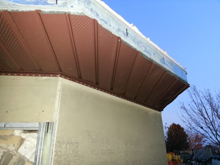

      I got the metal roofing started last month with the help from a friend who is a roofer by trade. Still need to get the coil and break to bend a custom fascia, but i no longer need to tarp this thing (minus the drop cloth i use to weatherproof where the fascia should be)! MAJOR milestone in my book.
      I've added the storm collar and caulking since these pictures were taken. Got the temporary concrete board door built as well.
      To do list:
      fascia
      decorative brick arch
      stucco
      a real door
      Sooooo close now!

                        Re: Cloita's 42" Pompeii in Plainfield, IL
                        Got the roof fascia finished a few weekends ago, still need to get up there with some caulk to seal it up proper:

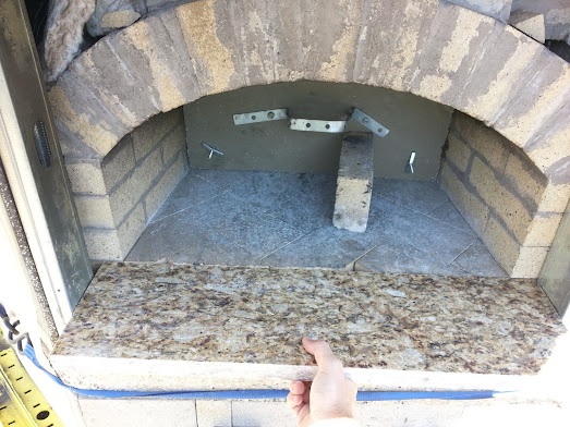

                          Started on my landing and decorative arch, got a "slight" boo-boo (beware, link is a little gory) from a falling piece of granite but I got patched up pretty painlessly. Worst part was not being able to hit the trails on my bike for 10 days!
                          I bought a slab of granite and plan to use it as the initial landing in my opening along with some brown brick to frame out the decorative arch. I'm extremely satisfied with the color matches between the brick, granite, and firebrick.
                          Mock up of the landing, need to get a brown brick picture to show the plan still:

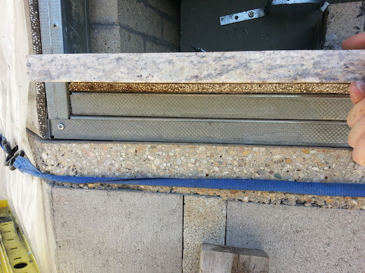

                          Stacked two studs/channels then added cement board, this plus mortar and the slab is at the exact right height:
                          I'd like to have the granite slab go from metal stud to metal stud as shown in the first picture then have the decorative brick arch rest directly on it. The question I've been unable to find an answer for is: Can I mortar brick directly to a granite surface? Do I rough up the granite surface and risk breaking the slab? Do I drop the brick down to the cement board and fit the granite slab in between the brick? I'd like to shy away from dropping the brick down to the cement board because it would help hold the granite slab in nicely. Any input would be appreciated!

                            #118
                            Maybe an adhesive?
                            - Jonathan
                            "If you don't know where you're going, you might not get there." --Yogi Berra

                                #120
                                Going with the adhesive route for the granite-to-brick bonding it looks like.
                                Got the granite slab cut and the floor squared up (my oven is about 2? off centered so the front isn't quite square). Right edge was a near perfect cut, left has a bit of a gap. Time to figure out how to route the edge and polish granite...
