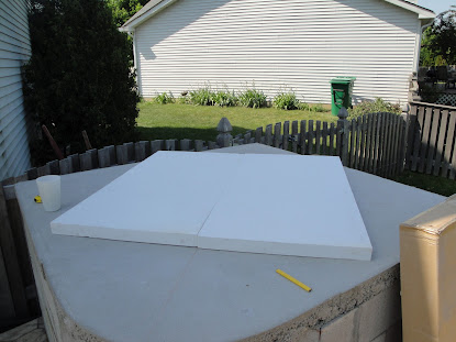

                It's about that time of the season again in the midwest. Poured my hearth, cut my fiberboard, and started dry fitting the oven floor.
