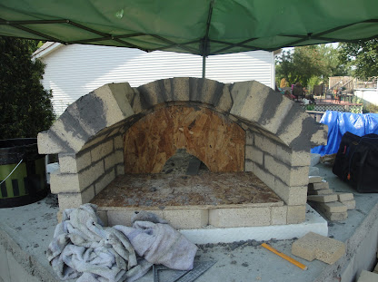

        Been a few weeks but I've been busy! July never seems to last as long as I want it to... A few days ago marked one year since starting this build. Tonight I got within four bricks of closing up the eighth course before I ran out of daylight. Things are going smoothly, just taking my time with a day or two break between courses to keep myself sane. This is the part of the build where you question how the crap you've gotten yourself into this big of a project...
        Enough rambling, here's a few pictures:
        Arch progress:
        Sixth course (first full circle after arch tie-in):

          Seventh course:
          Eighth course almost done:

            You are putting right along. Going to pass me up soon. Do you think you need to buttress your arch?

                Russell - hadn't thought about it, the design I'm following never mentioned need but I'll have to mull it over and see if I need it and if it will fit in my hearth.
